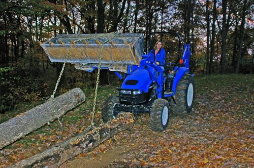

A little pic of the wife doing some housework.
