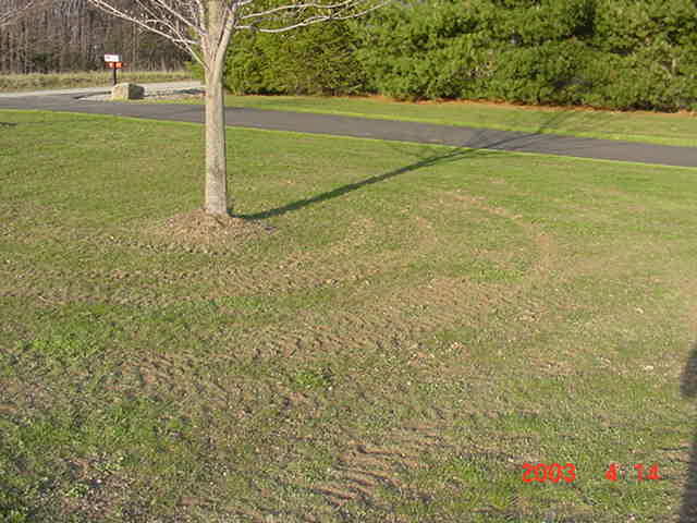

3rd picture..........I tried lower air pressure and wide sweeping turns but the bite is still there. If you live within 200 miles of me and want R-4s I'll trade for turfs.......My tires have 4 hours on them.......TOM

Looks like you have some exceptionally soft ground (compared to what I'm accustomed to anyway). I never left anything close to that much track even mowing with ag tires.
   / TC 33D Turf tires #23
I don't get ruts near that bad. With my TC29D I do have to make sure it is dry when mowing. But my big problem is more to a new yard. No root growth yet. My neighbor has a JD 955 which I would think weighs about the same as my 29 and he has turf tires and he will leave ruts in my lawn also. I am thinking more and more the weight of the tractor is key. Not so much the tire.
My dad has a 1957 Ford 861 that weighs a lot more than my 29 with regular tractor tires and he leaves no marks in his lawn, but it is well established.
murph
   / TC 33D Turf tires #24
Well.. looks like you have a mess for sure... let me say My brother in-law has R-4s and they don't do that bad on the Ohio Clay he has... maybe your soil just needs to dry up... ALTHOUGH.... I must say I have like my brother in-law and you a TC33D with TURF and they are much nicer on the lawn. I don't dig up as much as his does on sharp turns.. WE both have SS on the tractors....

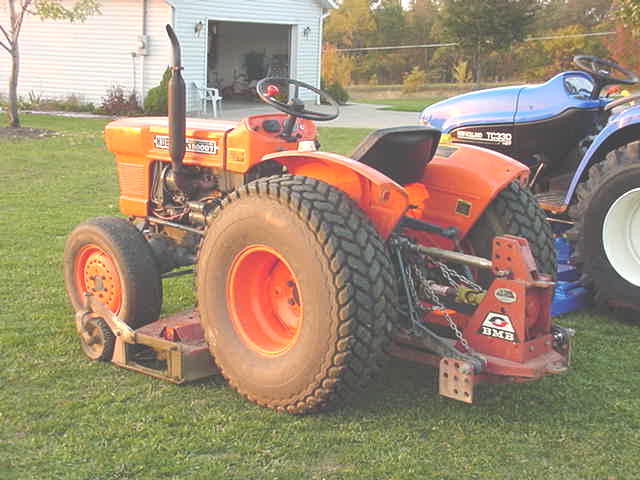

Murph.....I even get ruts on my high ground.........Yard's been in for 10 years............Kubota made lite tire marks in the spring but never like this.........If I wait till everything's completely dry I'll have to use the brush hog !! .......Tom.........See farewell picture of Kubota next to TC 33.........See tire difference.......

Before I'd spend $$$ on turf tires I would want to confirm that turfs would not leave marks, too. While the tractor's weight will be spread out over a larger surface area with turfs, given how soft your ground appears, you may not be any happier with them. /forums/images/graemlins/frown.gif
This is one of the reason I kept my Wheel Horse Garden Tractor, i.e., mowing when the ground is too soft for my TC25D. It's also why I have been questioning myself as to why I bought a MMM in the first place! /forums/images/graemlins/confused.gif

Ohiobeefarmer,
It is interesting for you to say that your turfs don't do as much damage as the R4's on turns. When I was searching for a tractor my dealer talked me into the R4's. I told him my concerns with my lawn and he told me to come outside. He told me that turf's are better for a lawn overall but not on turns. He took one of his TC18D with turf's and a TC24D with R4's which I ended up buying. But he took both tractors out on the yard and made really sharp turns with both of them. I didn't believe it. The turfs' ripped the grass up much more than the R4's. If I didn't see it I wouldn't have believed it. I then got confused and went out on the web and found a page that explained the exact same thing. That is when I decided the R4's would be best for me. I really wished I could find that web page again so I could post it here. My neighbors John Deere 955 with turfs will also leave dents in my yard. I am thinking my problem is the fact that I don't have good root growth yet and hopefully aerating will help develope that.
But I do have to admit that I wished I did have the turf's for mowing, but for brush hoggin on my hills using my neighbors tractor the first year I just slipped around too much with the turfs. Even ifn 4 wheel. The R4's made a major difference. In fact I don't even need to put it in 4 wheel.
murph
   / TC 33D Turf tires #29
Shoppin,
I guess I see I got a typo. That comparison was with an 18 and a 21.
I did actually buy a 21 first. Got it home, used it for about a year and after just about tipping it over a couple of times I took it back in and got a TC29D. With my hills I just wanted something more stable. I felt way too uncomfortable with the 21
murph
   / TC 33D Turf tires #30
How about just putting turfs on the front? Especially since they mount on the same rims as the R4's! (unlike the rears).
I tried without success to find someone to trade their turfs for my R4's. Now I think I'll try the turfs on the front, since that's the only problem I get.
