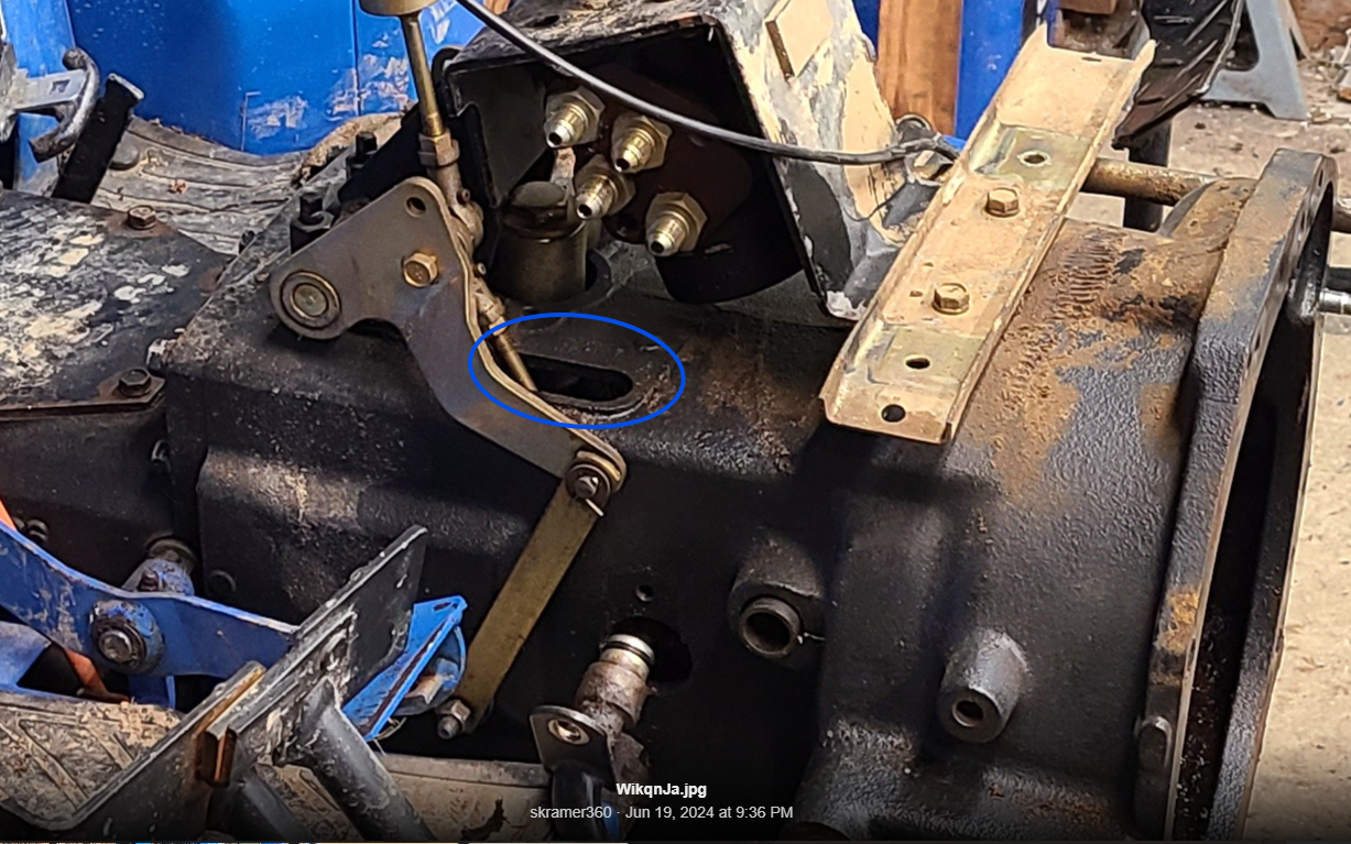

The plot thickens. Finally was able to reach the dealer (I had been to this one before). Talked to their service manager. He was pretty familiar with the problem. Believes it is the seal on the input shaft to the HST pump. Without prompting he told me that what happens on these machines is that the "dry space" where the pump is gets sometimes filled with grit grime etc. because there is a golf ball size "inspection" hole at the top of that casting. Worse yet, he said that rodents sometimes get in this space and fill it with more debris. This gets onto the input shaft and works its way into the seal, and destroys it.
It was then that I told him that I had been pulling sludge and acorns out of an access point that was created by my removing one of the hard lines that goes into this housing. What a stupid design (new Holland) that allows this to happen. Sure have a vent/inspection hole on top of the casting, but have a damn screen over it to prevent this!!
Anyways, If it is just the seal, the approximate cost for the whole job is 2 to 2.5 k. Mostly all labor to get to everything (splitting the tractor and putting it back together.. I was expecting this (actually was expecting a good bit more). They could schedule the job at end of June. I was going to do it myself, Now I am back on the fence...

Are you able to see the "inspection hole" that the mice were able to get through? Any pictures?
   / TC 33D Hyd leak from weep hole #17
No you can't see it because it is below all the plastics "body". It would be pretty much directly below the steering wheel area. Gone are the days when the "body panels" of tractors were pretty non existent. Will only really see this area when the tractor is split and you can clearly see the top of that transmission housing. The engineers should have put an inspection/cleanout plate on the bottom of the housing where you could just remove it and clean the space out thoroughly. I'll certainly get pictures if I do the work myself, or maybe get some when it's at the dealer. skramer360 has some great pictures in his thread on this topic, where he split the tractor and you can see all the housings and cases

I wonder if this is the area?
