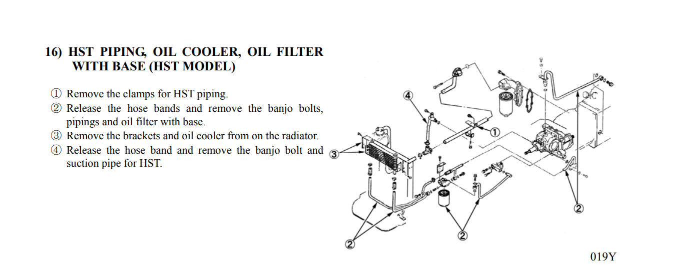

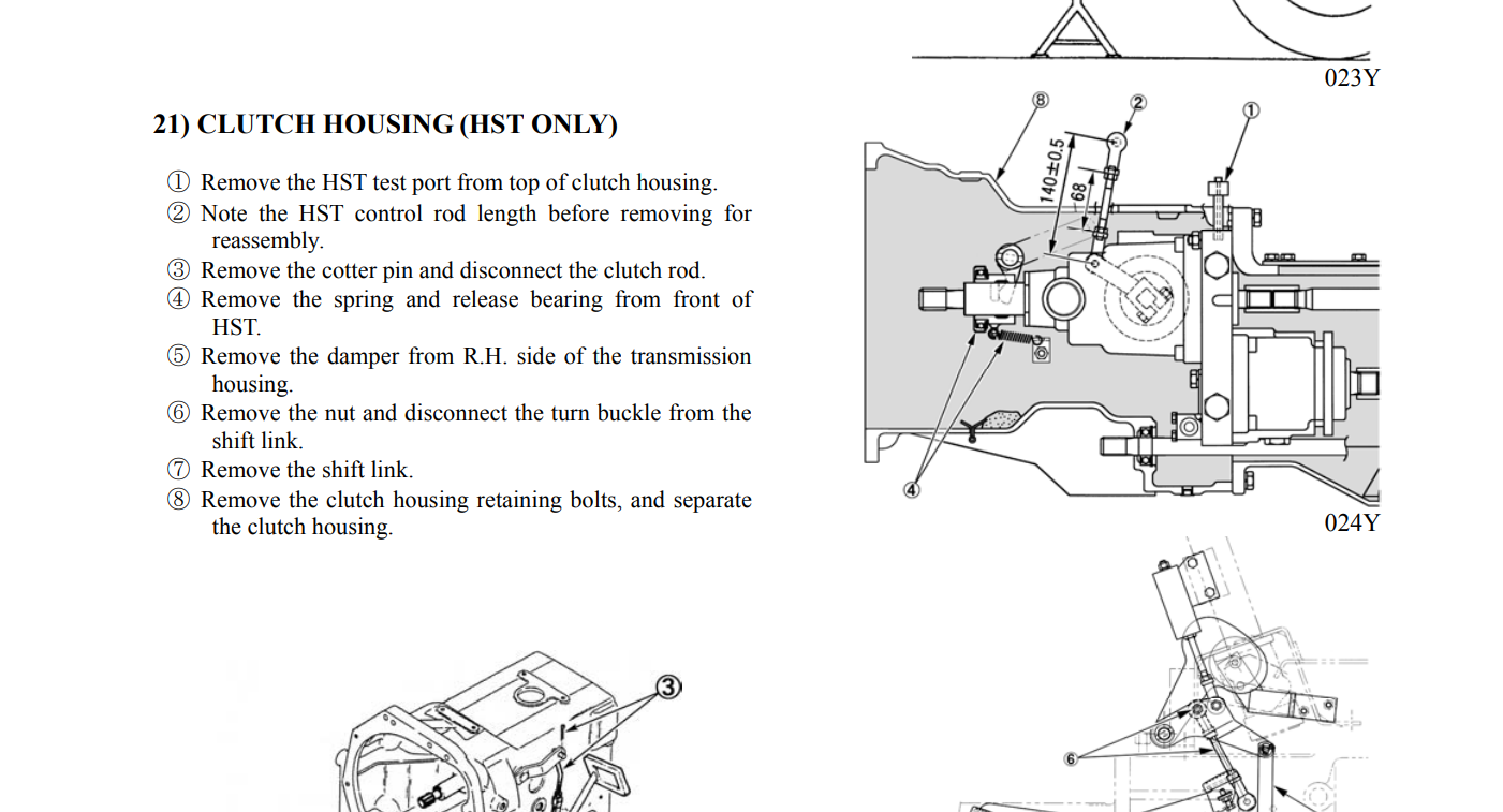

Here are some clips from the Shibaura ST333 manual. I believe all these tractors are similar.
