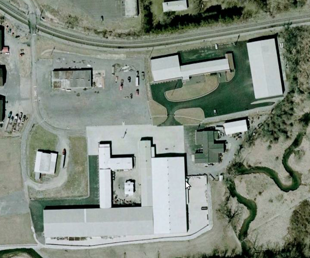

You wanted a picture of the Power Trac showroom. You got one.
You didn't specify ground level, now did you? Besides, I gave you a bonus. I threw the PT factory in for free.
SnowRidge I swear your turning into MossRoad :rolleyes:
