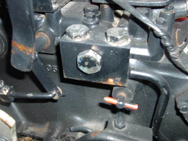

Under my seat is this block...... marked "in" and "out". Would this be a suitable place to tap into my hydraulics for rear remotes. I'm dreaming about a hydraulic top link, and perhaps hydraulic controls for the chute on my rear blower.

I do not know how good your manuals are (or if you even have them), but
you will most likely need a hydraulic diversion plug if you use those ports.
Does you tractor have a loader valve? Your photo does not look like the
Yanmar (JD) tractors I have added remote hydraulics to.
/ Tapping into my hydraulics
Unfortunately, i do not have a service manual for my tractor.... though i should get one. The plugged ports under my seat are in the block where the pressure line goes into the rear of the tractor to power up the TPH. I don't think it would be a huge issue if using this port to power rear remotes would only allow me to use one valve (or the TPH) at a time...... as i don't forsee me wrestling two or more levers on the rear at a time. I was hoping someone here had used these, and could tell me if this would be an acceptable way to get hydraulics to the rear.

Excellent picture! This is exactly what you need, Ductape. Note the
socket head diverter plug you need. In my JD hydraulic conversions,
this was the only part I needed to buy from JD, due to the strange
thread and length. All the other fittings are std ORBs, as stated. I noted
two other interesting items from the manual page. The 3-pt is downstream
of the hyd access ports, which requires the use of an aux valve with
power beyond. If the 3ph is upstream of the access ports in this
open-center system, then you can use a simpler valve with no PWB port.
Second, the manual warns of breaking the hyd pump if you block the
circuit thru the valve. This implies that there is no system relief valve. That
is a scary thought. Hard to imagine that Yanmar does not have a RV
in the circuit.
Anyway, great documentation! I wish I had similar for my Kubs, JDs, and
Kiotis.....
