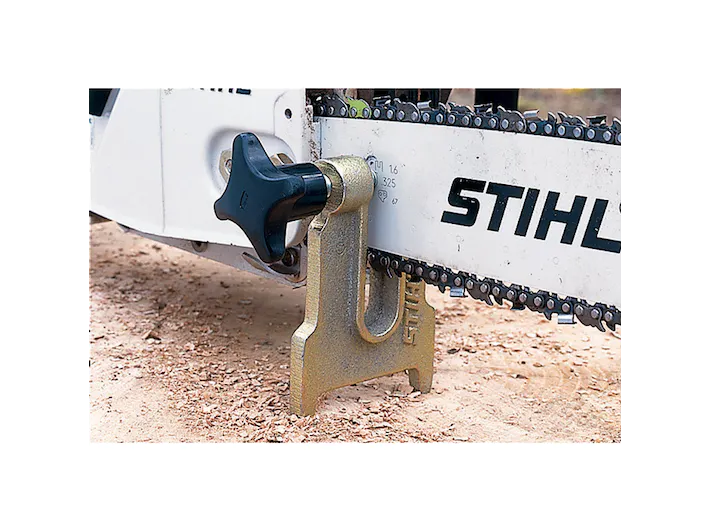

After a year, I made the mistake of using a 2:1 file on it though vs hand file. It took the rakers down to the point where I set the chain aside and bought a new one.
"Rakers" (really, "depth gauges") should be kept around .026" below teeth on most 3/8" full-chisel chains (eg. Stihl RS or RS3). If you're doing a scant touch-up with a round file between each tank of gas, you might go 3 or more sharpenings between having to lower the depth gauges. If you rock the chain, or prefer using an electric grinder, it's more likely they'll require a pass or three with a good sharp flat file on every sharpening, to keep them at the proper height for fast cutting.
On all but my top-handle saw, I actually take my depth gauges down at least 20% farther than the factory grind, aiming generally .031" to .033" on RS chain, for faster cutting. But it takes more horsepower to turn the more aggressive grind, on the same bar length, and they can be more grabby in smaller branchwood. More reasons to favor bigger motors on shorter bars.

Did you use it on a full skip chain? 2 in 1 isn't compatible with full skip chains because it has to guide height off the second tooth.
I think the problem was that I was used to using a 2in1 on the the .325 chain for the ms260, and that using the 2in1 for .375 chain, and thinking it was a bigger chain, I pushed down a little too hard and took the depth gauges down an extra .04 When the 462 was new, the depth/power ratio was perfect, with no grabbing, just a nice smooth high speed high power cut. Taking the depth gauges down that extra amount almost disabled the saw completely. Filing the cutting teeth to almost nubs would bring the depth back in line, but I wasn't in the mood for that. Maybe the 2in1 would work better with a light back and forth touch, and not pressing down at all, but then again the depth doesn't really need adjusting every time anyway. I never seemed to have a problem with the .325 chain. I want to get one of those progressive plates, something like Carlton makes, but haven't gotten to it yet. The 462 really does cut nice just the way it is, with just a light touch up on the "rakers" once in a while. I've been out almost everyday for 3wks now, felling and cutting all of these white oaks here that are dead from oak wilt. I counted 8 that were 175yrs old, and another 10 at 120-150yrs old. The gypsy moths just arrived this year now too, so it's starting to look like a war zone. In that time I haven't touched the depth gauges, just the cutters, and to me it cuts like a beast so I'm hesitating messing with it.

I also think maybe you were using too much force. The Stihl 2 in 1 controls the amount taken off the depth gages to keep it consistant but too much pressure can bend the gauge rods and take too much off with the files.

Hey BnRidge, it sounds like you know what you're doing. If you're sharpening enough to keep in practice, why not just learn to freehand sharpen, without the 2-in-1? Short of hitting a rock, where hand sharpening is just going to take too long to bring it back, it's a preferred method by many pros and frequent cutters.
If I weren't always so pressed for free daylight hours, I'd probably be freehand sharpening in the field myself. But as life is now, free hours after dark are infinitely more abundant, and so I use a chain grinder in my shop at night.

I find the 2-in-1 to work great with .325 and can sharpen a chain much faster than I would by hand.
   / Talk Me In/Out of the Stihl MS261 #56
Never used it, since I learned to sharpen before it was invented. What do you think BnRidge did wrong with his?
Hand file like Buckin Billy Ray. I do that too. I timed it once - 4min to put it in a vise and file "till it's sharp", usually only a couple strokes, and 4min to fuel and oil. A sharp saw really pulls out the chips. The 2:1 does seem to help get the hook angle right, the vertical angle of the tooth tip, if I remember not to push down on it. Hand filing I found I was loosing the right angle, couldn't seem to get it back, and needed some kind of guide to get the file up where it belonged. Once dialed in, then I'm good again.

If you're hand filing, I'm told a stump vise is a must-have tool. I hang out with a few pros who only freehand sharpen, and they razz me for using a grinder, but we all have to find what works best for us. As long as your saw is sharp, and the angles and depth gauges are right, that's all that matters.

I always laugh at the guys that act like they are all that is man because they can hand sharpen like its some divine skill that will get them into heaven or something. Lol Most of the guys I know that brag about it are throwing dust while my saw is making chips. I was a Tool and Die maker and CNC machinist for 20+ years, I can use a file better than most but hand filing is inefficient and without a depth guide we are just guessing at the depth gauges. The 2 in 1 kit is great for out in the woods or in the garage, is faster and more consistent than separate hand files and less things rolling around my field kit. Also not a damn thing wrong with using a grinder. As you said, to each their own.
