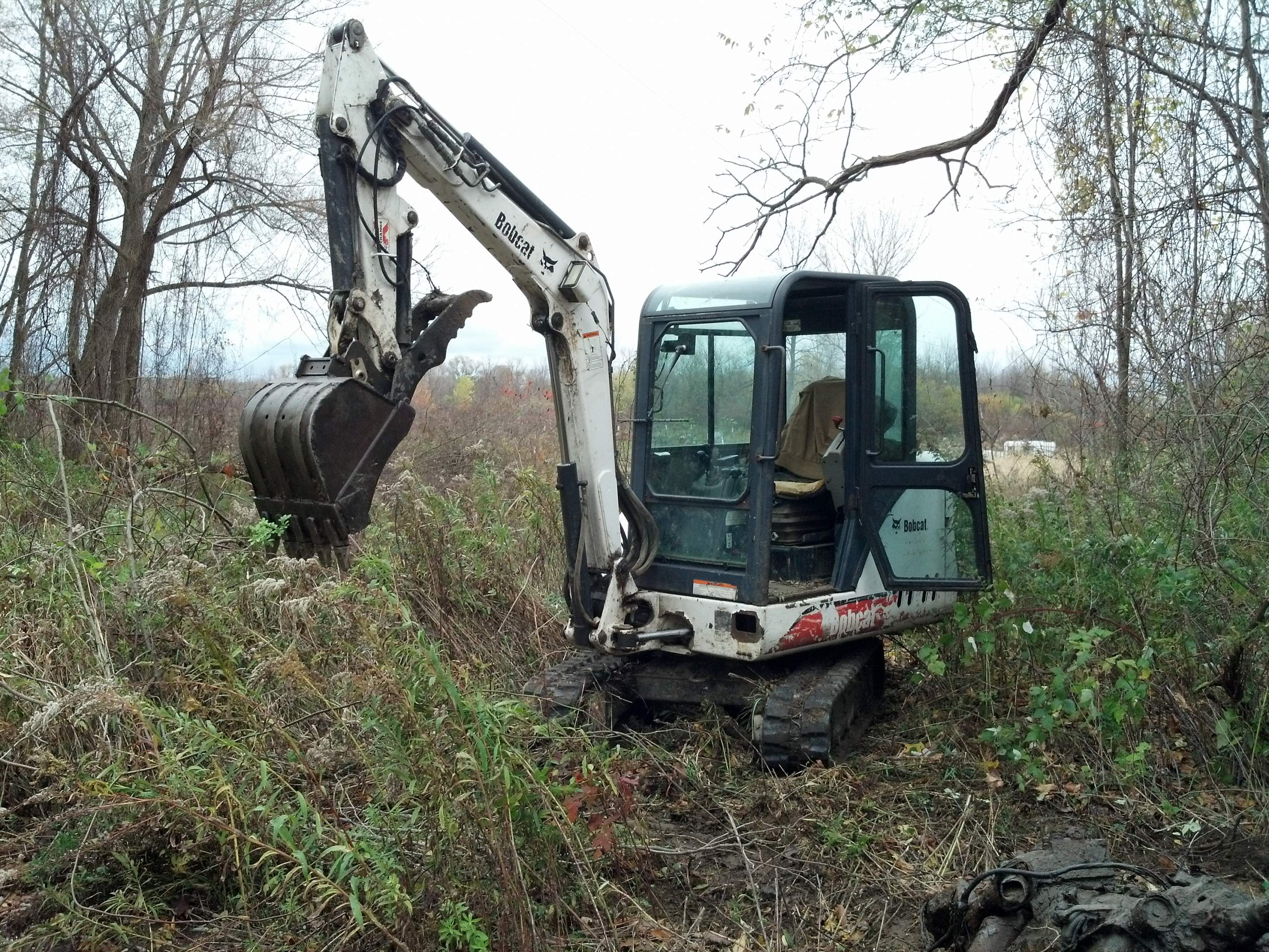

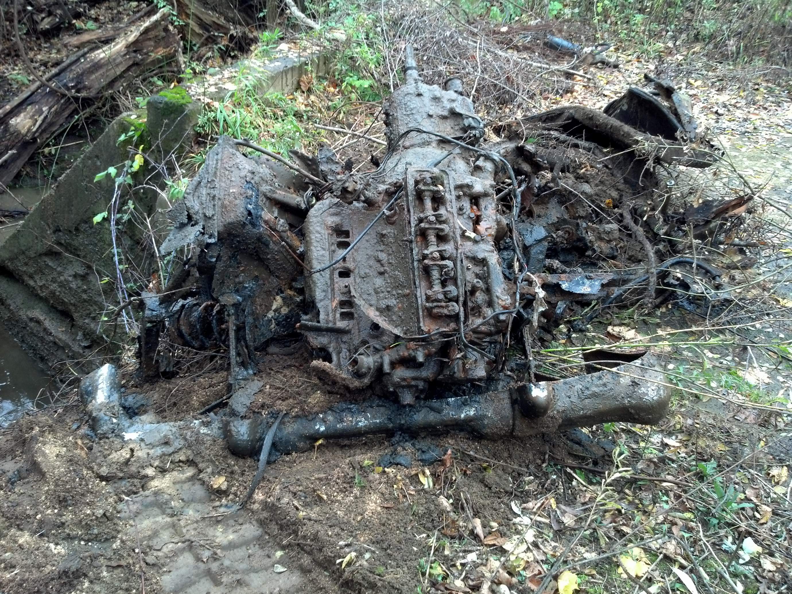

Here is mine after fishing the front end of an old AMC out of one of our creeks.

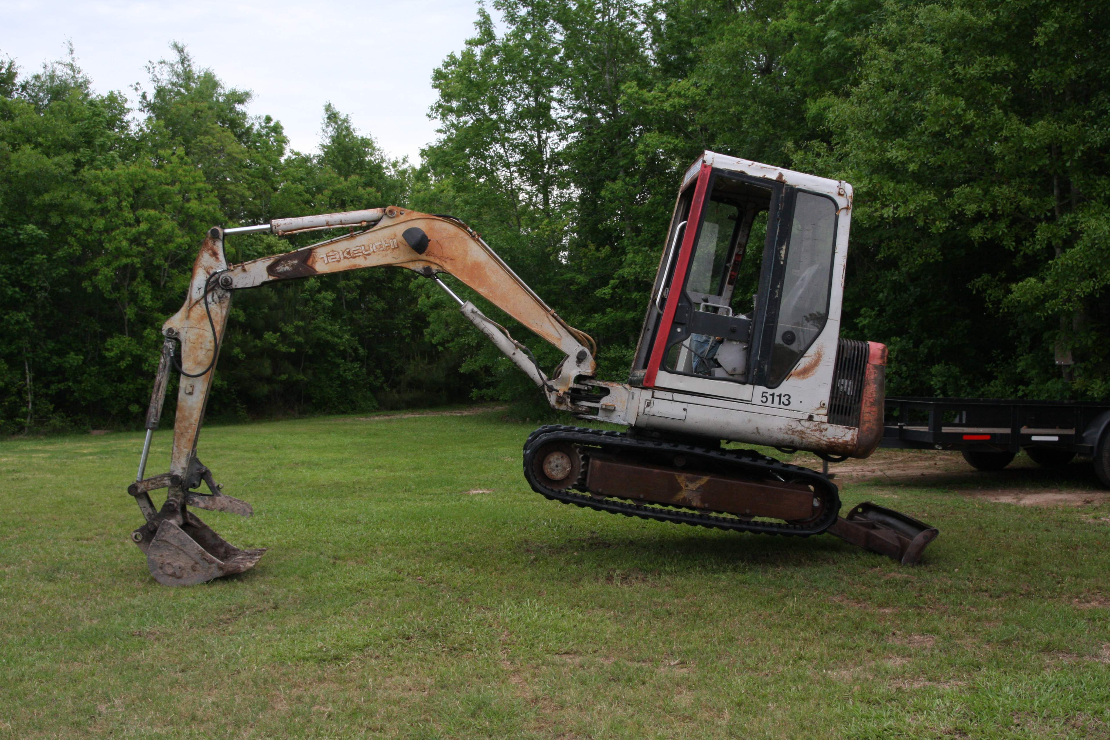

Engine starts right up. It needs a throttle cable. The bucket cylinder is blown and all the other cylinders have rust on the shafts. The aux hydraulic connections are a mess as you may be able to see in the pic. Both sides are twisted up with the brackets broken off and bolts sheared. The bucket pins are really worn and sloppy. Couple of broken drive links on both tracks. Haven't opened up the primary drives yet. Sprockets are worn but have lots of life left. Water in the fuel and hydraulic fluid. Exhaust is rusted away. Seat is rotted away.
You are right about just a little TLC. In a couple of weeks I'll be diggin away!
I'm looking forward to tinkering on it and bringing it back to life.
Thanks for the comments.
