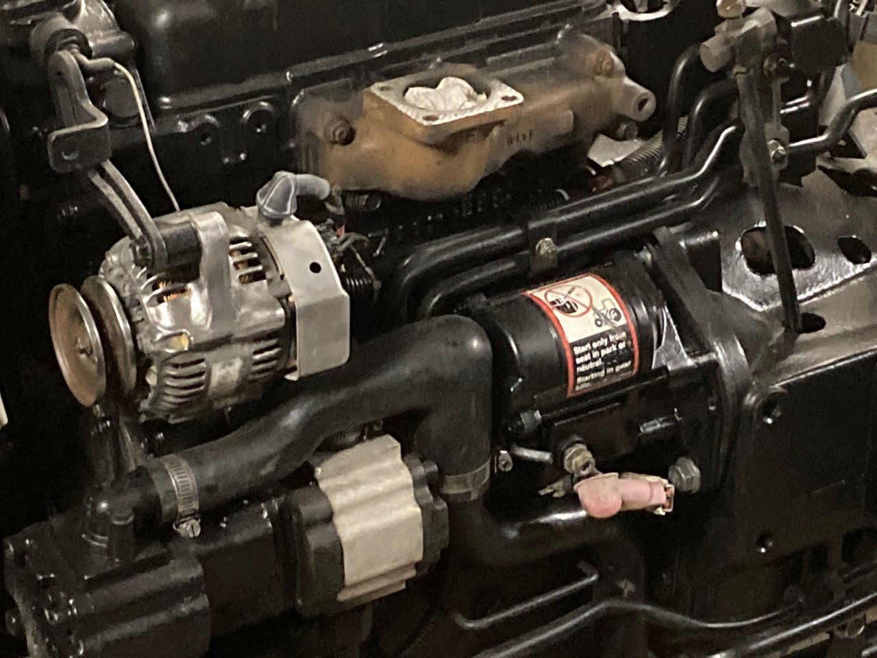

Am in the process of restoring a 1998 JD 4400 Tractor with around 50 total hours on it from new. I have about 3 hours run time on it myself.
The tachometer worked fine and just quit all of a sudden. The hour meter works fine.
ALL of the factory safety's are functional. This is a pre computer machine.
I believe that the tach works off of a pulse from the alternator. A Trusted auto electric motor friend
tested and said the alternator is just fine. I even tried with a second used alternator.
I have traced all of the wiring and it also seems fine.
ALL of the relays have been switched around with extra's and have no effect on system.
I am clueless here. Any Ideas appreciated.

If there is no mechanical cable driving the tach it probably does feed off the alternator - counts pulses or something - not sure. Are your hour meter and tachometer both in the same unit or are they two separate instruments? That can work both ways. Unless it's a broken wire somewhere, unless you are familiar with working on instrumentation you should send the unit out for repair.

A signal generator could be used to make the pulses.
   / Tachometer Quit working JD 4400 tractor
I have no knowledge of a signal generator. will research it.
I believe there is a pole on the alterntor that supplies that pulse.
How would one test that?
