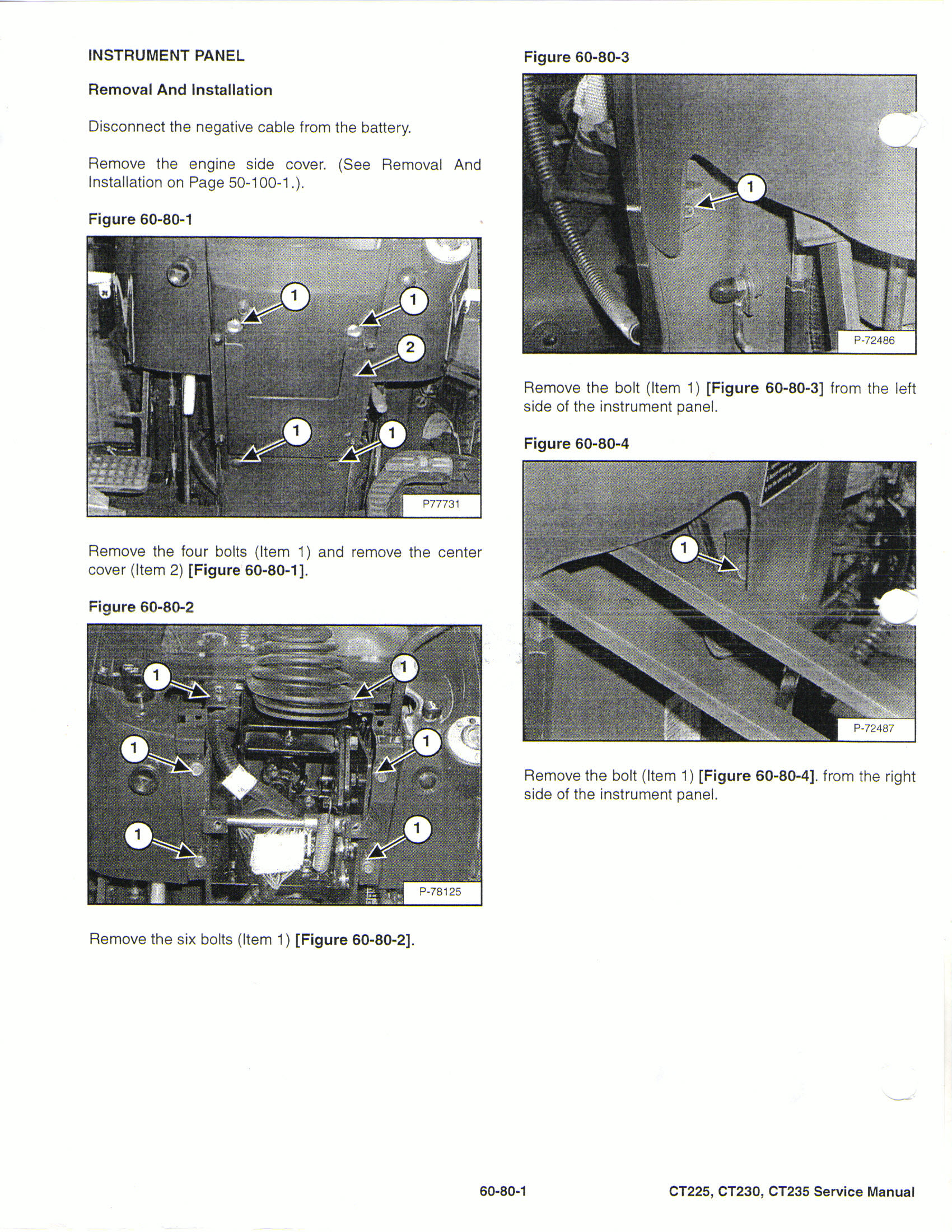

Hope this can help you.

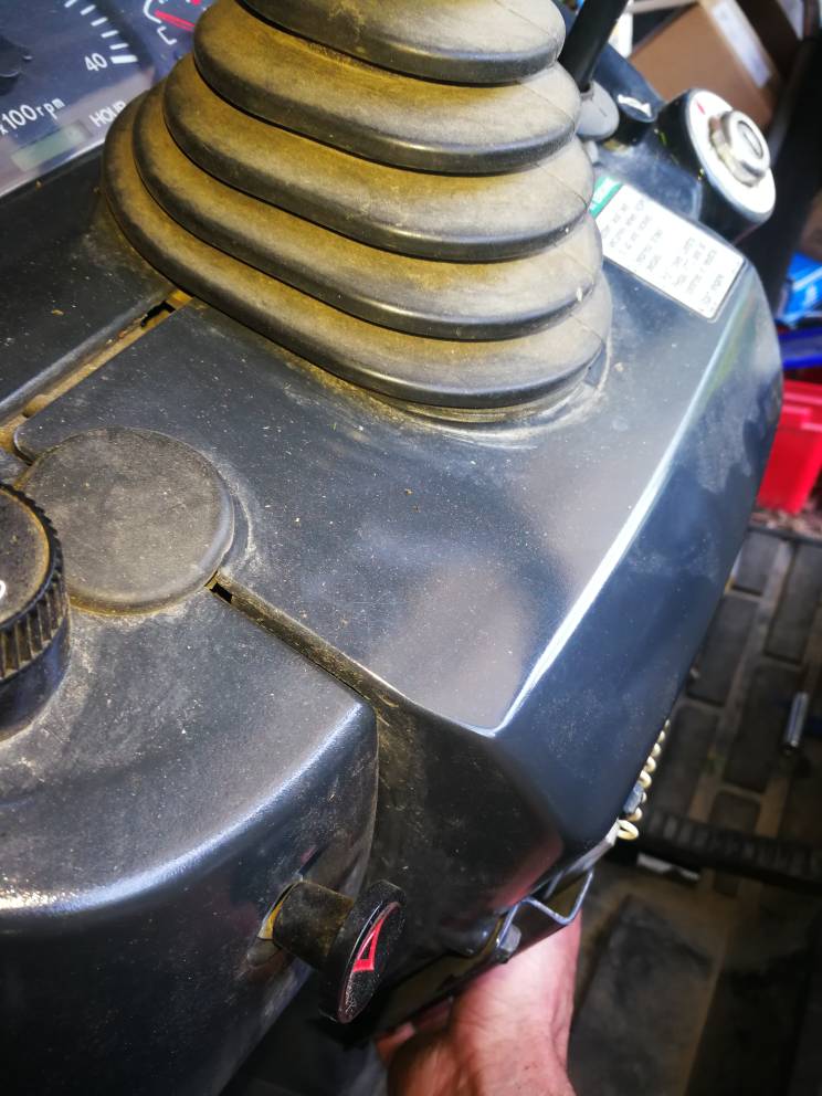

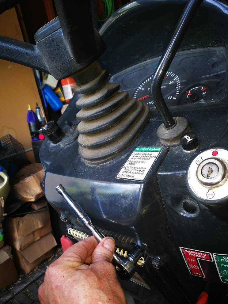

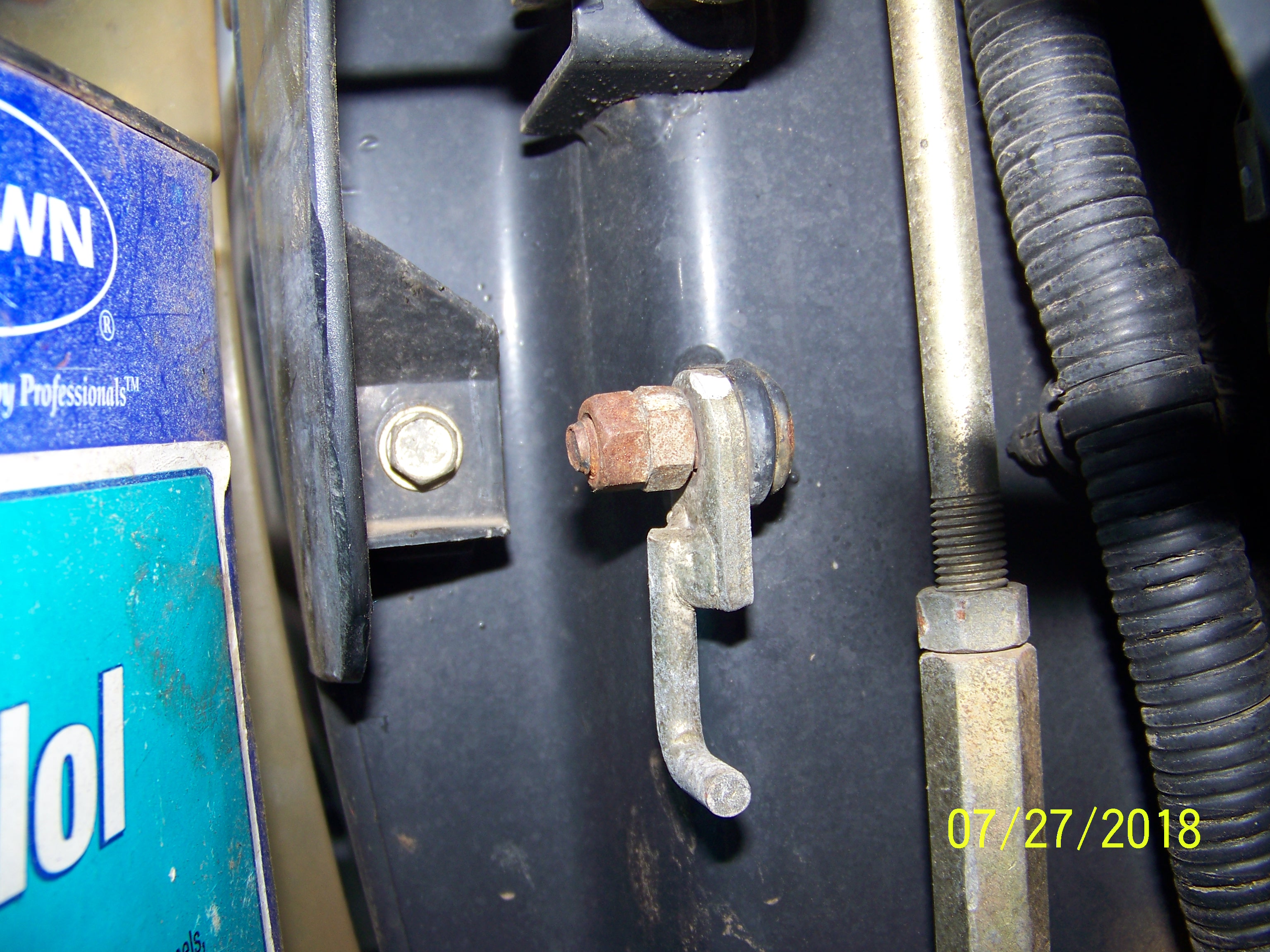

   / Tach/Electrical Issue #82

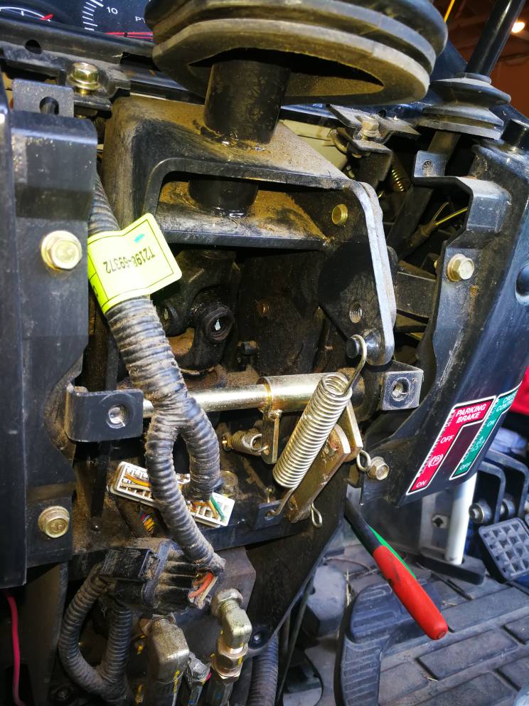

Ok, so the lower dash panel comes off via four 10mm bolts. You'll have to remove the rubber grommets, both the blank and the one around the throttle and the steering assembly boot will fight with you, too.
From here you access the six 10mm bolts that secure the upper dash assembly, along with the two 10mm on either side at the bottom and plainly visible.

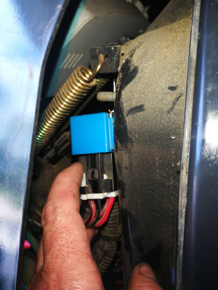

The relay is visible as soon as the shroud is pulled back beneath the springs for the brake.
I took the 20/30A and replaced it with a 30/40A to test. All worked. Gauges, lights, dash. I put the original back and, oddly, it worked again. Nonetheless, and only having the 30/40A on hand, I've used it as a replacement.
Make note that two of the bolts are shorter than the others and admittedly I lost track of where they came from. Nonetheless, it all went back together ok.

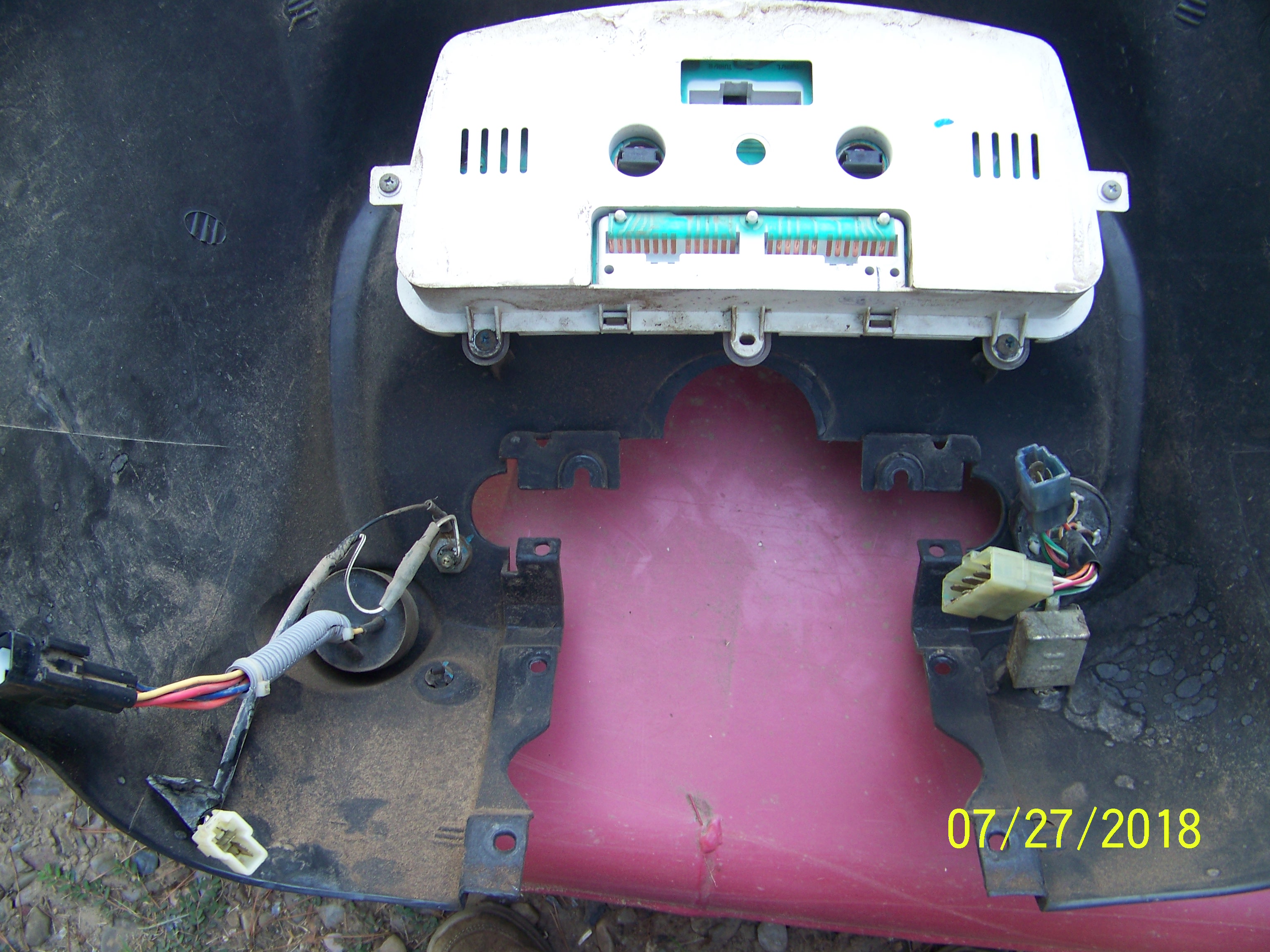

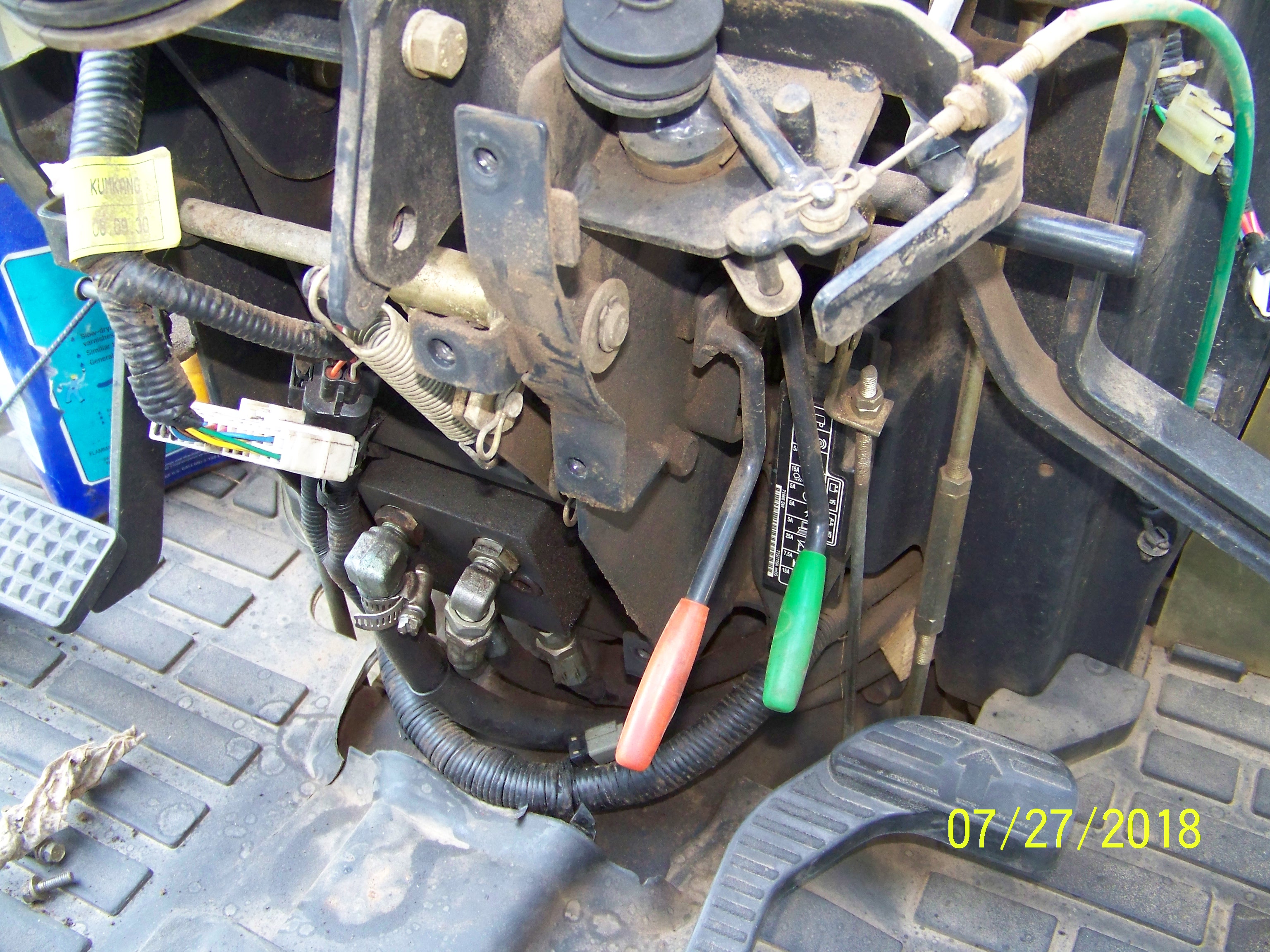

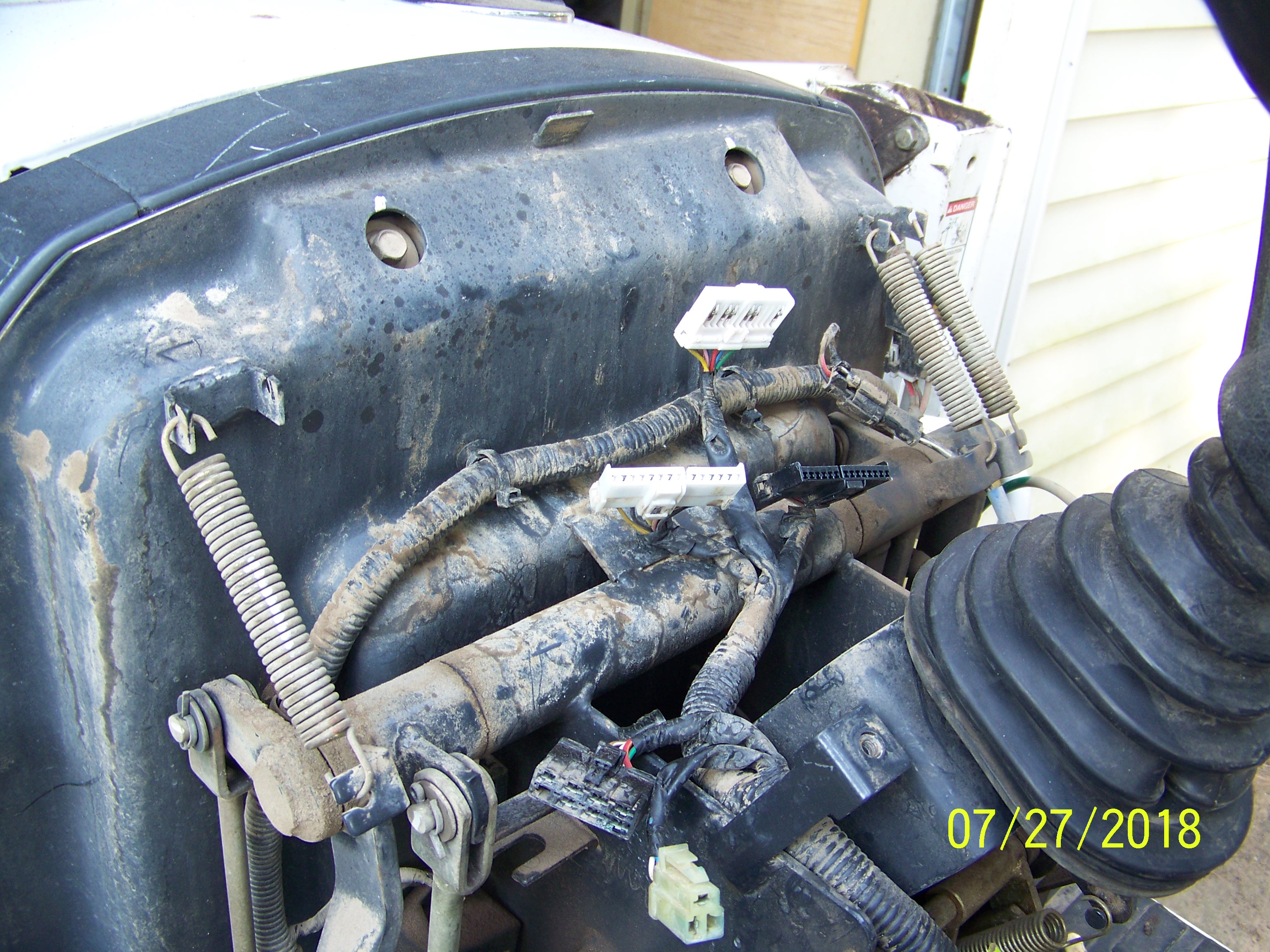

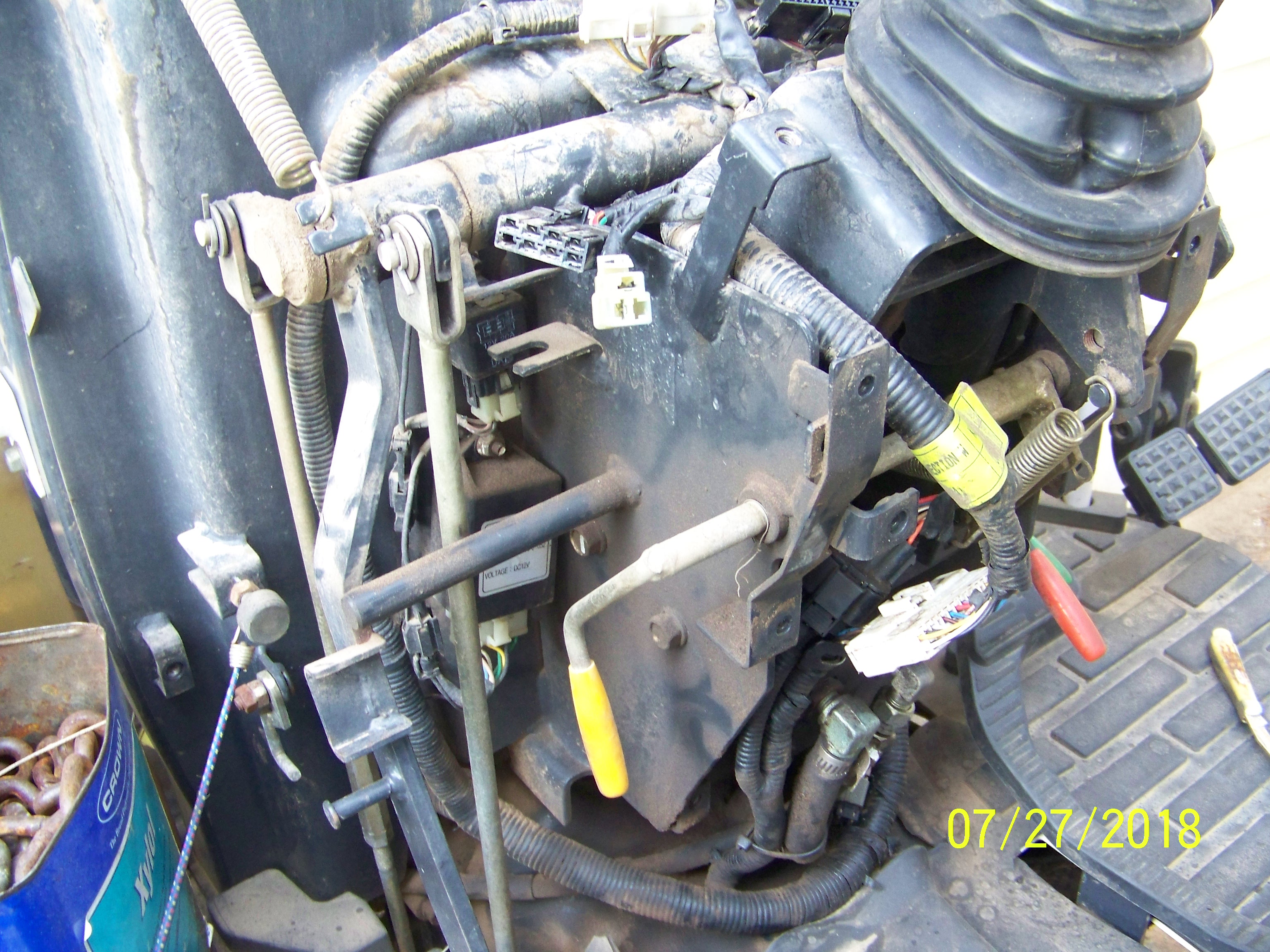

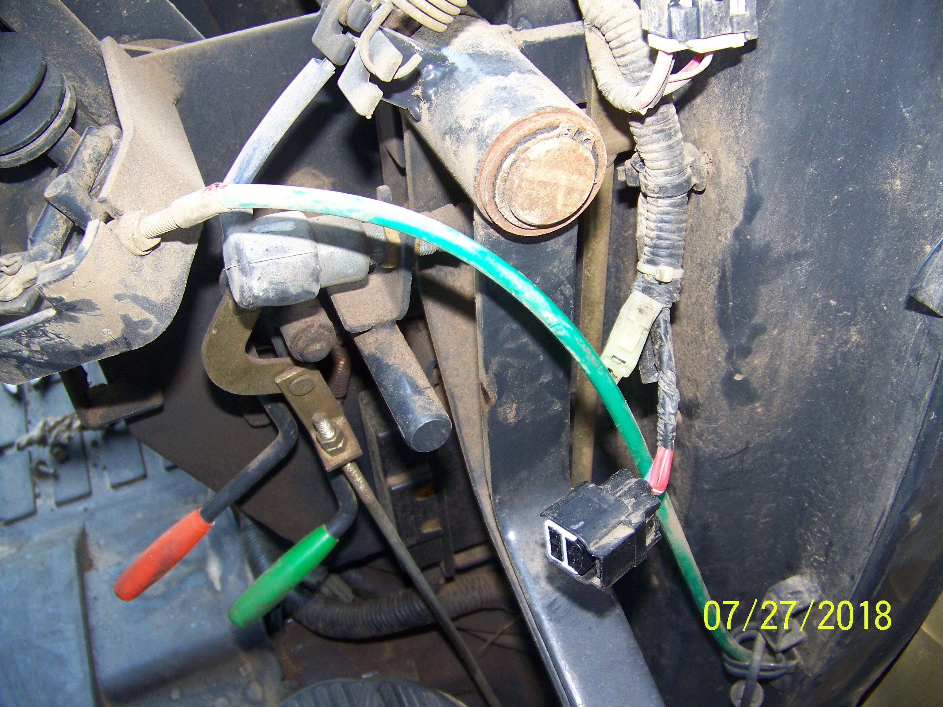

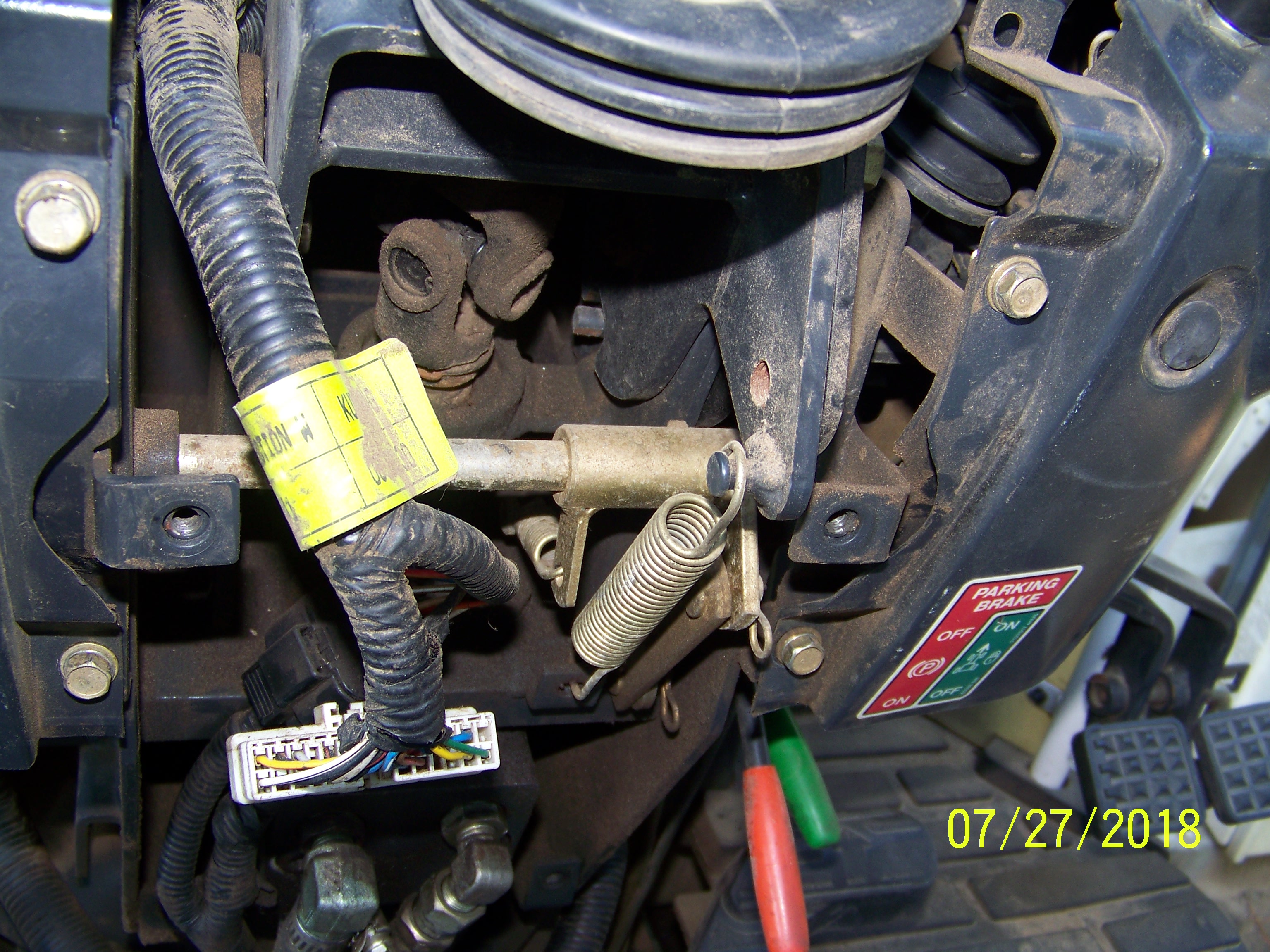

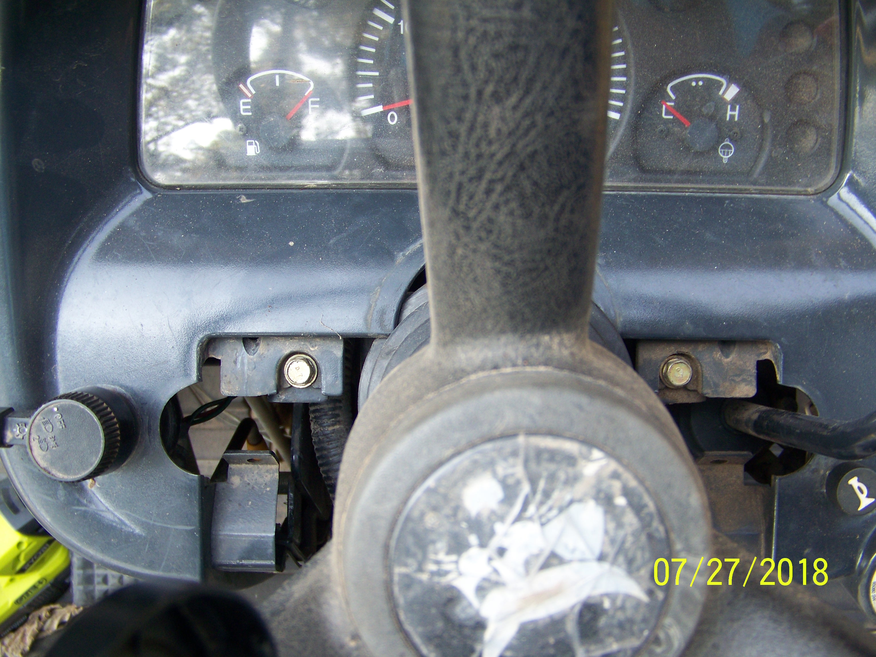

I decided to pull my dash cover back off in hopes this connector TCARTWRI spoke of might be the problem with my temperature gauge maxing out when I turn my lights on and no dash lights. A failure on my attempt. There are 7 connectors to unplug in order to remove the dash cover. I sprayed all seven with contact cleaner. A visual inspection indicated no problems. Oh well. :confused3: I did take some pictures thinking it might help someone down the road. 4 bolts removes the little center cover. 8 bolts to remove the dash holder or cover. All are 10mm socket size. The 7 connectors must be unplugged before completely removing the cover.

   / Tach/Electrical Issue #89
This may be a redundant question, but have you removed and cleaned all ground connections. This should include the primary one from the battery to the frame. Also trace the temp gauge wire back - could be a gap in the insulation somewhere.
Hope this helps
   / Tach/Electrical Issue #90
Temperature gauge seems to work normal. when I unplug it from the sender it dies, normally runs 1st mark from start. Turn lights on bright or dim and it pegs out. I unplugged lights and it still does the same. I haven't cleaned grounds in a while but I have since this problem begin. Blinkers, hazards, brake light, work light all work and temp gauge works normal with all them. Headlights is the only thing that affects it so there has to be something common between them.
