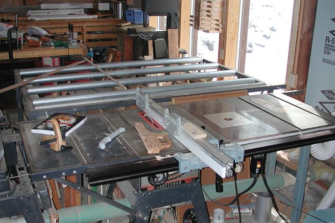

I like having a rounter next to my table saw blade, in a home made extension to the right. My saw is an old Craftsman 10" contractor's saw, that I added a unifence to and also a second cast iron table (that someone gave me) on the outside of the router area.
The router is mounted to one of several 1/8 inch aluminum plates I turned into bases. Each has a different hole to accomodate different sized bits, up to large raised panel bits.
I routed out a 1/8 area in a piece of micarta I had, that the aluminum base plates drop into. They are held in place by flat head screws countersunk into the aluminum, which thread into tee nuts inserted in the bottom of the micarta piece.
I use a small fence that I clamp to the unifence, and hook my shop vac system to it when routing to collect some of the chips produced.
What I have is similar to what you want to do. Keep in mind that if you want to use a large router bit you will need a large hole in the table extension.
Attached is a picture of what my setup looks like. I really like having the router there...I have a second smaller one to use so I don't have to always take the one in the saw table out and put it back, if I want to do some routing elsewhere. I also made a little set up that allows me to use my electric screw driver to turn the height adjustment knob of the router. Works well and makes me feel high tech... /forums/images/graemlins/blush.gif

Nice setup Henro. /forums/images/graemlins/grin.gif
Egon
   / Table saw / router table combination question #13
That looks great. Nice outfeed table. How about some close-ups of the height adjustment stuff? What's even more surprising, not one Kubota orange item to be seen anywhere /forums/images/graemlins/shocked.gif

OK everybody, I appreciate all the comments. I guess I was naive and assumed I was the first one to think up a table/saw router table combo...sounds like there are a lot of ready to buy attachments that serve this purpose...before I drill a big hole into my table saw I guess I better check out what already exists.
