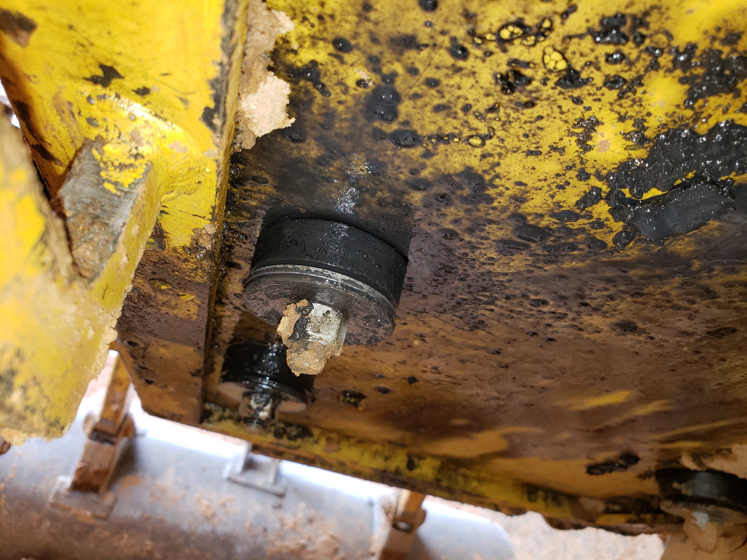

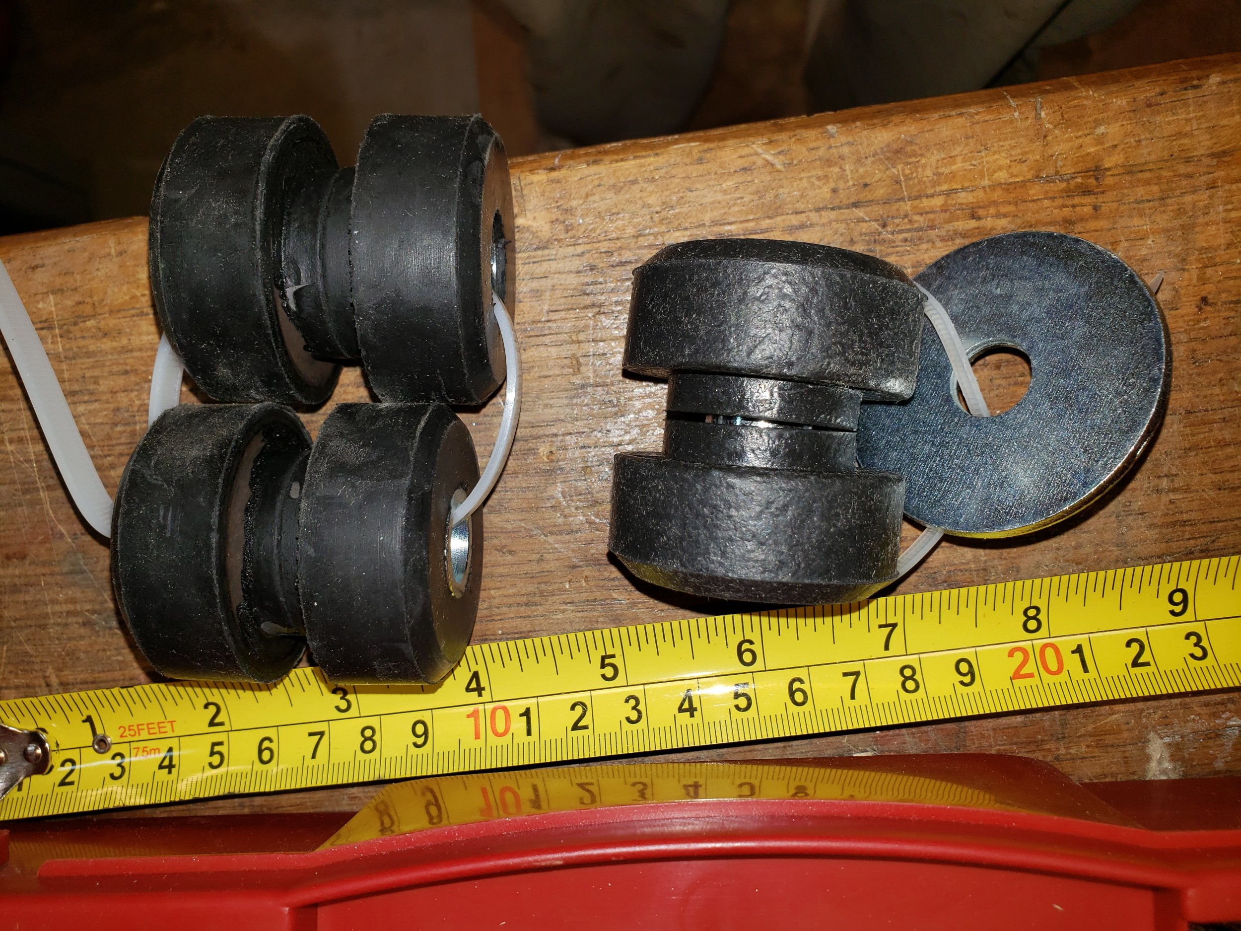

Looks like you got a great deal to me. Here are some motor mount photos of the older of T6 with Perkins.
Radiator mounts on the left, Motor mount on the right
/ T6 Info wanted ?
#23

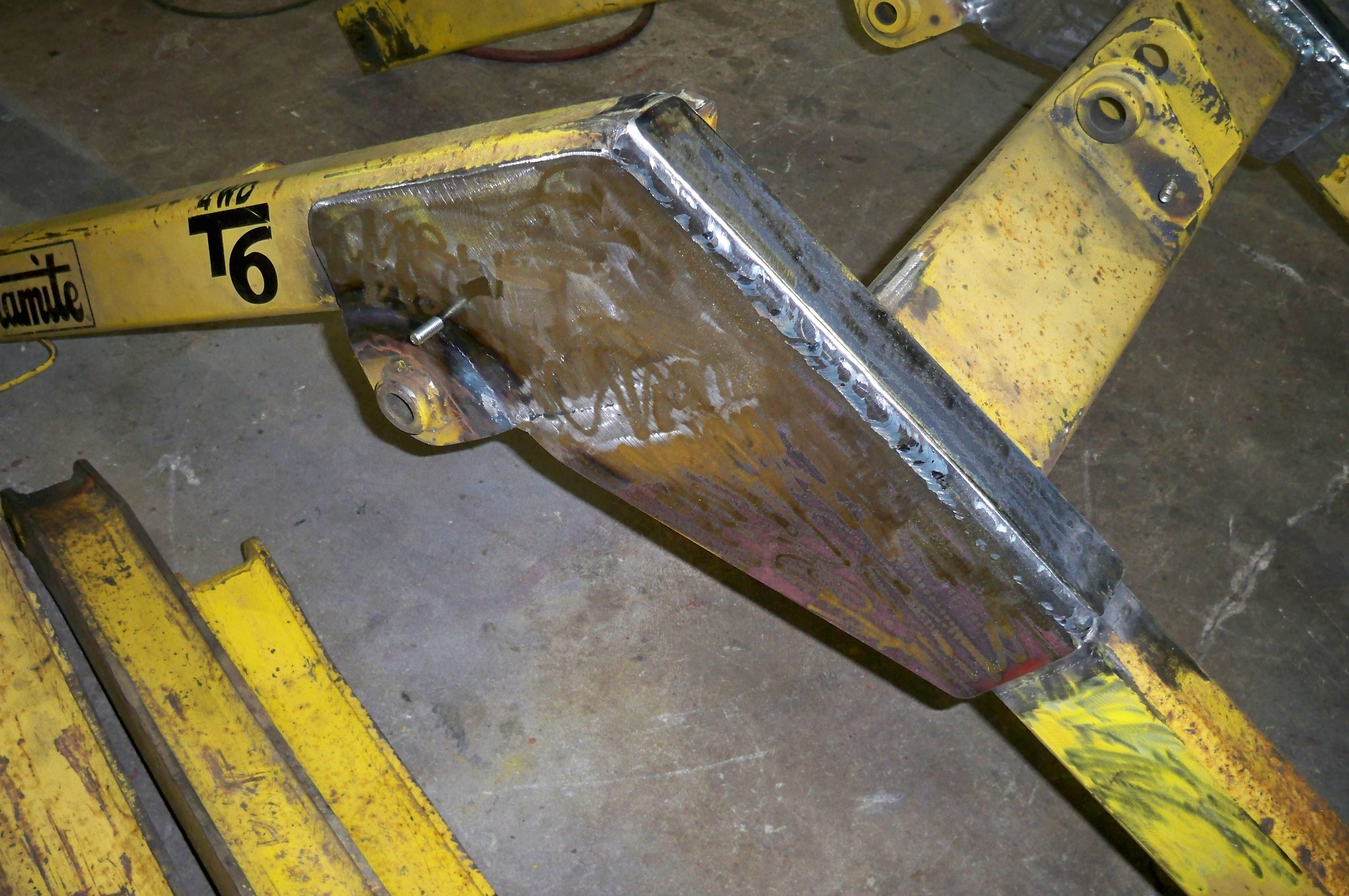

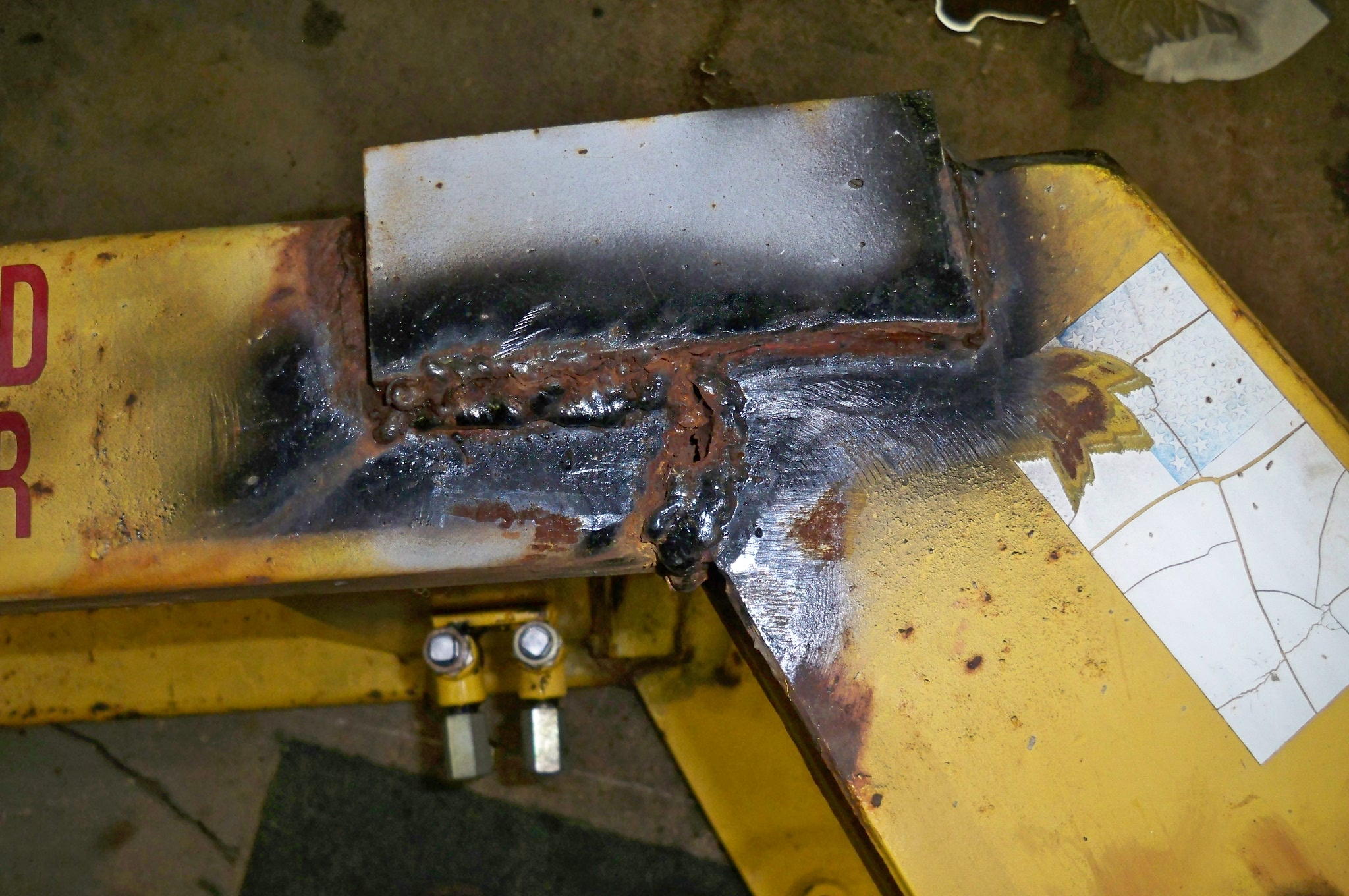

Thanks Waterskier, Now I know where to look for the rubber mounts. I can't move the engine much so I suspect mine are OK for now but the radiator has some movement. In fact the engine to radiator bracket was broken, I have repaired it. Every time I get to use this machine I like it more. Very impressed with the engine. When I get the fel linkage freed up this is going to be a super machine for my little place.
Nice looking welding on your patch plates.

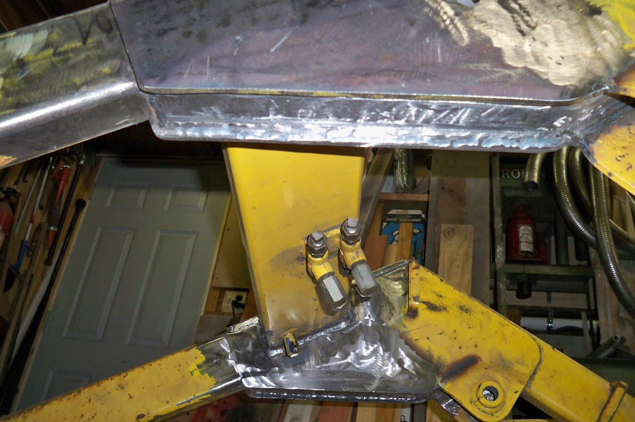

I had the same breaks as Waterskier, here's a couple pics of my repair-

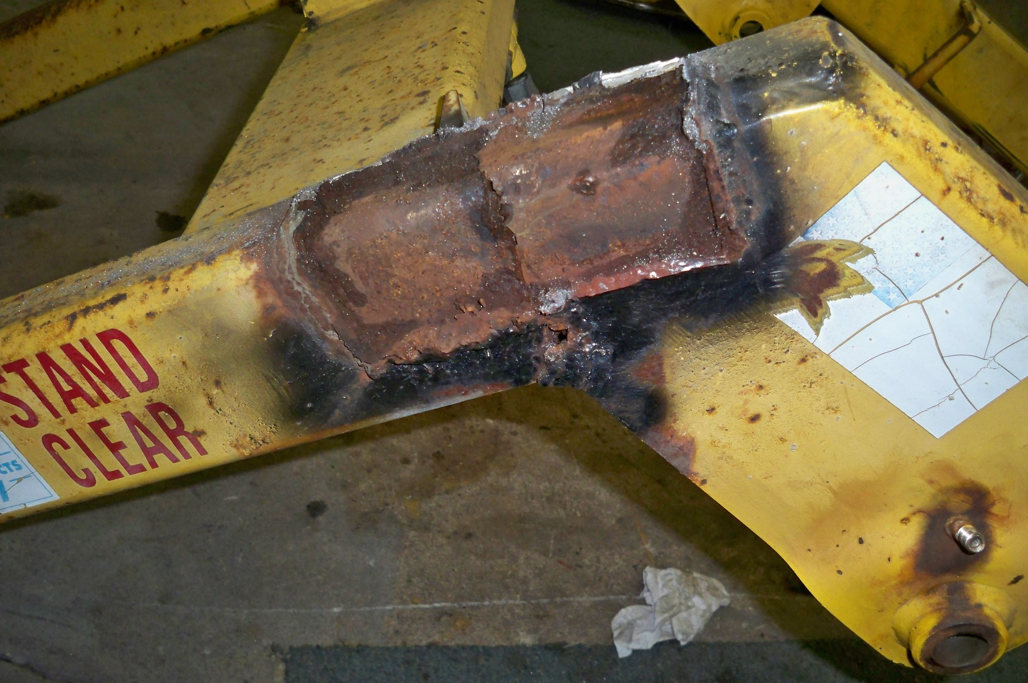

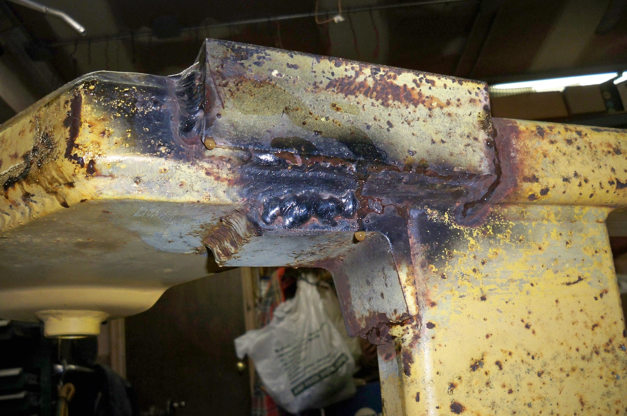

A couple pics of previous owners "repair"-
/ T6 Info wanted ?
#26
Nice job Dart, that should last forever. Wow that PO job was an ugly wast of time.
