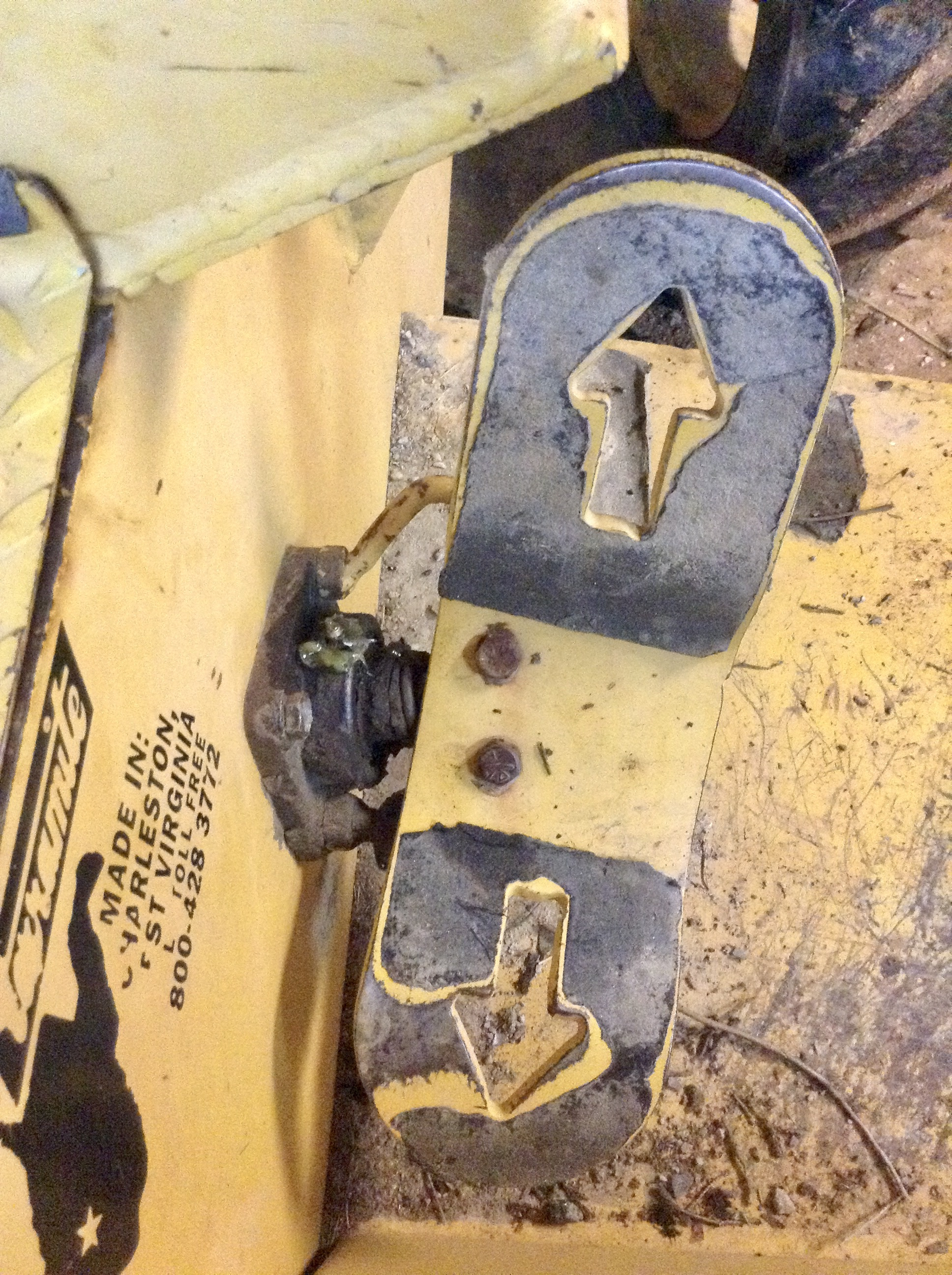

Is your go pedal mounted crocked like this one? It looks as if it's meant to be this way but seems clumsy after using, the old T5 was straight.

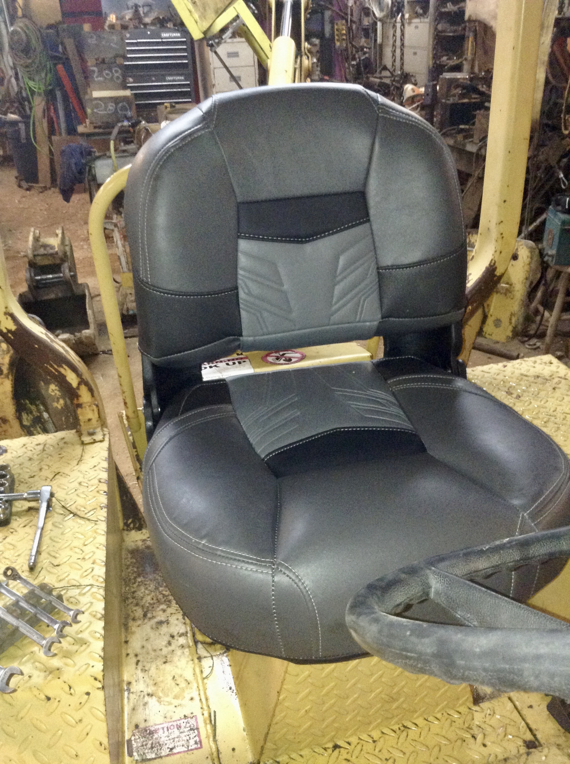

Added a bass boat seat today, comfy. Bottom cushion was missing on the original and was quoted $120 for a replacement cushion. 3174B80A-5D95-4C4C-804D-B29B456EABAE_1_201_a.jpegB3EEFD35-12B5-41E3-974D-8ACB8DE5D260_1_201_a.jpeg
/ T6 Info wanted ? #8
Looks comfy.
That looks like the same position of my pedal. I'll check when I get back to the machine. It's adjustable, for example, if you ever lose most of reverse, check the pedal hasn't rocked back on the shaft.

The go pedal feels awkward on mine, plus the seat tracks are no longer adjustable, so I stuck a bolt in the tread to give me a better angle.

- handle extension on the pedal - see MODS string - mostly handy for moving the machine when you are in backhoe mode

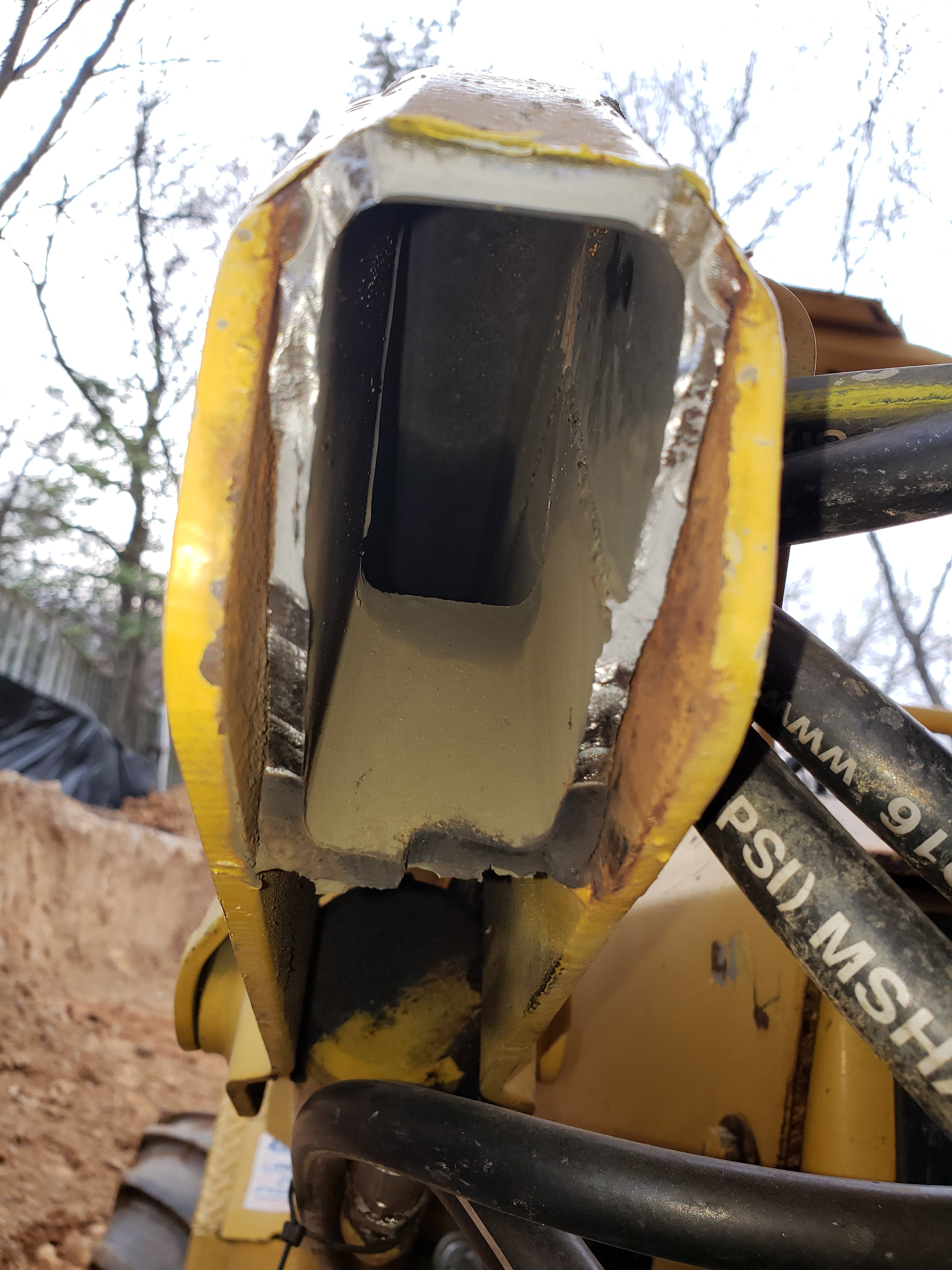

- double bucket cylinders - Watch out for cracks in the FEL arms, apparently a common issue. Look under/inside the reinforcement plate at the change of angle for a crack in the FEL arm. I will post a picture. The only time I've wished for more curl power though is when I was lifting something too heavy.

You can see from the discoloration, this crack along the bottom edge started years ago. Check your T6 to see if you have the same problem.
/ T6 Info wanted ? #11
Ugh. That looks awful.

I believe I will drill another hole to square up that go pedal, I see no reason for it to be mounted at such an odd angle and it still felt awkward today. If it doesn't seem better one could always just put it back.

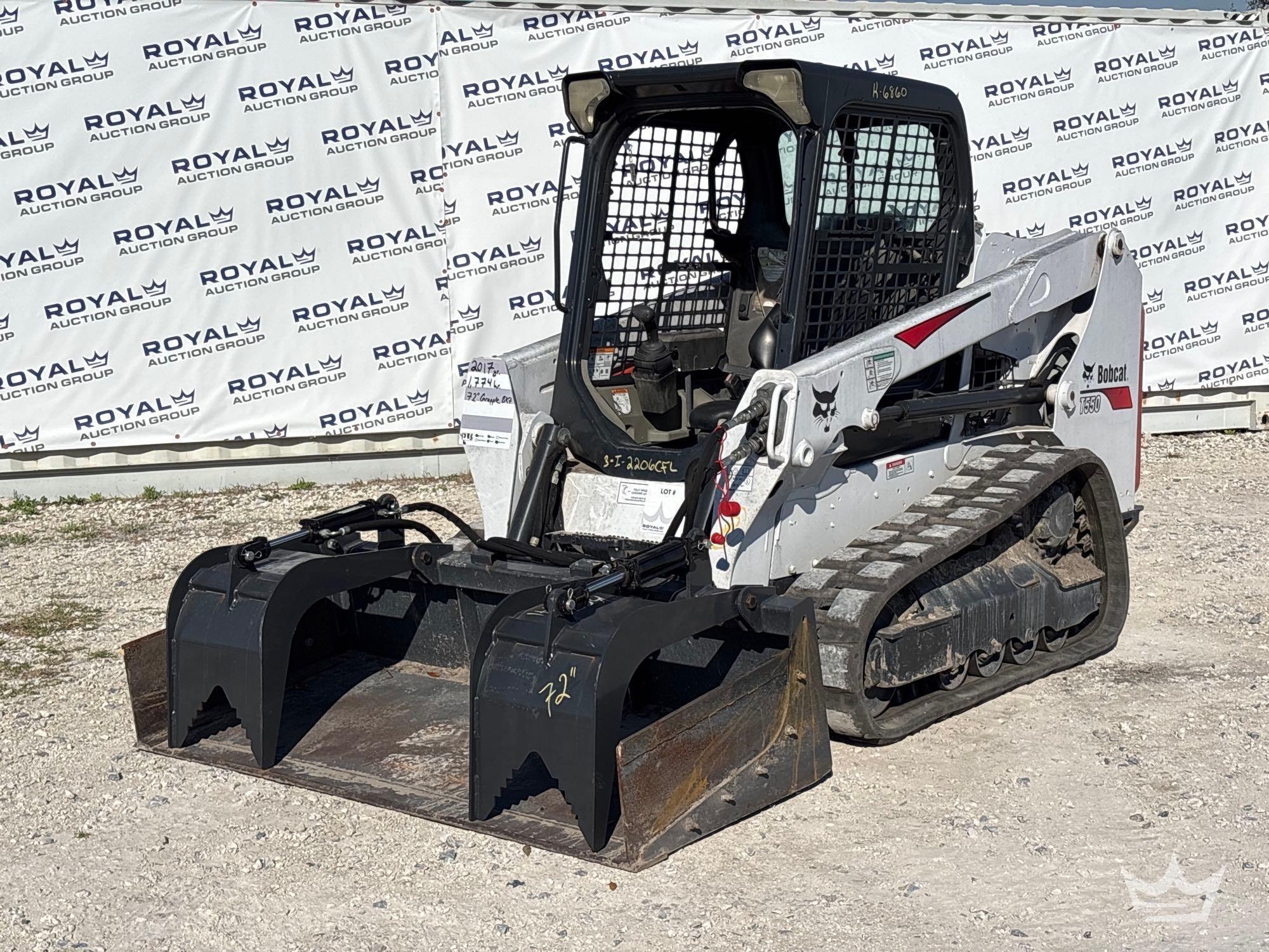

Are there different revisions of the T6? This T6 has dual FEL cylinders. It was auctioned and went for $4,300 by the way. What do you think of the price?

There must have been different versions or options. I've been understanding 2 FEL cylinders were what set the T9 apart. My opinion of the price is someone probably got a killer deal depending on the unknown issues/not diagnosed. I would have taken the gamble if it were close and I hadn't already got one in better apparent condition. Did you get it?
/ T6 Info wanted ? #17
So many variables, hard to know if it was a deal. I got mine for 5500 work ready. It was a great deal.
I think the last year or so of the T6 had the dual cylinders.
/ T6 Info wanted ? #18
Looks like a great deal...even if you need to sink another $2K to get it in full service it would be worth it...
/ T6 Info wanted ? #19
I didn't get the T6 pictured from Proxibid. For $4300, even if the cylinders needed new seals I think the buyer got a good deal. What I'd like to know is if the hour meter was broken or it really only had 200 hours.
/ T6 Info wanted ? #20
The hour meter looks to shinny and new and that machine had more than 200 hours
