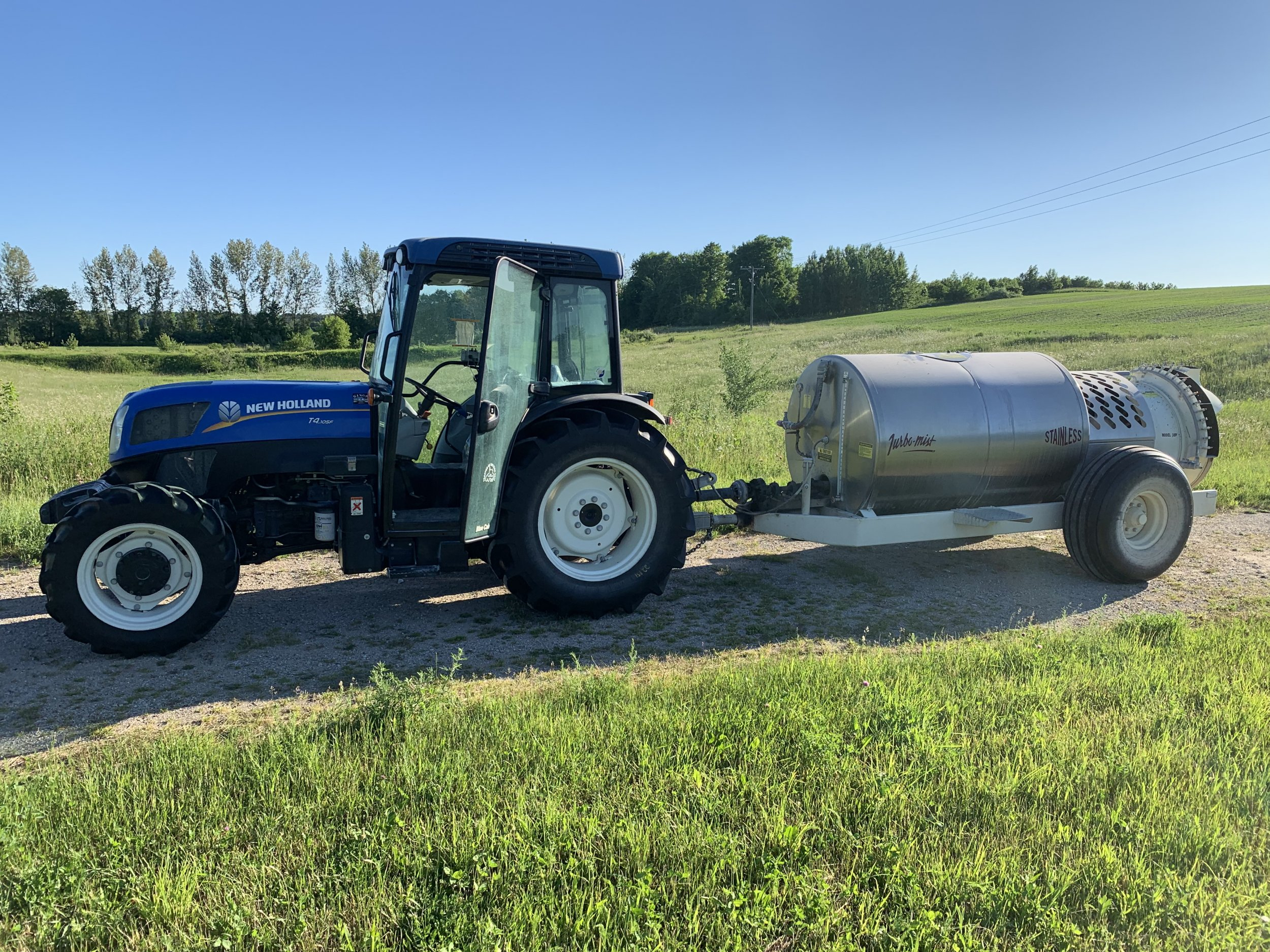

For what it’s worth my 2013 T4.105F is 89” tall , top of cab

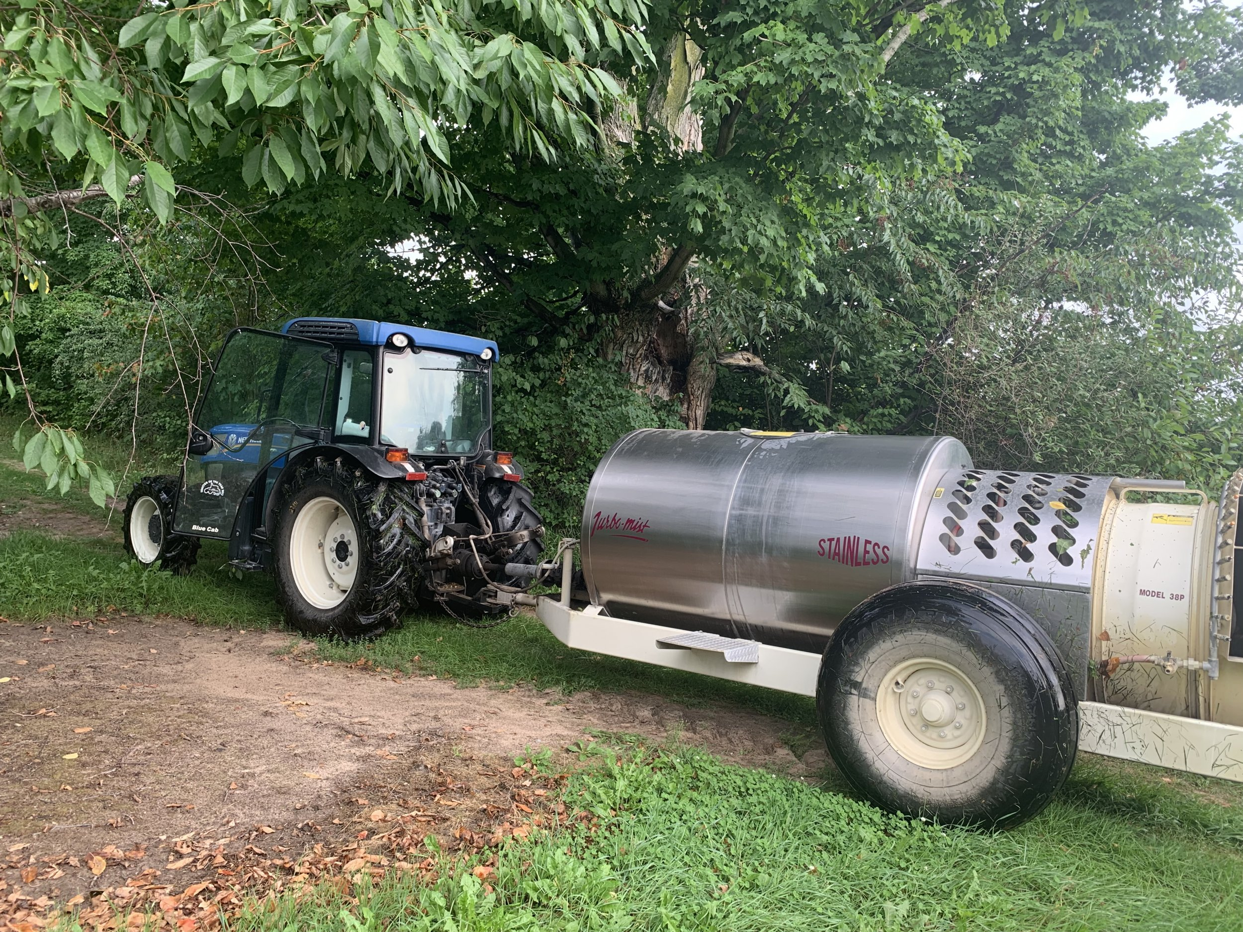

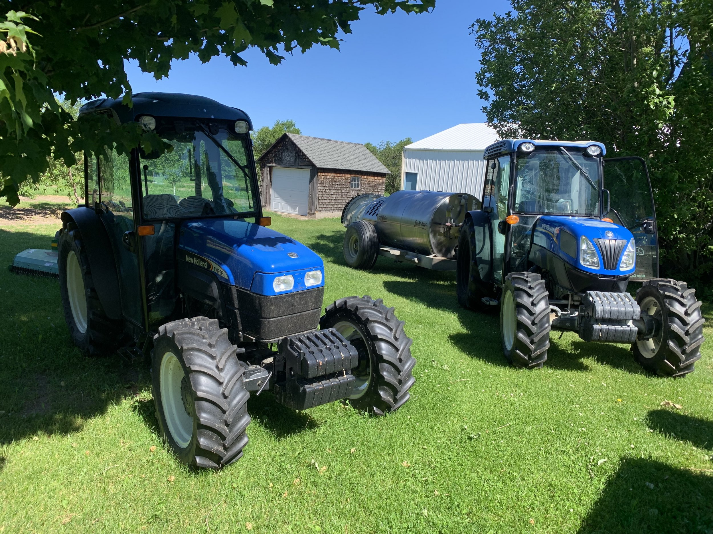

That roof looks more like my 06 tn95f which may be slightly taller than the 13 t105f . I can measure height tomorrow, both have about tallest tires available for them, I think 28” rims. Both have been good tractors, supersteer axle makes them super tight turning 👍

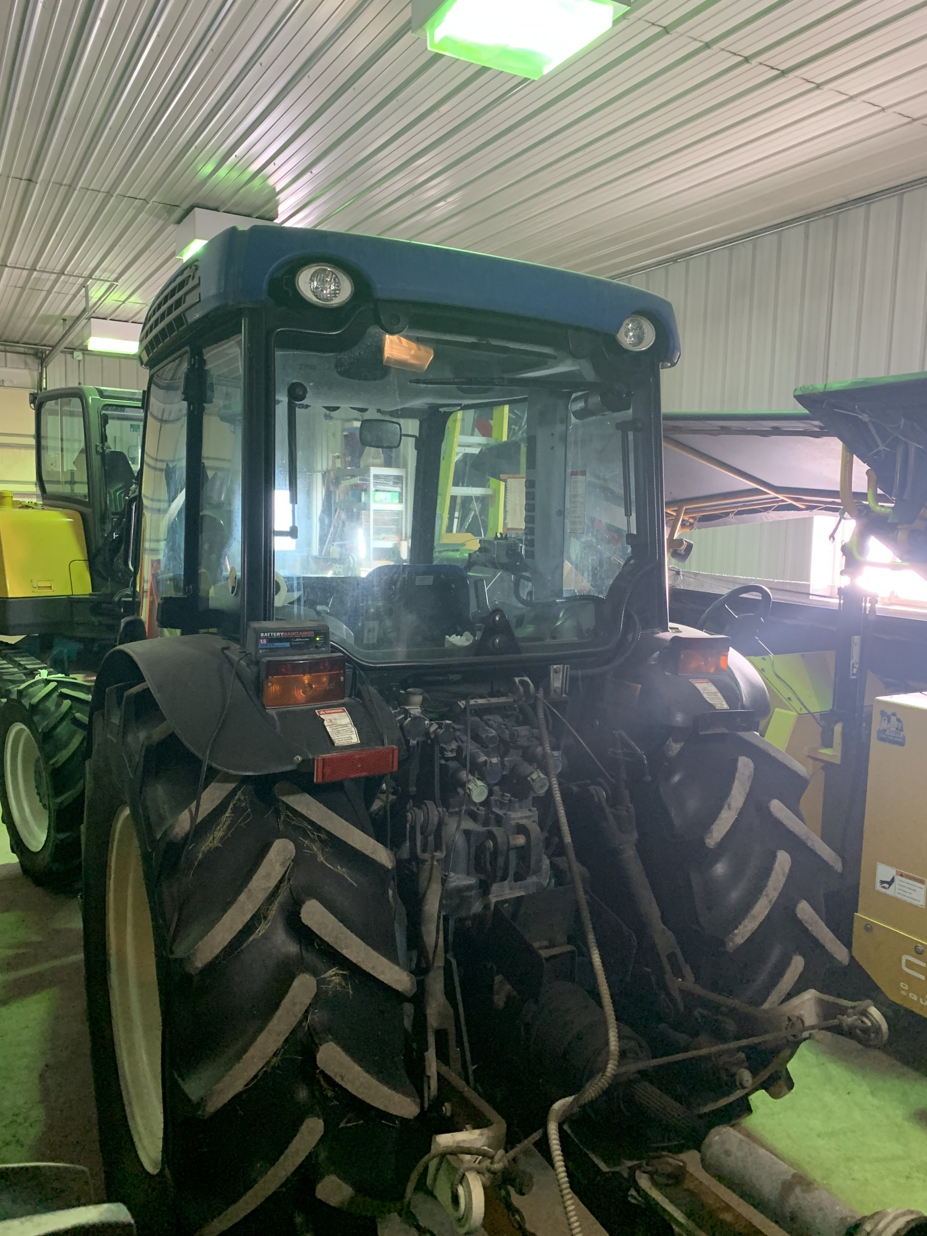

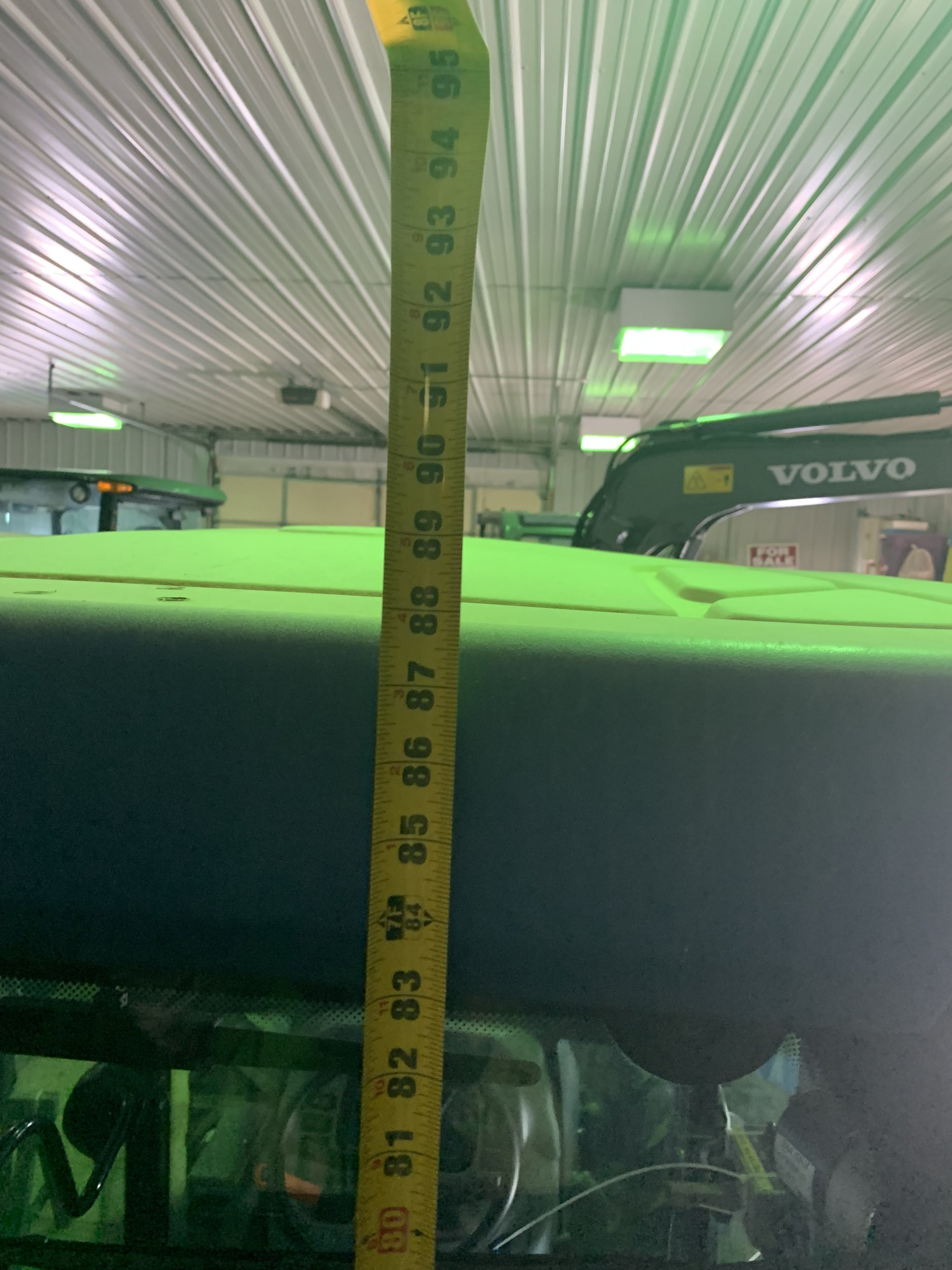

You had me curious so I ran back over to measure. Sure enough the 06 is almost 96”. Evidently they made them shorter for few years like my 2013 then went back to taller 🤔 . Both mine have 420/70/28” tires

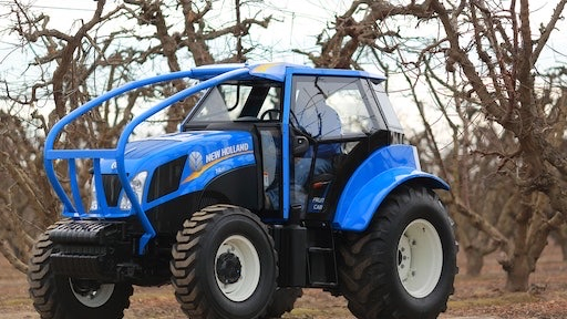

Thanks, the fruit cab is also an option. I'm not sure if they have heat though?
