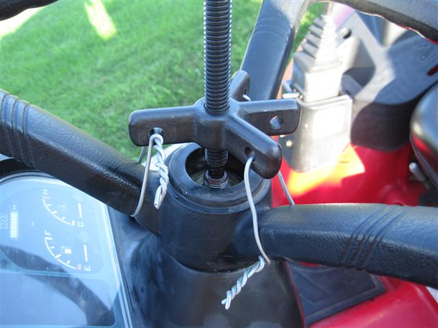

Hi Tymdealer,
I got read your reply and I appreciate the input! I, unfortunately, do not have any tractor dealers near me; nor do I feel the need to source out at this point for this particular problem [that has somewhat disappeared once again!].
However, I bought a steering wheel puller today at a local auto parts store. Of course, when I got home, just to check and ensure I bought the right tool it seems the steering wheel is unique to TYM. IE...my standard puller has bolts (metric & sae) along with a pair of L-shaped shafts that are used vice threaded bolts if'n no holes are apparent and guess what? To my dismay, there are no threaded or unthreaded holes inside the steering wheel hole.
All I've got is a 1 & 1/2" wide by approx 1" deep hole with no hold down/clamp locations readily visible?
What am I missing? Do I need a specific type puller or what? I intend to pull my steering wheel, lift off the dash top and replace the hood spring with a thicker/stronger spring. I am convinced that that is all it will take to remedy this problem I've been having.
But -- what is the correct type of puller to buy? Can you enlighten me as to the proper tools I need to acquire? If so, many many thanks your way!!

I recently pulled the steering wheel on a T500 and used a regular 3 arm puller. It came off very easy.

I had some spare time so I decided to pull my steering wheel. You are correct a normal puller does not seem to do the trick. The claws can't seem to get far enough underneath so they end up trying to tear the rubber. See the last picture for a good laugh but that is how I got it pulled. Not pretty but it worked. The key is even pressure on three sides. I did spray PB blaster in there at noon over my lunch today and pulled it this evening.
sorry, but this is probably not the solution you were looking for.

Thanks for showing me that it can be done by homeowner! I hadn't thought of that method, but it worked and I'm gonna hafta try it. Just can't understand why it's designed so difficult to be pulled. Even shop mechanics must shake there heads over this goofy mess.
If you look at pic 1 and 3, I wonder why the holes are on the underside of the hub? Those two holes (if threaded) are exactly what is needed to be seen from the top-side as to pull it properly?! I believe that was pic 2, mine is the same -- no holes or slots inside the round rim to catch any bite onto!?That's how the style of puller I bought is supposed to do so.
I'll have to go get a three jawed puller also; it wasn't my first choice because I saw that there wasn't enough room to get the jaws underneath the wheel! It's about an 1/8" space between wheel and dash top; looks like yours is still same style as mine.
Thanks, Greg

I have personally pulled many steering wheels off of 233/273, and have never had a problem only tool i have ever used is a hammer to tap up on the bottom of it. Normally just remove nut and pull it off.

Greg: Use a brass rod about 1 1/2 in in diameter 10 to 12 inches long. Remove the nut untill it is flush with the threads then have a partner pull up on the steering wheel keeping constant pressure on it. Place the brass rod against the flush nut and strike with a heavy hammer until the steering wheel pops up. This is the way we removed most flywheels from small engines in the shop i worked at, and I used this method to remove my steering wheel. When you put back together use never sieze on the splined shaft so it doesnt rust together. The brass is softer than the steel so it wont hurt the threads.

myyaz33, It's been about ten years since I first asked about this and I've "finally" gotten around to pulling mine off. You were/are absolutely correct - it's a real pita to get off!! What should have been about a 15 - 20 minute job took almost two hours! I farted around with my 3 jaw puller, screwdrivers, and pry bars for spacers and finally got enough steady pressure on it that with a BFH to the top of the puller it popped up. It'll never be as hard to come off again as I am going to "liberally" coat the mating surfaces with anti-seize now that it's off and before it goes back on.

At any rate, I just wanted you to know you were absolutely correct in the pita it is to remove the steering wheel! I noticed once mine was off that there are 2 drilled/tapped holes - that I "assume" are for a wheel remover - located on the (underneath) side!! How dumb is that! Probably put together at the factory upside down and NO one noticed!! If I discover any other nuances I'll be sure to post. I do love my tractor, but it's sure got some quirky things that pop up with it. As do all others I'm sure.
