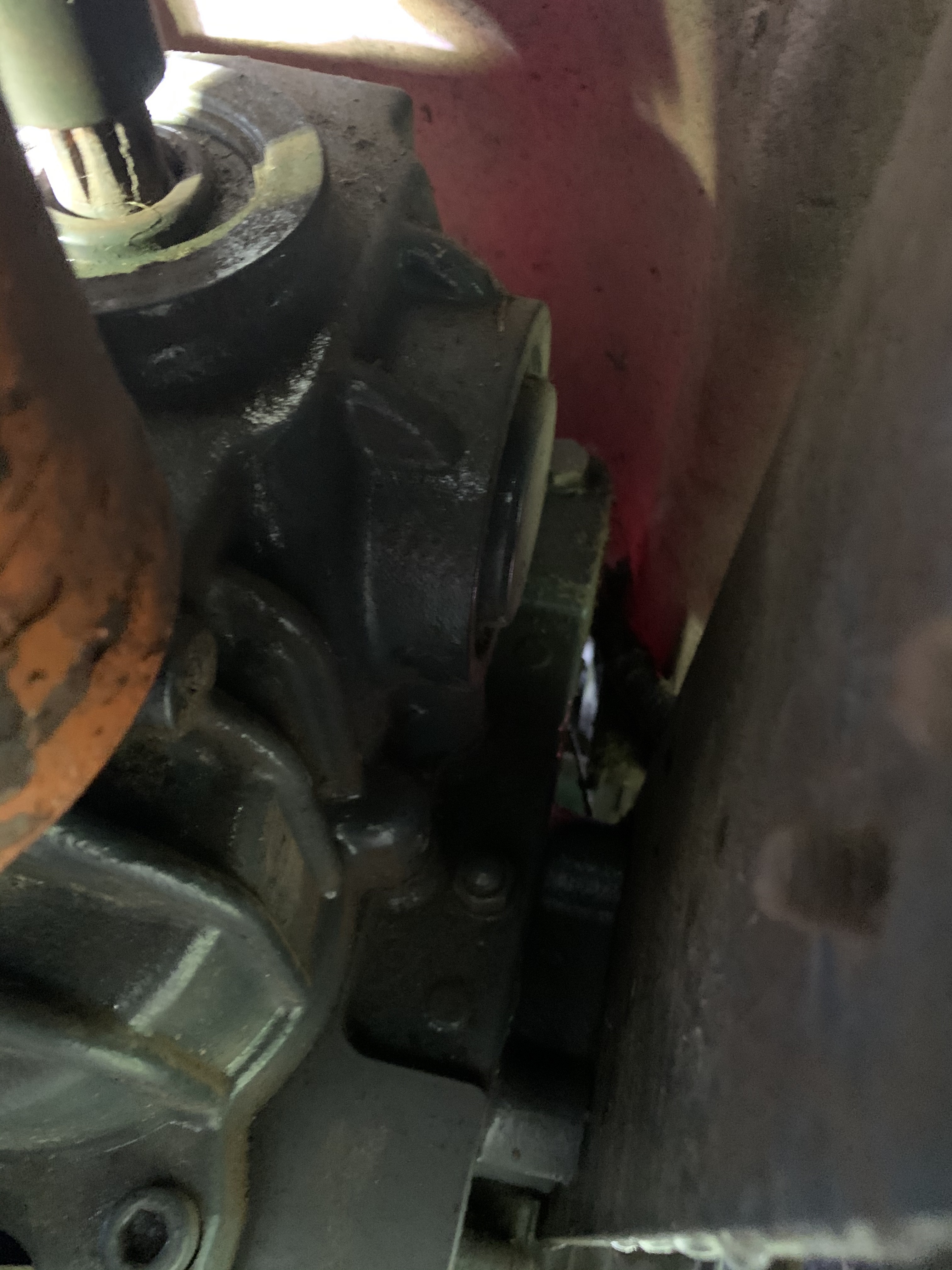

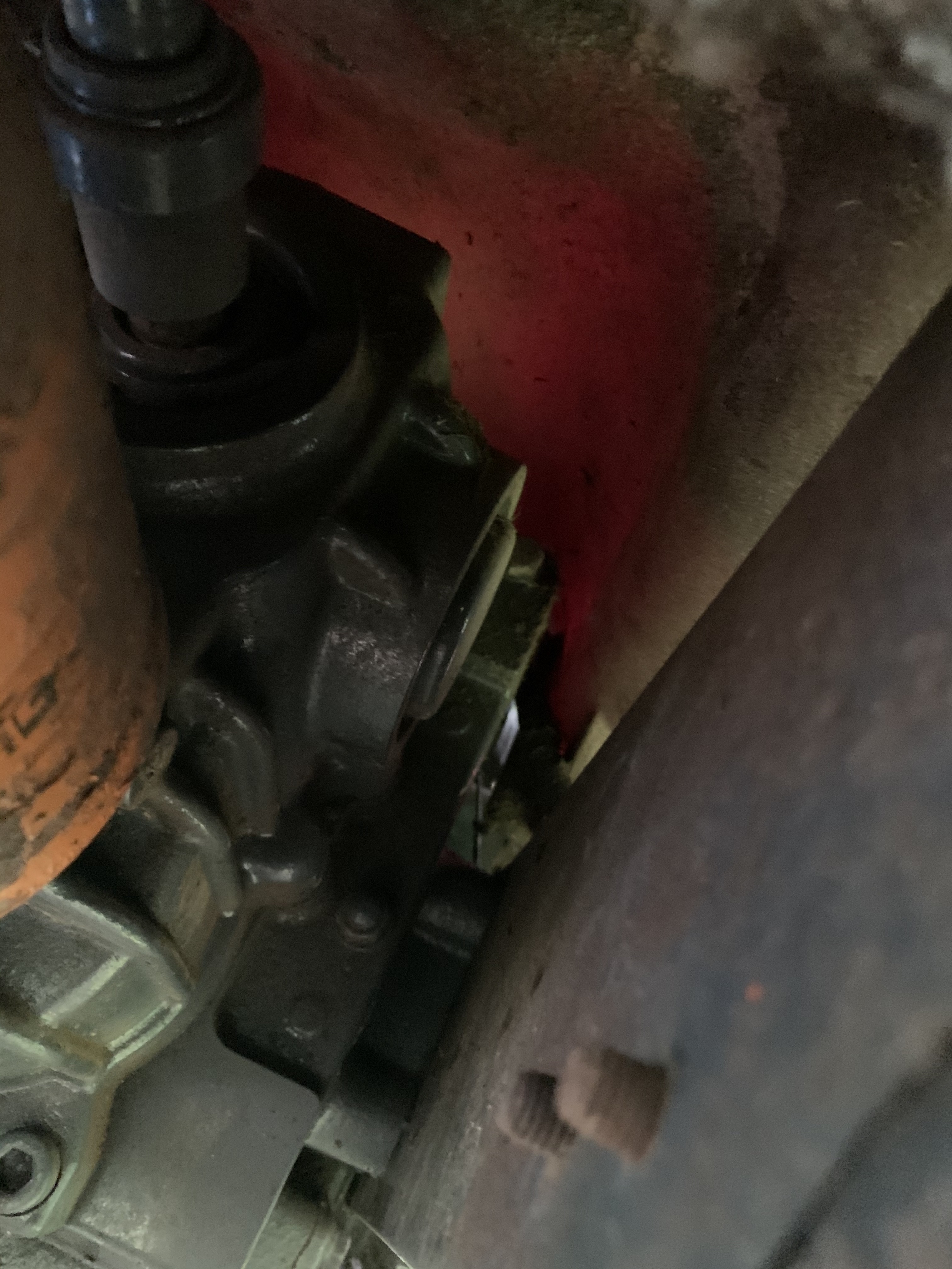

Bud may have hit the jackpot here. This is a pair of photos looking at where the drive shaft connects to transmission housing.
In the first photo you can see the finger splines of the transmission input shaft (oil filter is orange). Now, if I physically slide the shaft backwards towards the input shaft I can actually engage the splines (second photo)
Post.jpg.
The problem is the shaft wants to slide forward. Something that should be holding it in place no longer is. I don't think the shaft itself is broken, but I need to figure out which component is the culprit.

You have the early drive shaft that was changed by time the T293 came out. Mid production T233's were also updated to the new type driveshaft. What often happens with this early type is the spline in the rear coupler goes out. Sometimes it also takes out the spline on the input shaft of the transmission at the same time. The new replacement drive shaft looks like a regular implement drive shaft only smaller. The new type has a regular yoke and u-joint not a slide coupler type. You can get a new replacement transmission input shaft from TYM if needed rather than a whole assembly.

I saw a similar post by myyaz23. My initial assessment is the splines looks pretty good. The couple just gave out it appears. Will know more when I removed the drive shaft later today. Thanks for your insight Bud Soda - spot on!!

I appreciate your help myyaz23. Your post was a bit part of the reason why I'm sure I can get this done. Parts ordered from Idaho (shout out to Jordan). I cut a hole over the driveshaft and removed it. Definitely some wear on the transmission input side, but the splines look reasonable. Makes me wonder why the metal on the couple on the tranny sides is so much softer than that on the motor side. Motor couple was clean and pretty. Obvious defect in engineering that I missed based on all the posts. Quick question. Did you just crank down the shaft bolt? There's no place on the tranny shaft with a missing spline? I'm hoping I can bite into the splines that look good, but still secure the bolt on the u-joint the bites into the shaft. fingers crossed.
