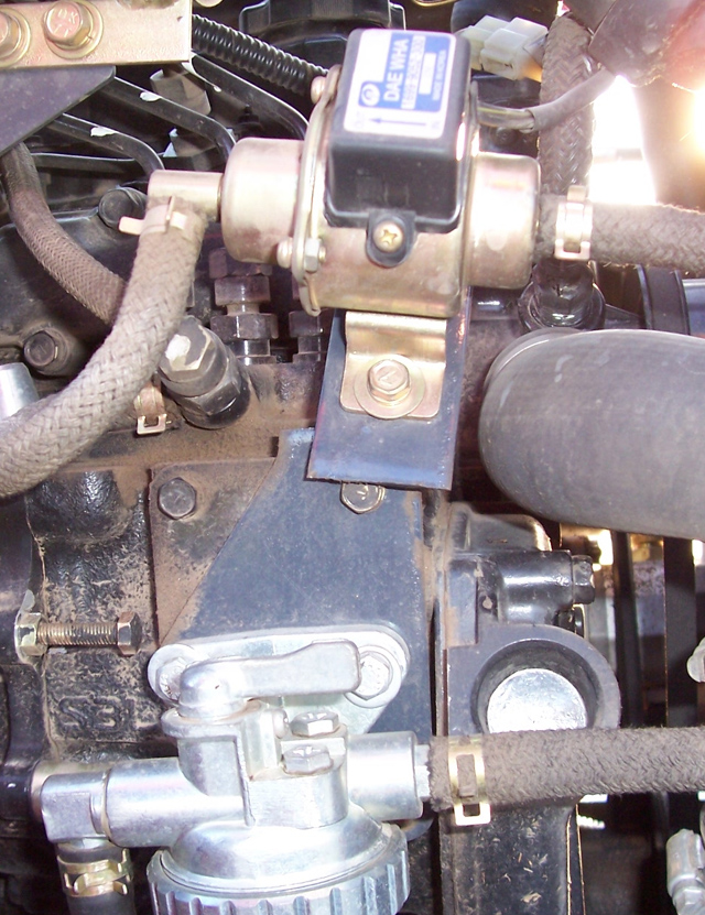

I OWE you a beer! Just checked and the bracket that holds the fuel filter is broke in half up high. Just about 62hrs now so maybe I will be having the dealer do the 50hr service instead. Maybe I could get a new muffler too..
Thanks for posting this issue. I thought the T273 vibration issues were all taken care of in the USA..

Yup, that's the one. Thanks for posting a pic, definitely better than my description of a fuel-bulb "thingy". Guess it's time to let our dealers know that this failure is more than just an isolated case. Maybe TYM America will step-up to the plate and send our replacements? They've been darned good about these things thus far :) .

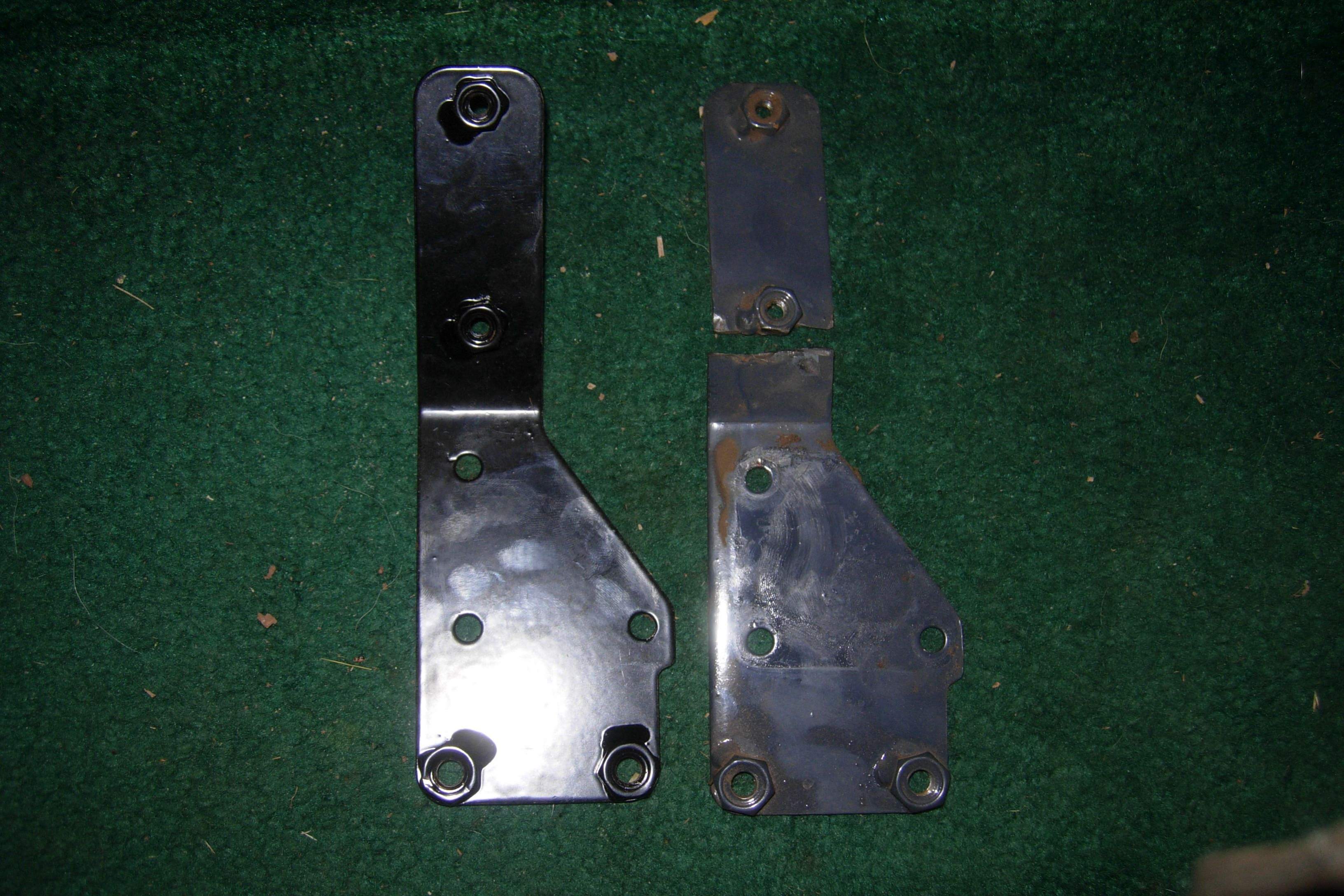

Just to followup and my earlier e-mail. I just finished installing my new fuel bulb mounting bracket. Looks like it's an identical part to the original. Close inspection of the backside (see pic) indicates that the break is occurring at a spot where a bolt is welded. I'm guessing I'll be replacing this do-dad again. Time to learn how to weld I guess. . . .:D

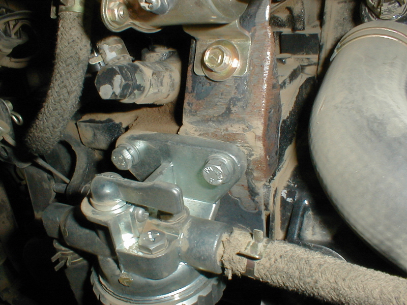

Same issue with my T273 re: the muffler and the fuel pump mounting bracket breaking. On the third go around with the fuel pump mount, although it is actually the first one that I welded back together along with the addition of a small gusset on the 'front' side (nearest the fan). That has been holding for over 100 hours now and doesn't vibrate at all. A simple fix that should be factory done. I had a discussion with a rep from TYM when the muffler and fuel pump bracket broke about re-engineering them. Apparently the muffler has been redone (I'm on the second version and it is working fine - I hear that they modified it a second time by adding some angle iron). Sounds like the fuel pump bracket has yet to be changed. Too bad, it seems to be a very common problem. I was told that it was an addition after production because the fuel strainer bowl was too low and hit the frame if mounted as it was engineered (notice the unused two threaded holes on the engine, beneath the bracket - that was the original idea for mounting directly - no bracket).

Thanks Bkjohns. Sounds like we all will have to keep a close eye on the hydraulic fluid cooler. After replacing my broken fuel bulb bracket things are much much quieter, but there still seems a more subtle rattle coming from somewhere. Of course, it is a diesel so maybe I'm just a little paranoid.
What did you use as a gusset to reduce vibrations on the fuel bulb mount? I was thinking about doing the same thing when I replaced the broken one, but but wasn't sure what to try. Do you happen to have a picture of your fix?

I just used a small piece of 1/8" steel and welded it along the edges of the fuel pump bracket. Of course I also welded the original break. Just be sure to keep your bead small on the back side of the bracket. It fits tight to the engine and there isn't a lot of space for a big ugly bead. Unfortunately most of my welds are big ugly beads so my best welding is done with a grinder. I'll try to get a picture posted here soon.

I would highly recommend the welding of a brace, even onto a new bracket. The grommets might help, but could also make it worse by allowing even more movement. One thing that happened when my bracket broke was that since the pump was flopping around in the engine compartment the fuel line got close to the fan and if I hadn't noticed it could have eventually ruptured the line. As it is there is only a small frayed area on the outer jacket of the line.
Hopefully the picture came out. The brace I welded on is the rust colored metal along the front (right side in the photo) of the pump bracket. Rock solid and has lasted for 100+ hours.
