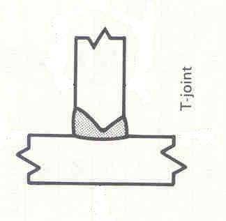

I'm getting ready to weld up my backhoe ripper with an old AC buzzbox. The shank is 1" and the top plate that attaches it to the ears is 1/2".
I am trying to figure out how big to make my bevels in the 1" shank for the t joint. I looked online and saw 1/4" as a recommended bead size. You can see pictures of it here:
http://www.tractorbynet.com/forums/build-yourself/220577-john-deere-260-backhoe-ripper.html
Do you have any suggestions for the amps setting on the welder? It's 220VAC.

You are going to want WAY more than a 1/4" bead when done:confused2:
I would bevel the 1" peice about 3/8's on EACH side. This will leave you with only about 1/4" in the middle.
Then (as others will reccomend here) burn in a root pass with 6011 and then all subsequent passes with 7018 untill you have a nice looking fillet.
But it sounds like you are a newbie welder and those two rods can be a pain to run, especially if you dont have a good DC welder.
I personally wouldnt have any problems beveling like I mentioned and doing the whole thing with some 7014 on about 180A. I would be confident that It wouldnt break if I were doing it that way.

I am guessing that the 1/4" is the bevel and not the bead size.. I would always suggest beveling 50% of the thickness and at 1" I would say to use a 5/32 at minumum rod for the root. Burn what you want but 1" material demands a hot rod.
/ t joint weld prep #6
If you really want it to hold the first time, bevel the 1-inch plate at least 37-degrees, if not 45-degrees. And put enough weld to have 1/2-inch reenforcement outside of the plate on each side.
When not working off blueprints I go with my gut and make a decision on what the item is going to be used for. If the item is not really going to be stressed then I cut the bevels, and weld the amount accordingly. You can over weld things at times.

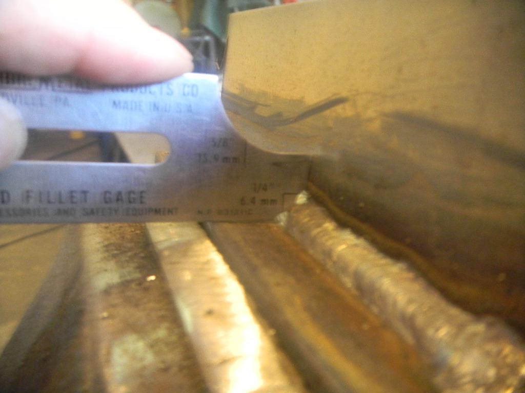

This is from my first weld bead. I was holding the rod too far away from the work.

Even with a slightly long arc, you shouldnt have that much porosity. Check your rods for moisture or block the wind from the welding area. Looks like you were running too cold also. You may need to go to a smaller rod if you are maxing out your breaker capacity. You have to get the amps up to the correct number for the rod you are using if you expect to get a good weld. 150 amps if correctly measured would burn a 5/32 rod but with inexperienced welders, I never recommend larger than 1/8" as the larger rods are the harder they are to use correctly.

If that was done with 5/32 it is way too cold. Your 150 Amp problem is going to be a problem trying to do a 1/2" fillet (your tee word). Use 1/8 as hot as you can sustain your weld w/o tripping the breaker. I always run a little hotter than most but then I have done a lot of this. Hot, short arc, stay ahead of the puddle and don't let it pile up. Better to have a small hot puddle than a large cold one. Point your rod toward the cold metal not toward the puddle. Later you can get to where you can work it both ways depending on what you want to do. Remember you are fusing the metals, both pieces and the rod, lay it on top and you do not have a weld. I gave away all my books on welding long ago or I would send you one. You may have to go with 3/32 rod with your amp limit. It will work ok, just take a lot longer. To start, use what we call stringer beads; small beads tht overlap each other. Get that down before you try a weaving pattern. Practice on scrap till you get it down. When I first started I burned 50# of rod before the instructor gave me an A. And that did not include vertical or overhead work much less welding down hand. It is difficult to do this on the net, better if you can see the student's technique and provide guidance and corrections. Find a friend who welds well and let him (her) coach you. Too bad you are not just down the road.

I switched out my circuit wiring to 6ga and put in a 50 amp breaker. I played around some more and got a much nicer looking weld with undercut, so i'm sure that i am penetrating well. I just need to modify technique to lose the undercut. Thanks for the advice so far! I always thought you needed to point toward the puddle as you drag the rod? What does turning it the other way do?
/ t joint weld prep #20
It makes sure you get the heat to the bottom of the joint, you have to hold a close arc though and move fast enough to ensure you do not blow a hole through. Look on the reverse side of the weld, if you see a nice even bead on that side you are good, if you see the gap in the joint you are not penetrating to the bottom. You need about an 1/8" gap between the two pieces. Make sure you melt in all the tacks also, you should not see where they were on the reverse side. If you leave any unfilled areas you have a weak joint. It's hard to explain but you can see the result.
The root passes ARE THE MOST IMPORTANT, they do not have to be a lot of metal or look nice, just solid and sound. The next passes as you can experience is when you point toward the puddle as you get more build up. At that stage you are not worried about burning through and leaving a void or slag pocket. Practice Practice.
