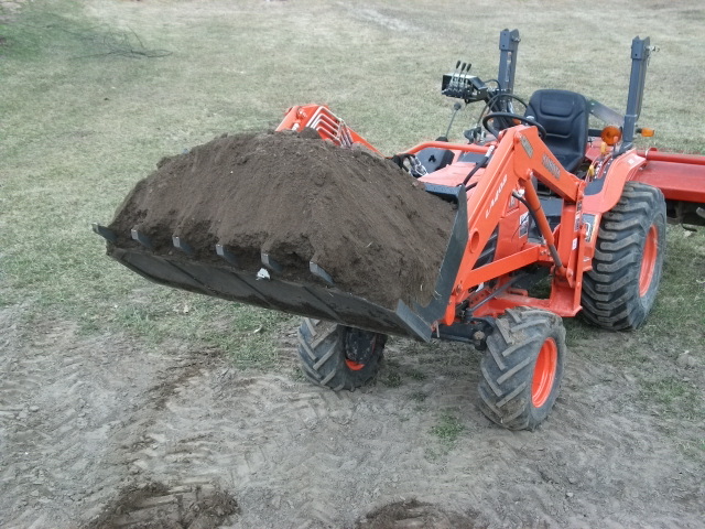

You are better off with wider tires/rims which give you a wider stance for loader work. one of the first things I normally do on a new to me tractor if it has not been done already. The pic is an example of what I did on my B7800. Much better flotation when lifting heavy loads and working in soft ground.

   / Switching front tires for more narrow width on L series? #11
This makes perfect sense to me.
One of my BIGGEST issues with my L3400 is the small diameter/narrow front tires (R1's) With any sort of weight, they easily sink into the ground or drop into a hole & dip, making the tractor unstable. I was half looking at the bigger Ag tractors that have front & rear tires that are closer in size because of that issue, but you have to go really big (compared to a 3400)!
