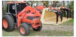

   / Switching from R4 tires to R1 Ag tires #5
Hi again Nathan:
Four years ago I removed my factory AG tires and rims. Replaced them with oversized turf and wide wheels /forums/images/graemlins/cool.gif. See attached. You could never get me to switch back to those smaller AG tires. MUCY nicer ride with big tires. Never have I had a traction problem…
If you were closer I would let you try the AG wheel and tires, but I am fairly sure you would not like them. I do not have a picture of my L4200 with the AGs on it. KennyV.
