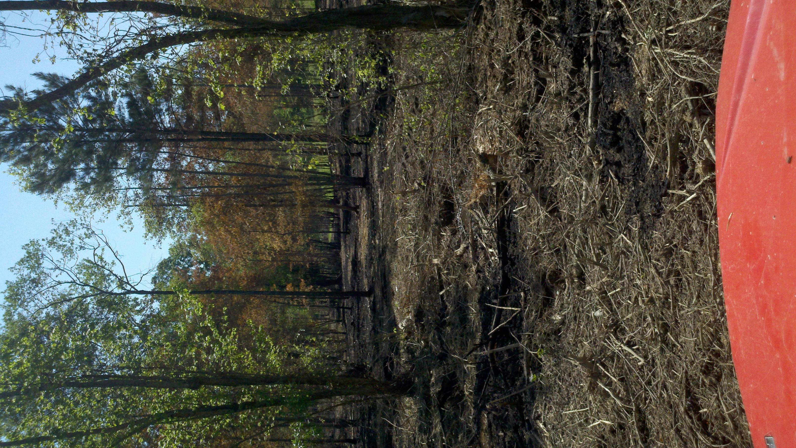

I have an area of my property (1/8 acre to 1/4 acre at most) that is swampy. I recently cleared the trees that kept it in the dark and am waiting on the dry season to get here so it dries out. There is a creek that runs that side of the property about 20-50 feet away.
How do I get this area to drain better and not have standing water any longer?
I have a 50HP tractor with FEL and just purchased a box blade. So those are the tools I have to work with.
I was thinking of taking the box blade and cutting a drainage ditch and sloping everything to it and having it drain to the creek. I have never done this though and am not sure if that would work.

If you have slope to the creek I would put in perforated drain lines underground. The older term is "tile draining" a field....but most use plastic now. If you have one central low spot you can add a basin or "Higgenbothom" to that area to rapidly drain the surface water.
I have wet "muck" soil...sort of like peat. I put in a bit over 2000 feet of 6 inch line last year and about 1000 feet (little less) of 4" line. I will add some more side feeders this year to help in the lower spots. The 6 inch line was just double wall perforated without a sock. Depending on your soil you may need a sock or gravel around the pipe. The 4inch feeders are single wall with a sock. The line drains 24/7/365 just about. Sometimes it is a slow trickle...other times pouring. You need very little slope to keep it going.
Just try to get deep enough not to crush with whatever equipment you have. The double wall is better for this obviously.

That is all you need to make the trench. Start at the swamp end but far enough away so you are not working in water. Make the trench the width of the bucket. make it full depth and keep the bottom smooth as you go along. Then back-slope the sides and take out the plug that remains at the swamp end.:thumbsup:

you noted creek 20 to 50 feet away, but you did not mention height difference from top of water level in creek to swampy area.
nor did you state how water drainage is going on in that area.
examples... do you have some hills that are draining water into this area?
do you have possibly a spring?
is the area just lower compared to other areas?
is the area just a few inches above the creeks water level?
field tile, or french drain. most of it is all plastic pipe with slots or holes in them. as as other said you may or may not need a sock over the pipes, and you may or may not need rock around the pipe. to get good drainage.
but you may need to bring dirt in, and re-slope, re-do grade of dirt for that area. so it has a place to drain to. vs collecting in that area.
it may come down to, digging a regular ditch, like you see on the road side into this area. and then installing a 6", 8", 10", 12" or like culvert for this area. so you can drive across this area.
when dealing with soaked wet dirt. like marsh area. you may have to go at the project in stages so you can get tractor into areas to dig a ditch, or to install french drain, or to bring in dirt. and it may mean waiting a few months between each stage. as you wait for areas to dry out enough to drive over without getting stuck.
if you had a backhoe or excavator. it might be a tad different story than above paragraph. but dealing with the "getting stuck part" is still there.

I will go by and snap a picture after work today of it and post it but it is basically a low spot next to the creek. It is a good 2-3 feet above the creek but everything slopes down to this spot from the front, side and back of the property then rises back up to the creek bank. This creek is only about 4 ft wide. That is why I was thinking that just cutting a ditch and using the box blade to help slope towards ditch/creek would be easiest. This part of the property is the far NW corner that will not be traveled much and the natural slope of the land takes everything to this one spot so cutting a drainage ditch and sending that ditch to the creek seemed logical to me. I guess I could try that and if it did not work I would already have a ditch started to then make into a trench and put pipe in, etc...for a french drain.

your last post, kinda gave me the hibee jibees. you need to be careful when putting in ditches and more so put in thought about erosion control. it may work for a few years. but after that, it might turn out to be an ugly mess. were you have 2 to 3 feet trench that has been washed away with heavy down pours of rain.
and in that, you might look into seeing about hauling in some good size rocks to line bottom of ditch. or perhaps make it wider vs narrow and deep. so it takes much longer for heavy rains to wash things out and allows you to mow it.
there are a 1000's of ways of going about it, no wrong or right way. but there might be a better way that last longer and less up keep over the years.
to note it, be careful with erosion control.

if you are not planning on lake / pond. i would say just re-slope / grade the entire area first. and if having mush areas. i might suggest running a french drain / field tile up near bottom of hill sides. so the french drain / field tiles run parallel to the hill side, so water coming down hills hits the french drain / tiles and then every so often run a pipe from french drain down to creek. so the water hits the french drains first. vs water running across flat areas of land.

Here are some pictures from the area I am speaking of.
