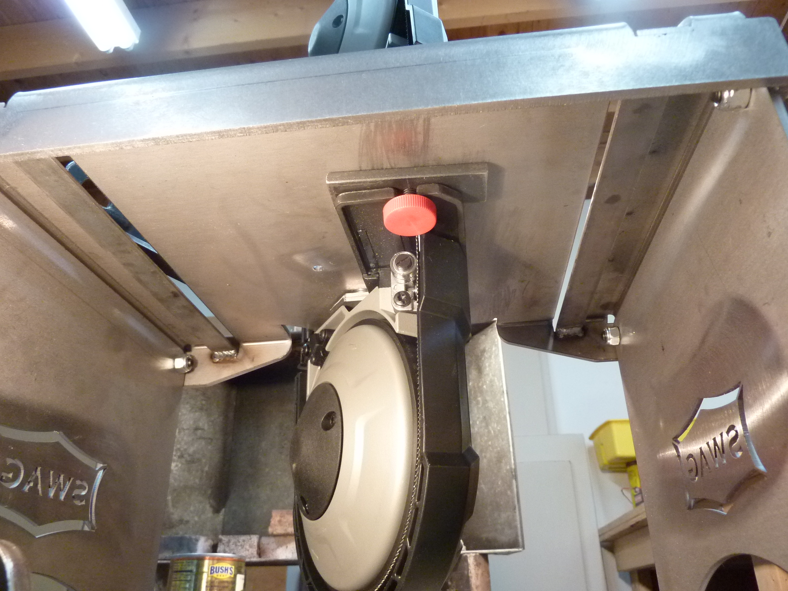

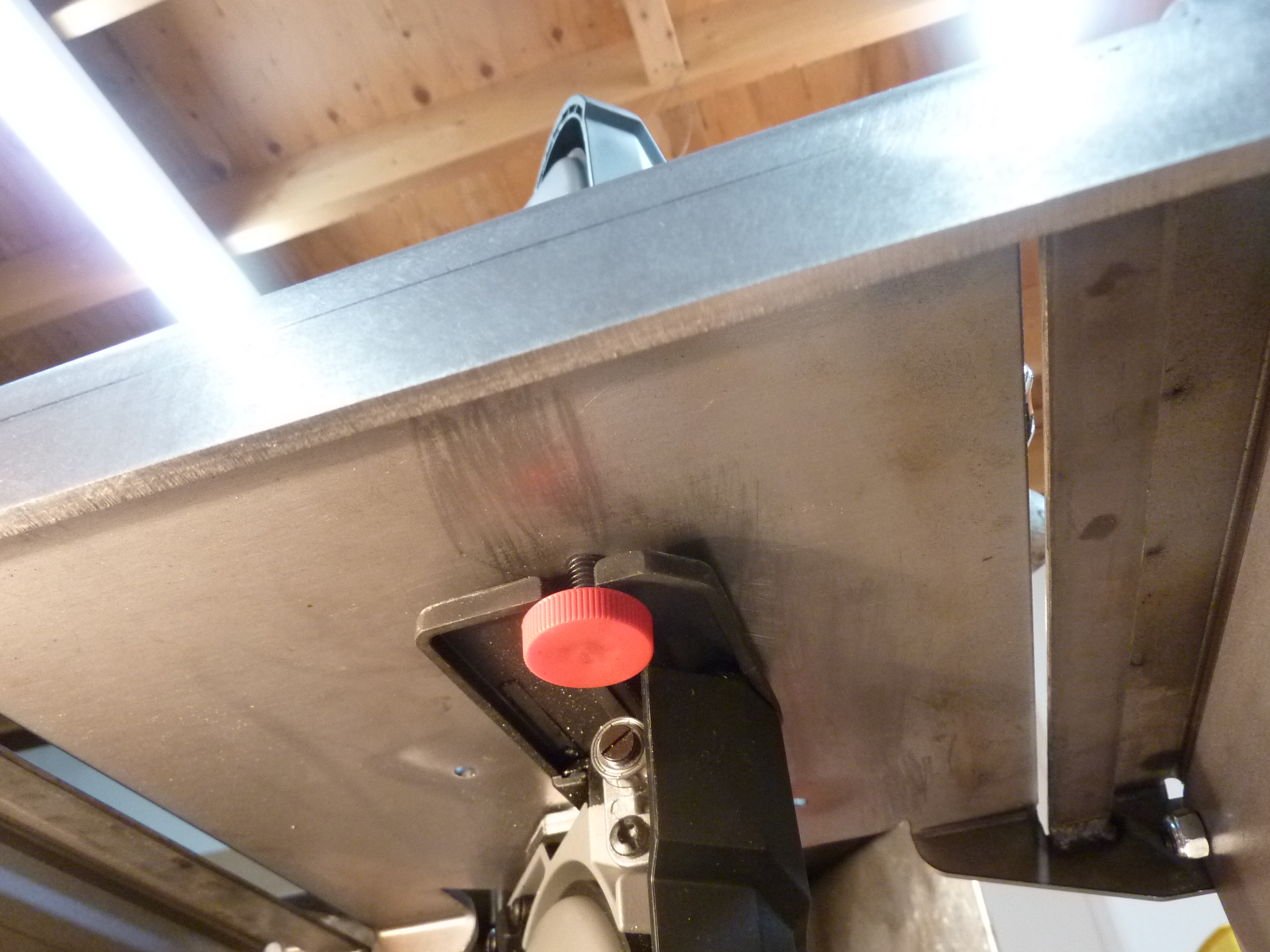

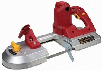

Received my Swag version 1.0 table Saturday but haven't installed it yet. I had to order version 1.0 as its only one that adapts to the older model portable band saw.
SWAG V1.0 Portaband Table
The table is very impressive and heavy. Haven't measured it yet but, probably 3/16" plate, maybe 1/4".

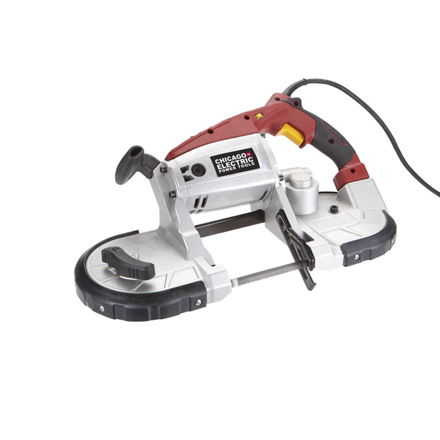

I would have like one with miter slots as on the version 3.0 but it only works on the latest HF portable BS.
SWAG V3.0 Portaband Table
I plant to build a base for it that bolts to the table.
More later.

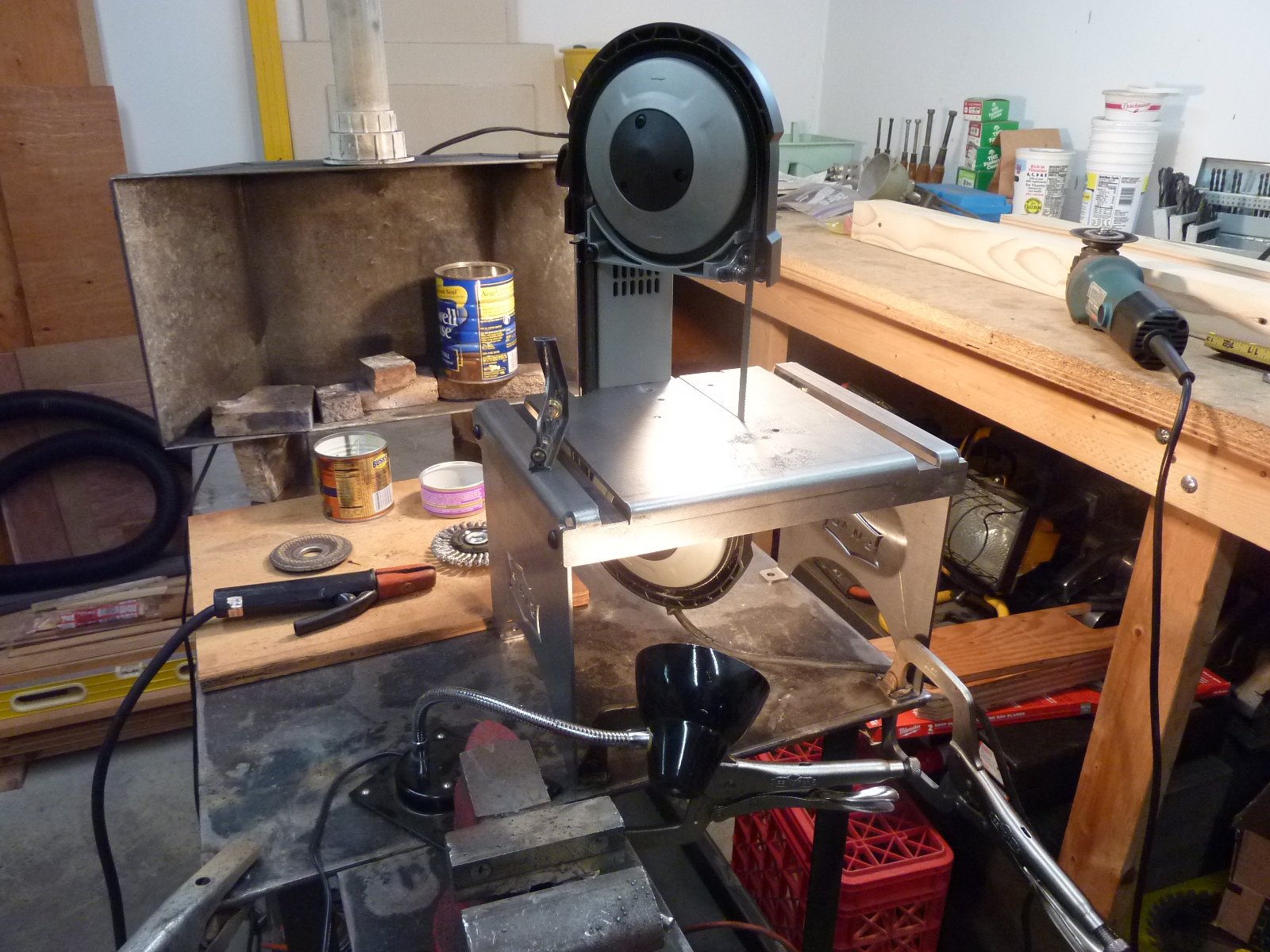

I know youll love the table. Opens up a whole new world for portabands. I never free hand mine anymore unless its some large piece that is too awkward to run through the PB mounted in its table.
Likewise... Most of my cutting is on relatively small parts and I much prefer two hands on the part vs two on the saw. Much more control IMO.

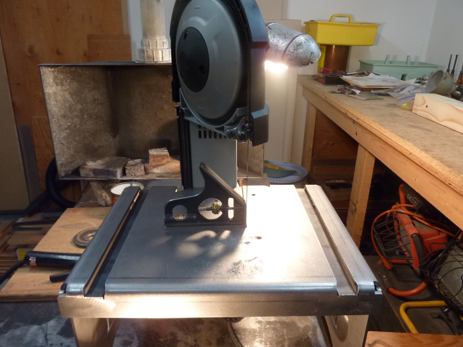

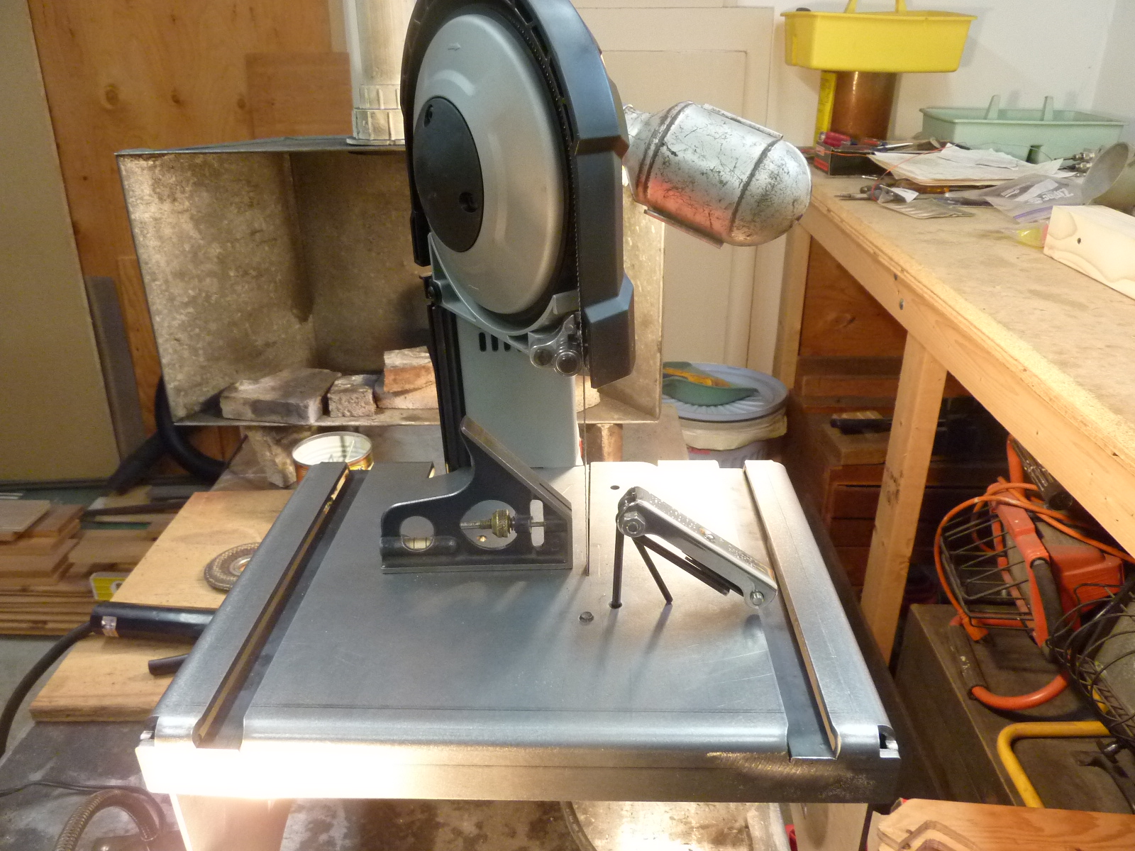

Just a update.
Here are a couple free hand cuts I made on some 1/2" mild plate 5"wide with a 10-14 TPI blade and a blade speed of about 285 SFPM. I am really happy with the saw and table.
