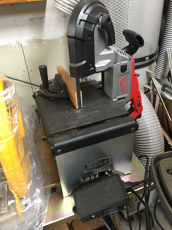

I just bought a Milwaukee PortAband and am seriously considering a Swag PortAband table for making straight cuts on smaller pieces. The reviews on them seem very good - to good to be true actually. All perfect, except for a past problem with the miter groove sizing. Can you guys confirm that these Swag tables are as good as the reviews that I see on the Swag site say they are?? Thanks

I have the Milwaukee Portaband and bought the SWAG table. Very good quality... no complaints... no issue with the miter groove. Easy to assemble and all fits together very well. I wouldn't hesitate. Get the optional foot pedal and put a spring clamp on the trigger. Makes life much easier.

I'm using a 14tpi blade for thin plate and bar stock up to 1/2in. I'm no expert though. Here is a pic of my SWAG table kind of tucked away at the moment. I use a couple different miter gauges on my table with no issue. Here is a pic with my wood-backed one sitting on the table from my Delta table saw. Notice the large well-made foot pedal as well... again, highly recommend this accessory otherwise you will be fiddling behind your blade for on/off.

The foot switch sounds like a good idea. I am thinking that I will have to rig up a power switch anyway since I will need a clamp of some sort on the saw variable speed trigger to hold it on. I might as well use the easy and convenient foot switch. Thanks for all the info on the table and blades everyone.
