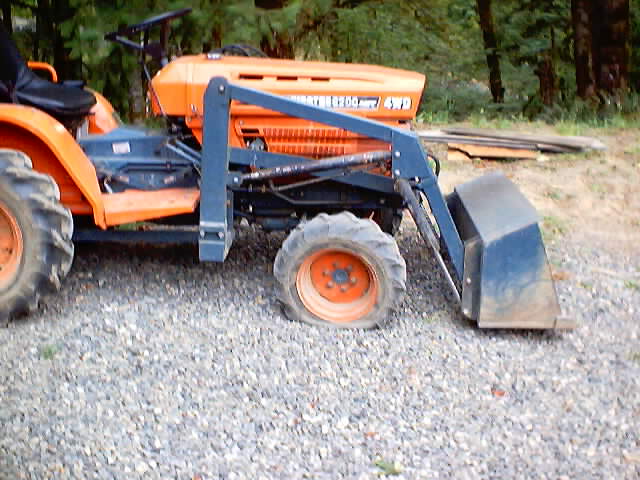

When I bought mine from a Kubota dealer (used) it was in for a hydro replacement. Otherwise, a new battery and this little misfortune (attachment) which I took a picture of while walking by with the new camera this morning.
