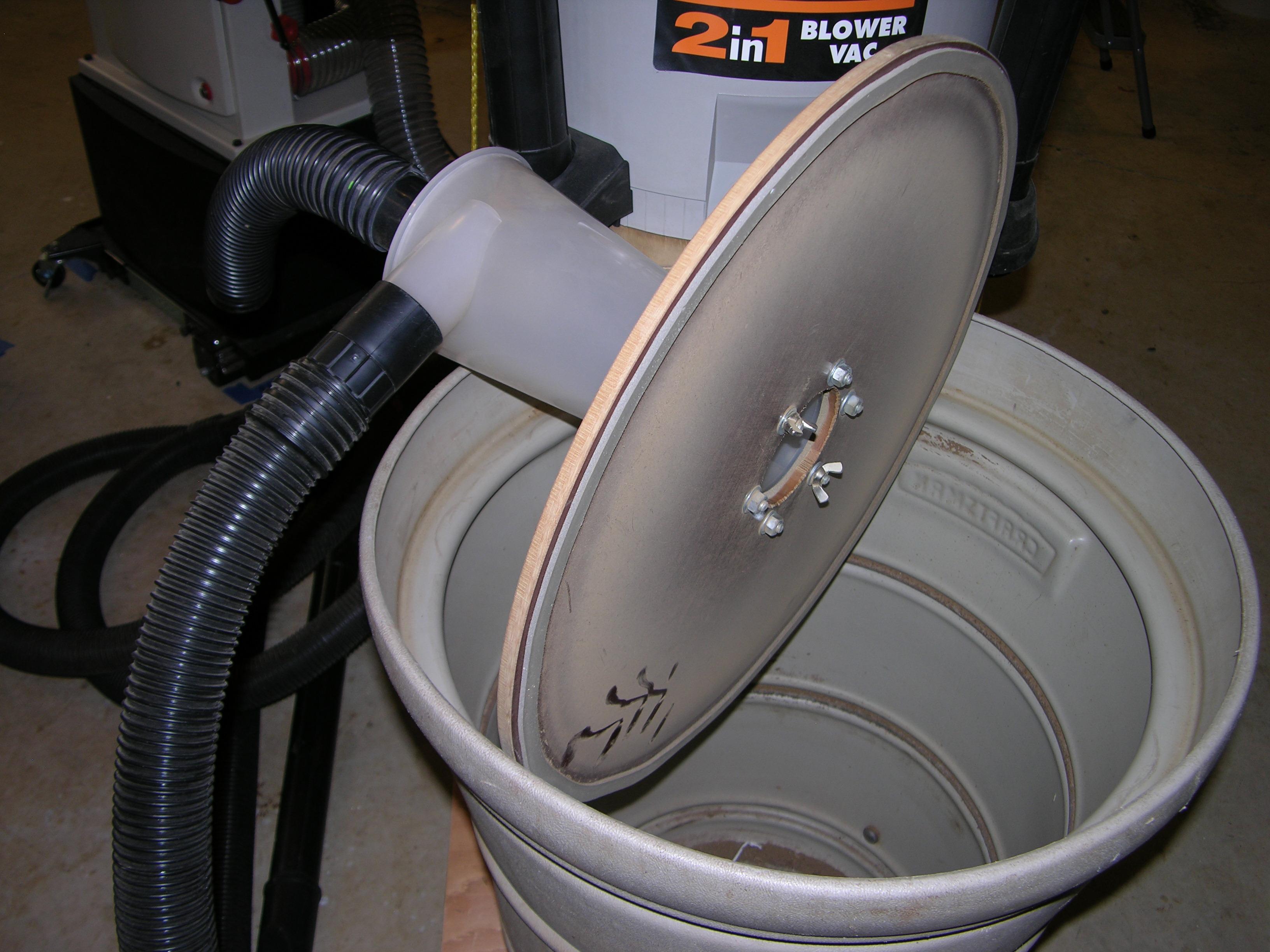

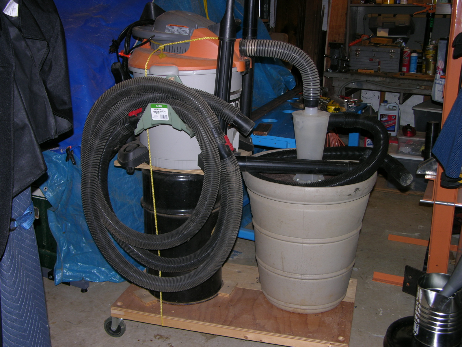

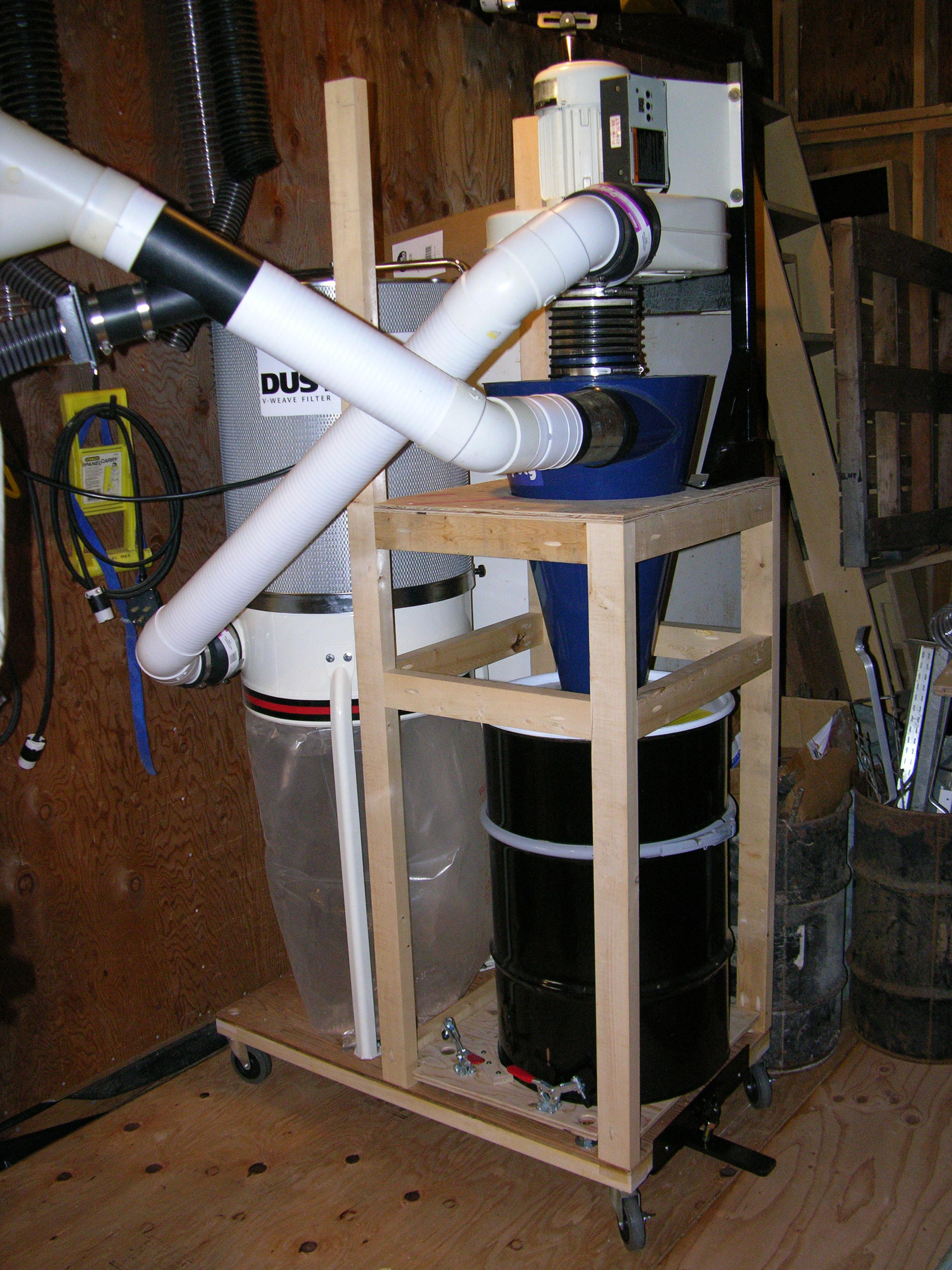

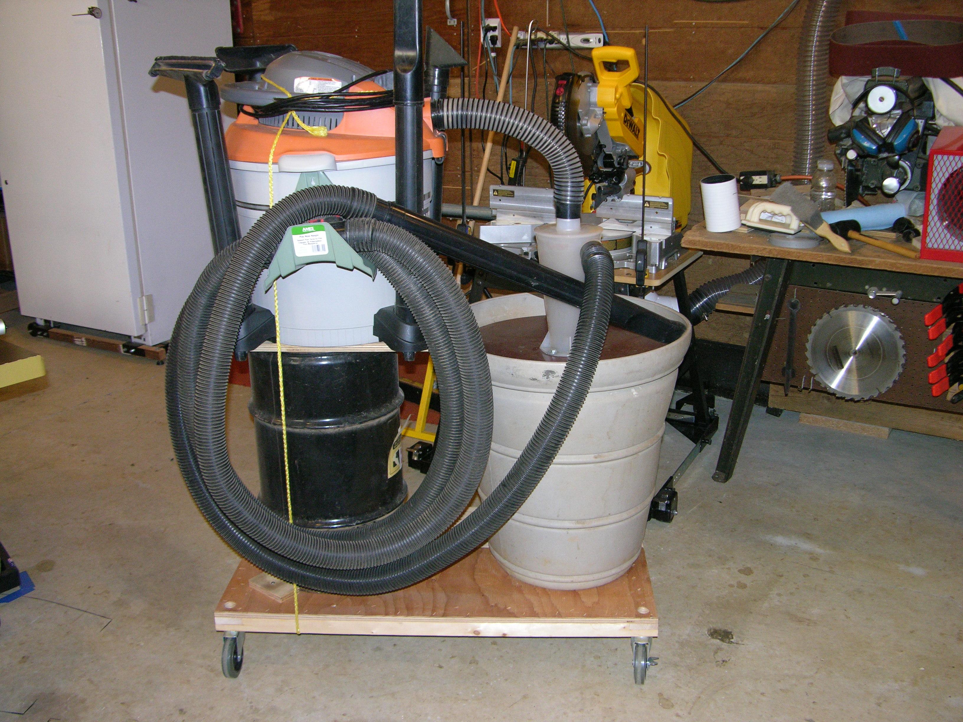

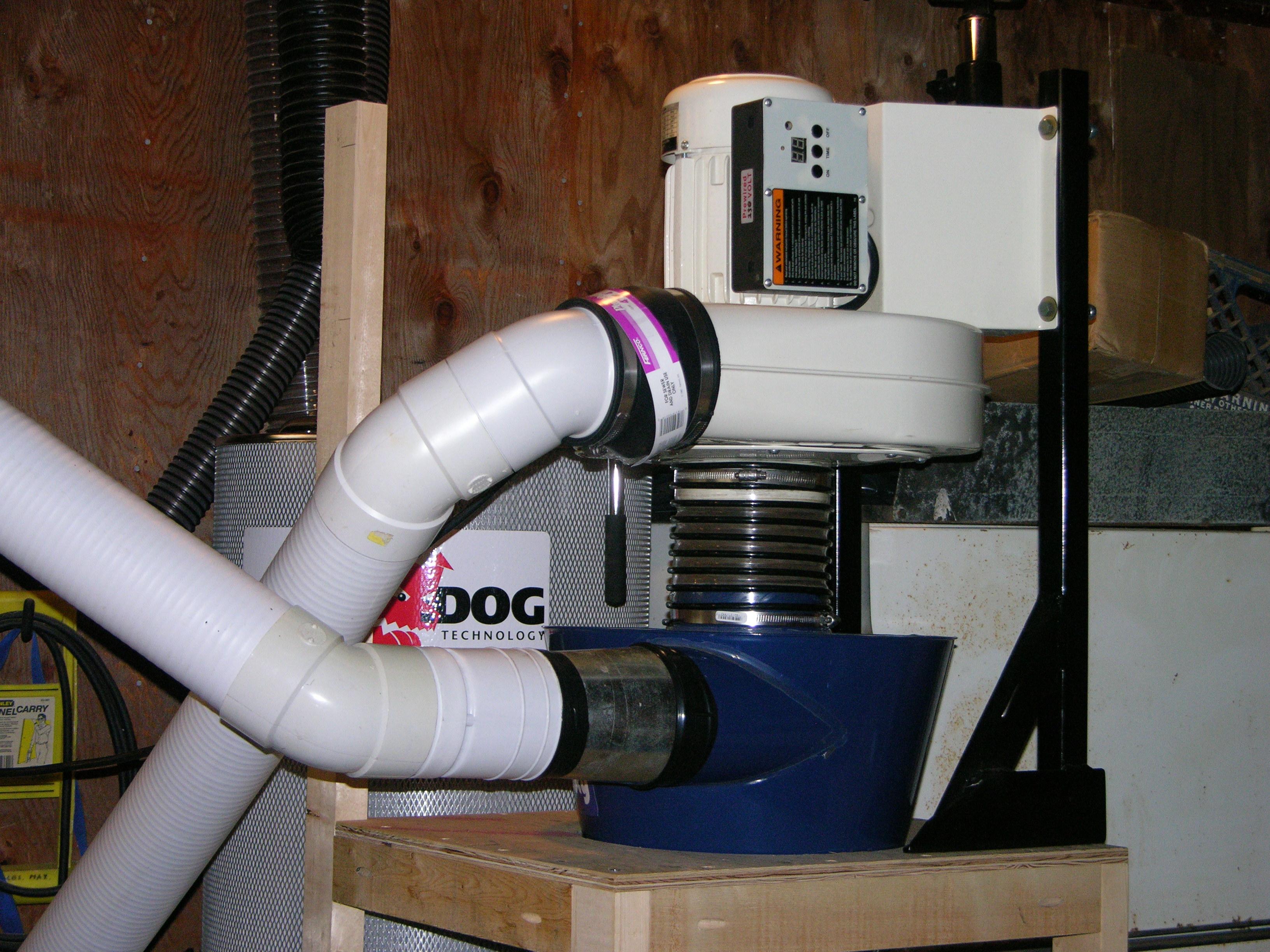

Another cyclone convert here, I have 2 of the plastic ones in service and a small steel one in (delayed) process for "grind shack" duty, plus I modded my Jet dust collector with their larger "super dust deputy" - I haven't changed a filter (or even LOOKED into either shop vac) in a few YEARS. I figure I'll KNOW when that's necessary when I DON'T have suction...
I did, however, learn one important caveat on the FIRST cyclone/shop vac - do NOT try to suck up styrofoam packing peanuts or you WILL be opening the vacuum itself :confused: - anything that has more surface area than mass is NOT your friend here...
I've looked at the HF cabinet for a blaster, but depending on circumstance I might just use a free diesel tank I got (about 200 gallons or more) - it's an oval tank so I'd probably cut it about in half leaving upper and lower "U-shaped" halves, grating in center, top hinged with gas shocks so I could load it with a fork lift without damaging the cabinet - (I may actually LIVE long enough to get to THAT project :rolleyes: )
Anyway, here's a few pics of the cyclones I'm using ATM; sorry for the "semi-hi-jack"... Steve

Wow Steve.... you have a cyclone arsenal! They do perform incredibly! Thanks for the tip on the styrofoam I can see how they wouldn't work so well in the 'storm'. :D
