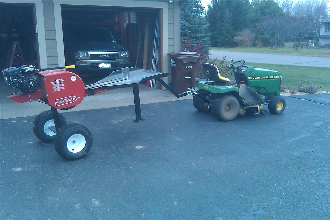

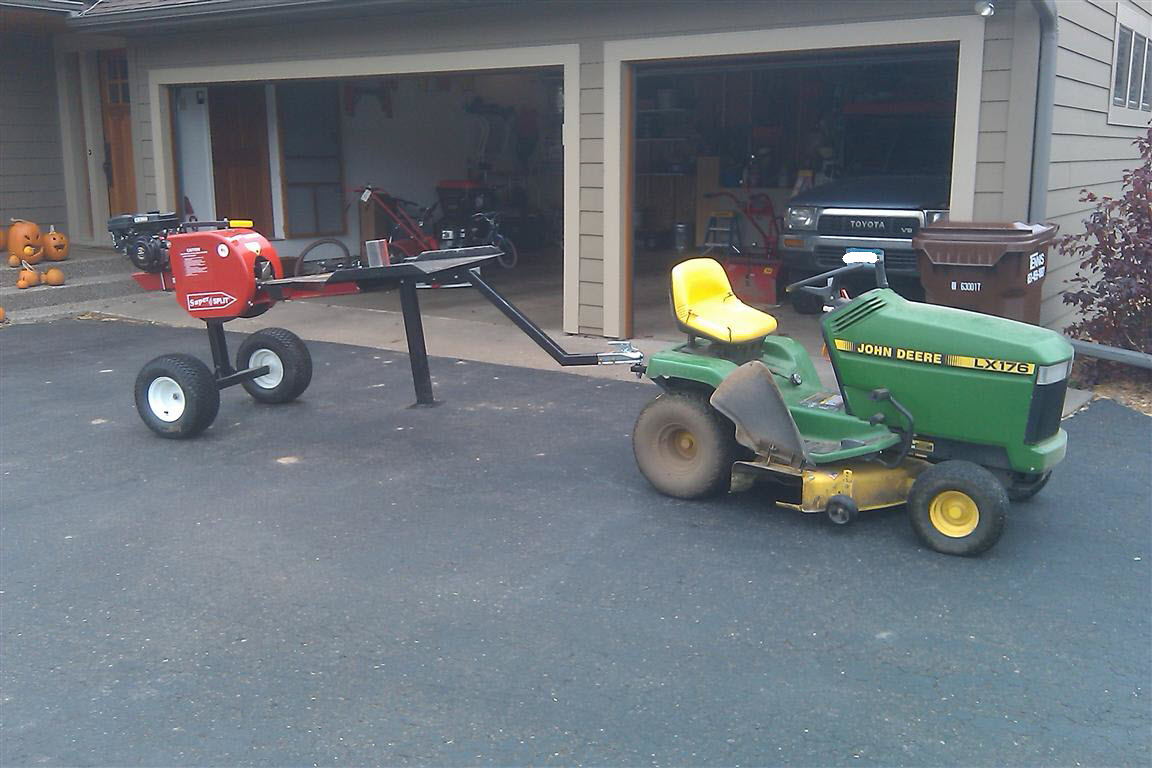

Here is a couple photos of the hitch I made for towing it around the yard.
