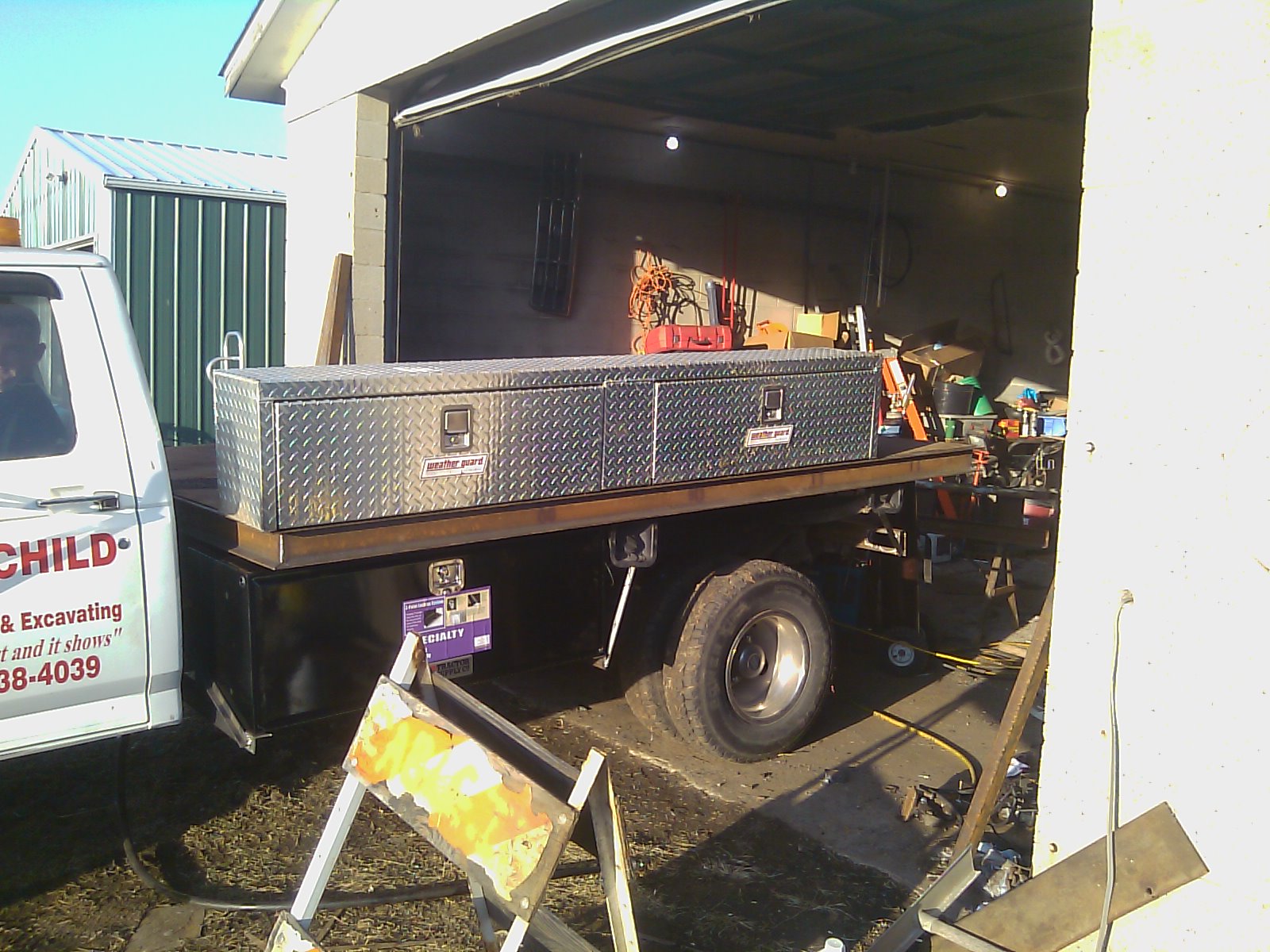

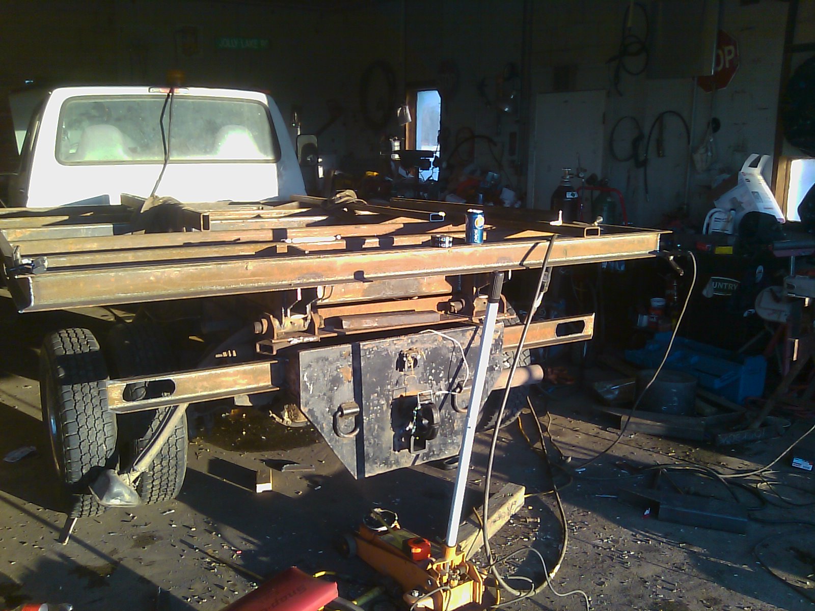

Well usually don't post till the project is finished but thought everyone on here would get a kick out of this.

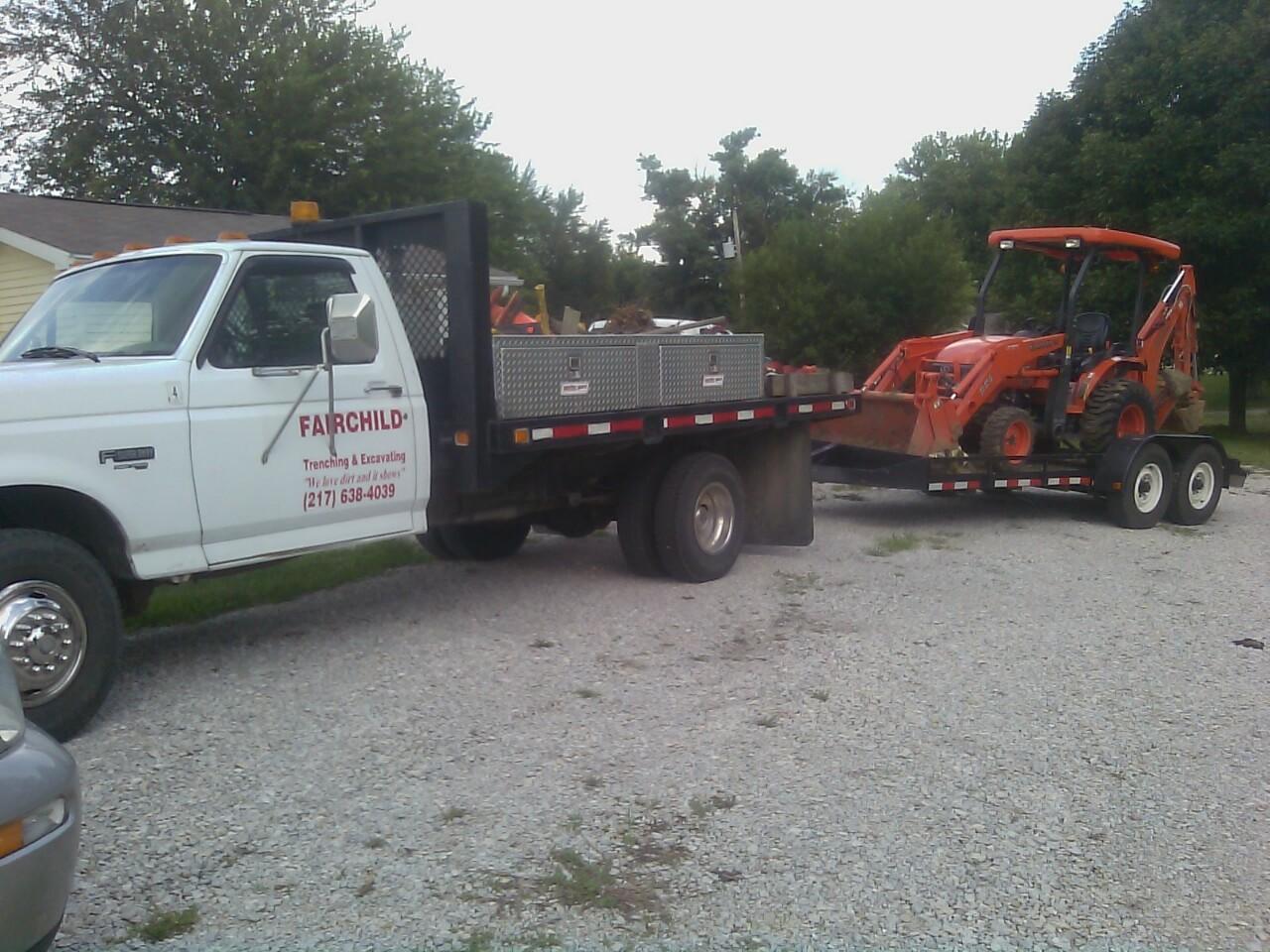

Started as a 97 superduty ief450 with a 12 foot flatbed with tool boxes on it.
Great truck but couldn't pull my gooseneck and I really needed a dump bed, and I had a pile of metal laying in the barn and a big cylinder lay next to it screaming build a dump.

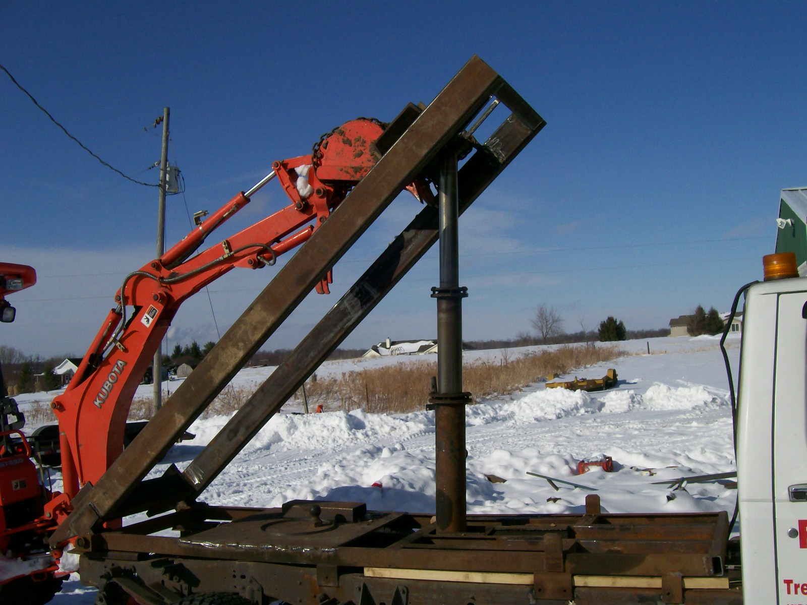

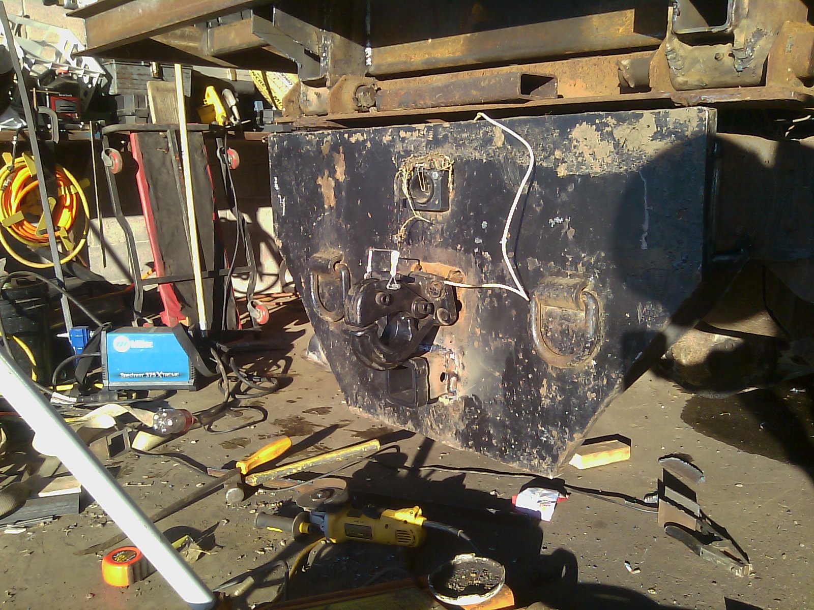

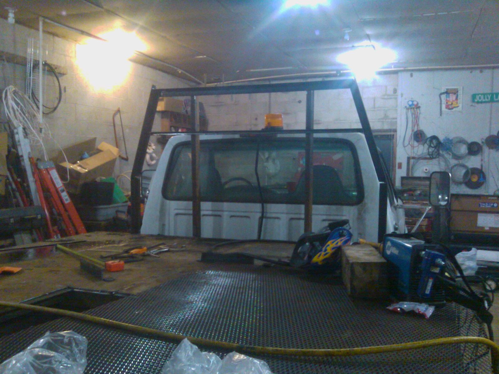

I dont have the all the photos on this computer but here is the before and where I am now and some in between shots.
New bed is 8 foot wide with 6 foot between toolboxes and 10 foot long. pretty much a service truck that dumps, most of the time will be used for hauling pea gravel or the clean up mess left over on a job sites. Not for daily trips hauling to the quarry.
Yes I know the tools in the boxes will slide to the end when it dumps I am putting dividers in the boxes for that and still better than using a shovel.

How does the bed height compare with a regular truck ? Are you able to use your gooseneck trailer with other trucks? Super nice build. Had a truck like this when working for a pipe line company , always finding uses for it on jobs.

The bed is actually about 1.5 inches lower than the flat bed I had on it. The cab to axle is 84 inches and I had to cut about 2.5 foot off the back of the frame so I could get the gooseneck to clear the back and keep the gooseneck ball about 6 inches in front of the axle. With the tool box on the side I will be about 2 inches higher than my other trucks with a regular bed on it. Most of the time it will have a pintle hitch trailer on it but I wanted to be able to use the gooseneck if needed.
The cylinder force my math says if it wont dump it its way overloaded. As I have a 5 inch 1st stage and 3 or 2.5 second. The most that should be on the truck is about 6,500lbs to stay in side of max gvw 15,600. Which only about half of that is what the cylinder needs to lift due to being at the front so it really over built, but figured some day may put the bed on something bigger.
Using a 12v pump and it takes about a minute to go up and a little longer to go down. Reason I used what I did is it was I didn't want to spend much on it so just used what was laying around.
Hope to have it ready for paint in next week or two.

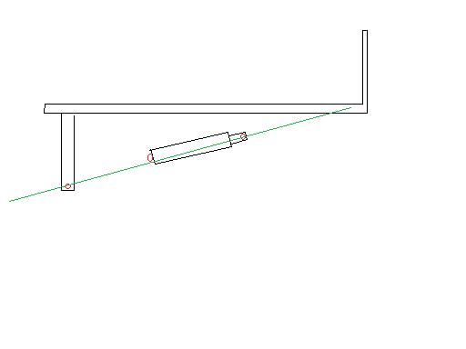

You are half right.
Assuming the bed is level AND the rear pivot of the bed is on that same "level" plane, the vertical componet acting on the bed IS indeed 15/36 of the total force.
BUT since the rear bed pivot is BELOW this plane, the resulting "effective" angle of the bed that the cylinder is pushing on is a line drawn between the rear pivot and the cylinder mount-bed pivot.
So what you have is a cylinder mounted at ~24* angle pushing on a bed that is level on the top, in reality is actually ~ 10* angle.
Se my attached crappy paint drawing.
The angle needed to be used is the angle from the green "imaginary" line to the cylinder. And NOT the angle from the cylinder to the bed.
This will give the vertical lift at THAT point. But then theres the whole issue of how far forward on the bed the cylinder is mounted in relation to the rear pivot and CL of the bed itself. If the bed is 100" long for example, and the cylinder is hooked @ 50", the dump capacity would simply be the SIN of the angle mentioned above x the cylinder force. BUT if the cylinder is mounted farther forward of the rear pivot, like at 60", this increases the capacity by 6/5ths. And if farther back, it reduces capacity.

I think what we both admit is that I've only answered half the question. Keep in mind that I'm considering that there are two parts to the question.
1) How much force can the ram exert in a vertical direction?
2) How much vertical force is required to begin dumping the bed?
If the answer to question 1 is bigger than the answer to question 2 the project is a success and everyone is happy. If not, then some re-engineering needs to happen.
I disagree. The angle needed is actually the angle of the cylinder relative to gravity. That's why your mention of the level bed is so important.
The relation between the bed pivot and the upper ram pin may come into play when determining how much force is needed to begin dumping the bed (question 2), but the vertical force of the ram is only affected by the elevation of the bottom relative to the top as compared to the length of the ram itself. An example of this is if you dropped the bottom of the ram by 19" your ram would be straight up and down. Without changing the angle represented by the green line, you'd have substantially changed the amount of vertical force acting on the bed.
Now we're talking answers to question 2 from above. I agree with you completely here. The further forward on the bed you get, the less force is needed from the ram to get the bed to start moving. I'm still trying to find a way to calculate the force needed to raise a dump bed. I'm sure the result is going to be expressed in foot-pounds as it's a rotational force. It's going to depend on the length of the bed, the location of the bed pivot, and the location of the upper ram pin.

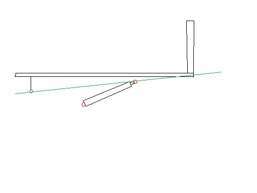

But I am still in disagreement with you, sort of. While the angle of the cylinder may indicate "true" vertical force, using that "true" vertical force of ~20000lbs you calculated earlier would assume that the bed is level. BUT the effective angle of the bed is the "green" line. So that "true" vertical component can only be used if the green line is horizintal. (IE: the rear pivot and the cylinder-bed pivot are equal distances below the bed.
To illustrate my point, lets exaggerate a bit. Lets say the cylinder is mounted on a 10* angle and the rear pivot were dropped down REALLY low to create say a 12* "green" line. IE moving the base of the cylinder above the "green" line. The vertical component would still be 17% of the 49000lbs of avaliable force, or about 8000lbs. But what would really happed???? SEE another crappy drawing.
Agreed. In an extreme example, you can extend the bed pivot down ten feet at which point you're no longer lifting the front of the bed up with the cylinder, but you're moving the bed to the left. You've changed the direction of movement relative the the force of gravity. The point being that the position of the rear bed pivot is going to significantly affect the amount of force needed to make the bed move. Eventually you come down to some combination of bed pivot location and ram angle and location.
You're right that by moving the bed pivot you change the force needed. I'm right that by changing the angle of the ram I change the force available. In both cases the ratio of force needed to force available is changed. It's amazing how complex a dump truck becomes when we allow each other to pick it apart like this. I think the discussion is productive, though.
Every discussion of dump beds seems to come down to some fuzzy S.W.A.G. stuff, and eventually trial and error. I can't get any better. It would be nice to have some equation that a guy could plug a few numbers into and know that it's going to take X ft.lbs. of torque to dump powerstroke444e's truck when it's loaded to capacity. Then it's a matter of figuring how many feet away from the pivot the ram has to be and how steep of an angle to get the right amount of dumping force. I've done some head scratching since my last post, and I've figured it's going to have something to do with the linear mass density of a loaded bed and will likely require some calculus. That's why I haven't figured it out yet.
Sorry powerstroke for hijacking your thread. I think we all agree that your ram is at least big enough to dump your truck. We're just trying to figure it out systematically so that someone down the road can review this thread and have all the answers. In any case, keep the pictures and progress updates coming. I'd love to see how you rigged the baffles in your toolboxes.
