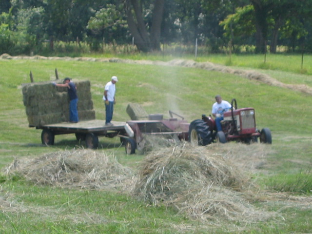

For what you are doing on light wind rows and flat ground you have a good match. We use a 606 Farmall with loaded tires and have had it push the tractor down a hill if the wagon is too full. Horse power is usually not a problem unless the hay is real heavy but traction can be a problem. The picture is on some of the flat ground we bale. It sure makes good hay.
Sure is a sharp tractor...
