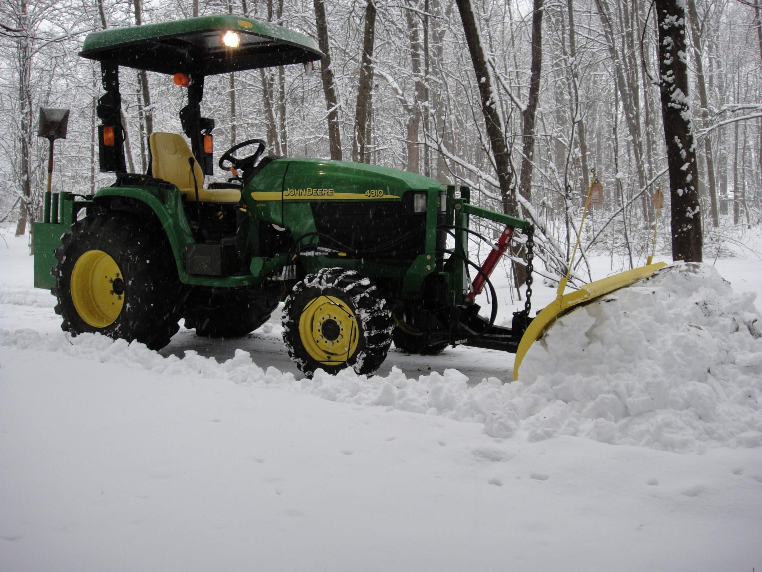

I can't comment on the kub model but I have one on my JD and wouldn't be without it. For me it's more of a rain and snow shade.
I have caught it on obstacles but no serious damage, the only downside is it makes the tractor sound significantly loader.
JB

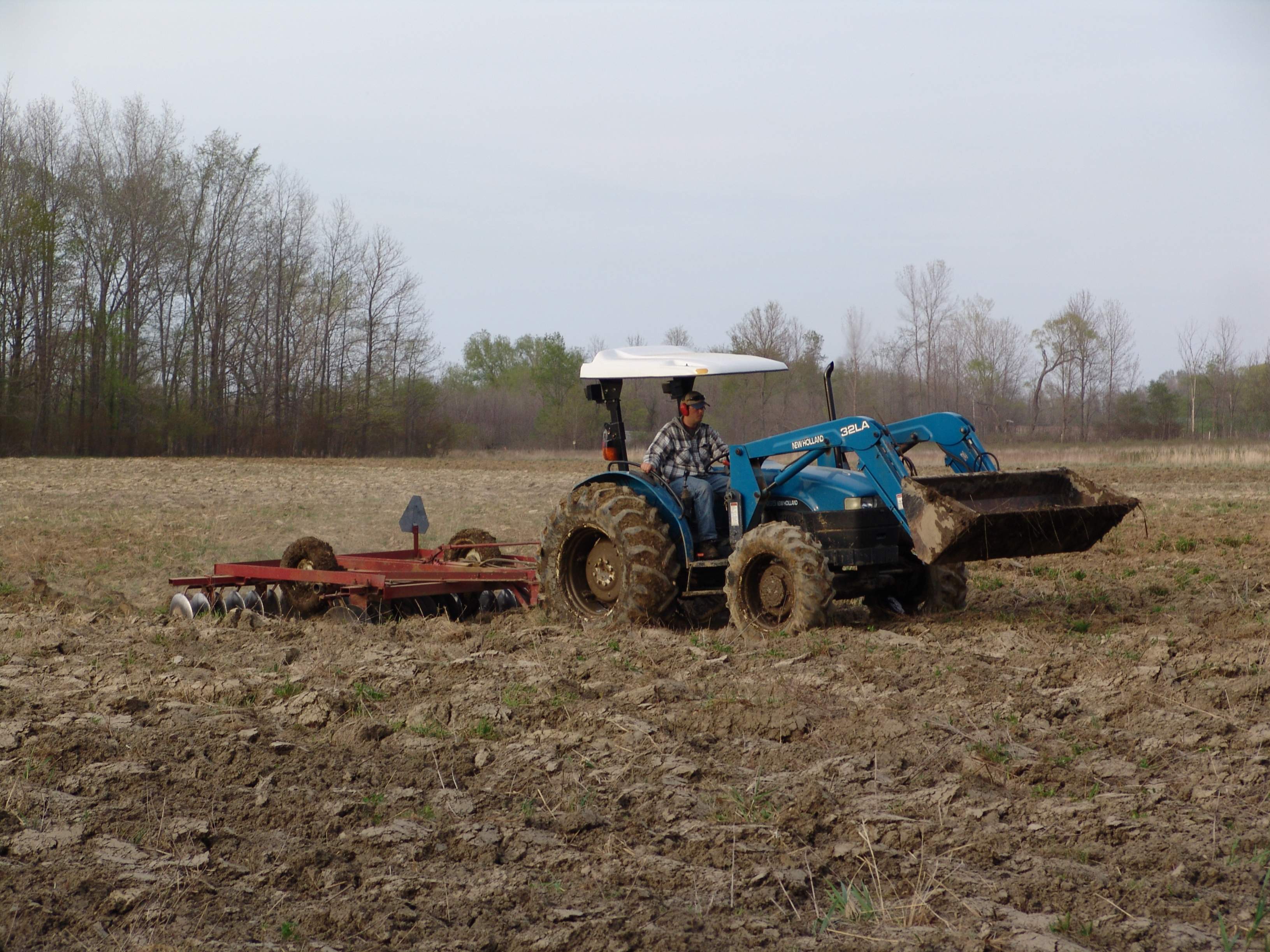

Here is my TN with the canopy on it.

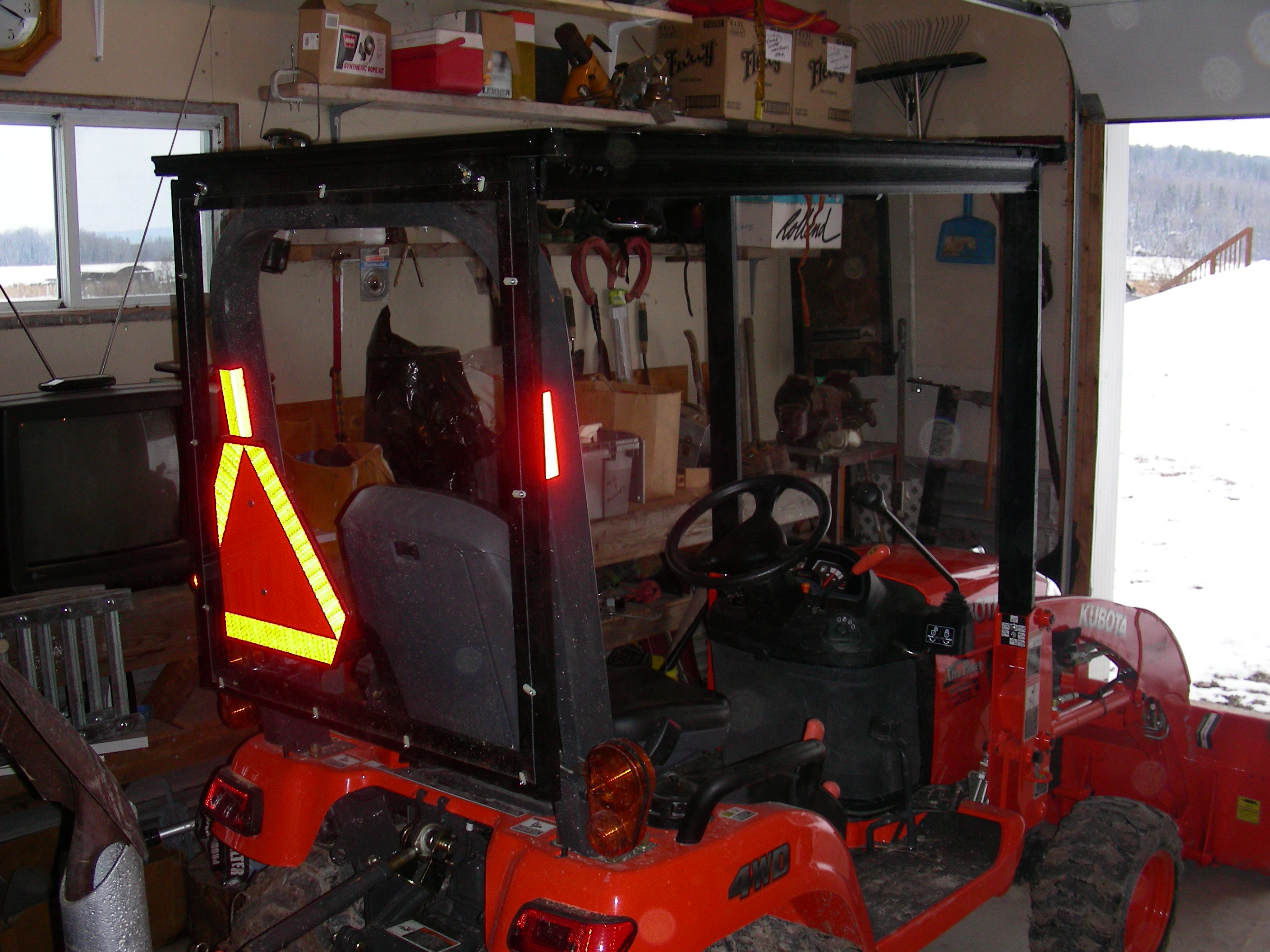

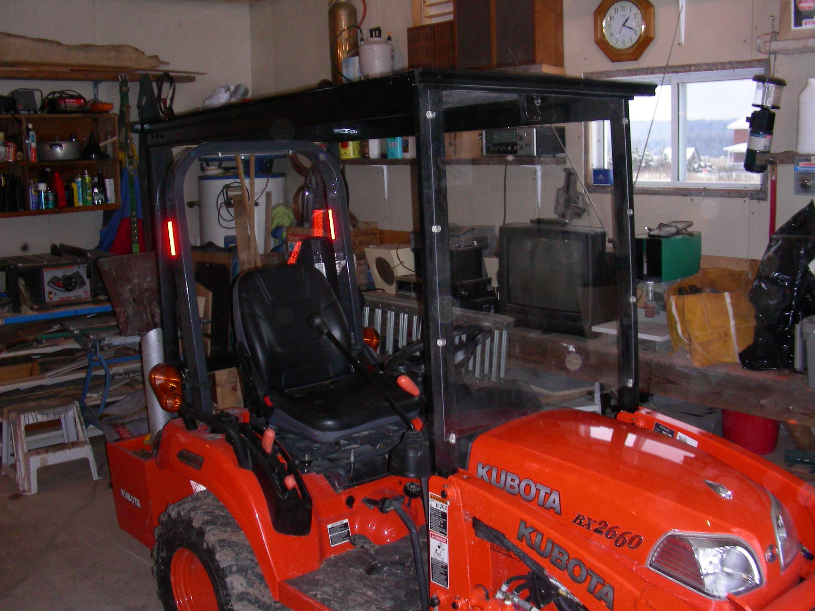

I made one for my BX2660 for under $100 out of wood and spare sheet metal.
If you are not worried about the safety police, you just drill two quarter inch holes thru the top of your ROPS bolt a 2 x4 or in my case a spare piece of 3 x 3 maple slightly wider than ROPS , then you can hang anything you want from there if roof is light weight, or if you want a windshield or if you want to support the front of the roof, you will find that a three quarter inch thick board when cut to correct width will fit into the slot where your FEL mounts (see my pic) then join ROPs to uprights with two horizontal boards (I used some maple trim 3 inch wide , screw it all together with some simple angle brackets. paint it black......... ta da
After I made up rights and roof work so easy I figured why not have windshield made of plexiglass fit in between and hey I can hang one from the back too.
I leave them on summer and winter to keep me out of rain and sun. Lasted almost three years now.
