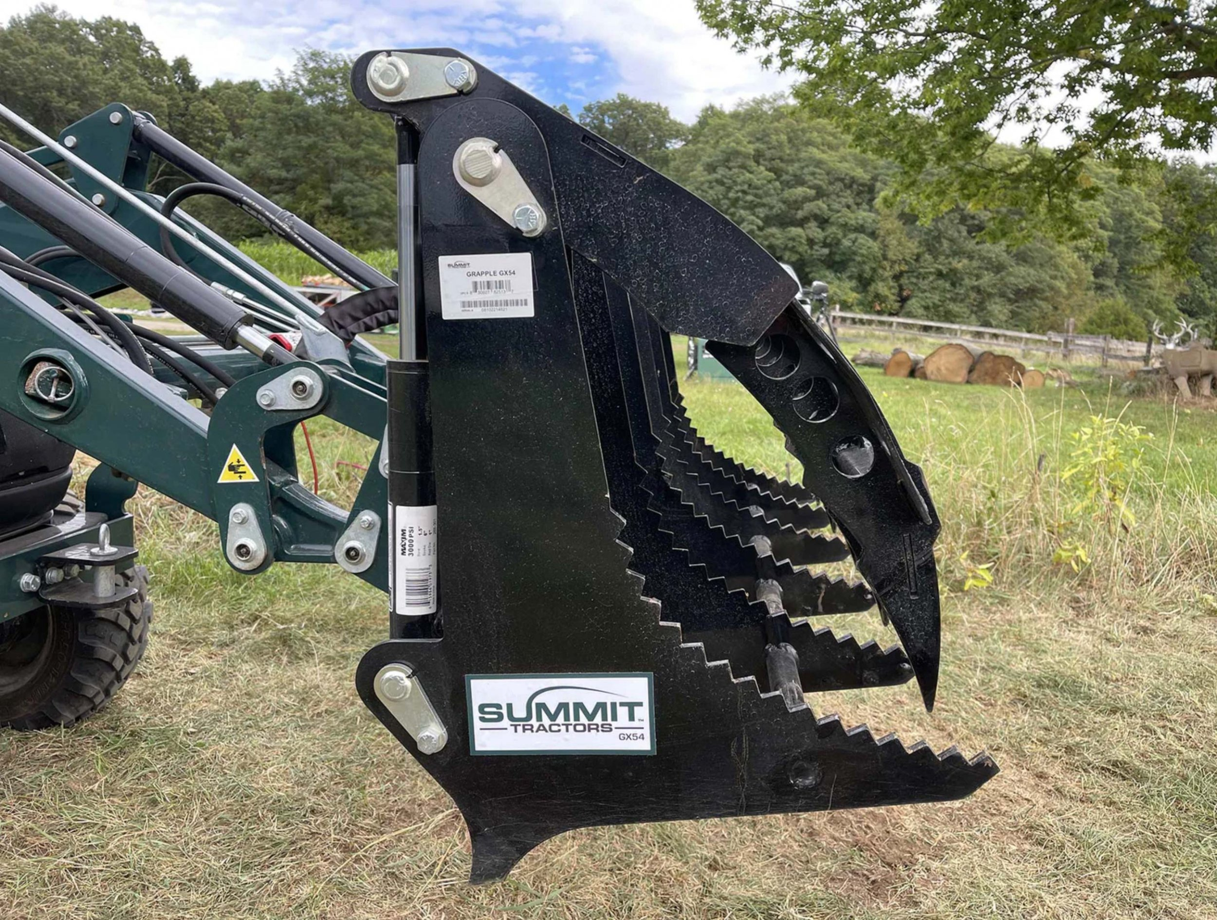

That's a prety odd tooth profile on the bottom.

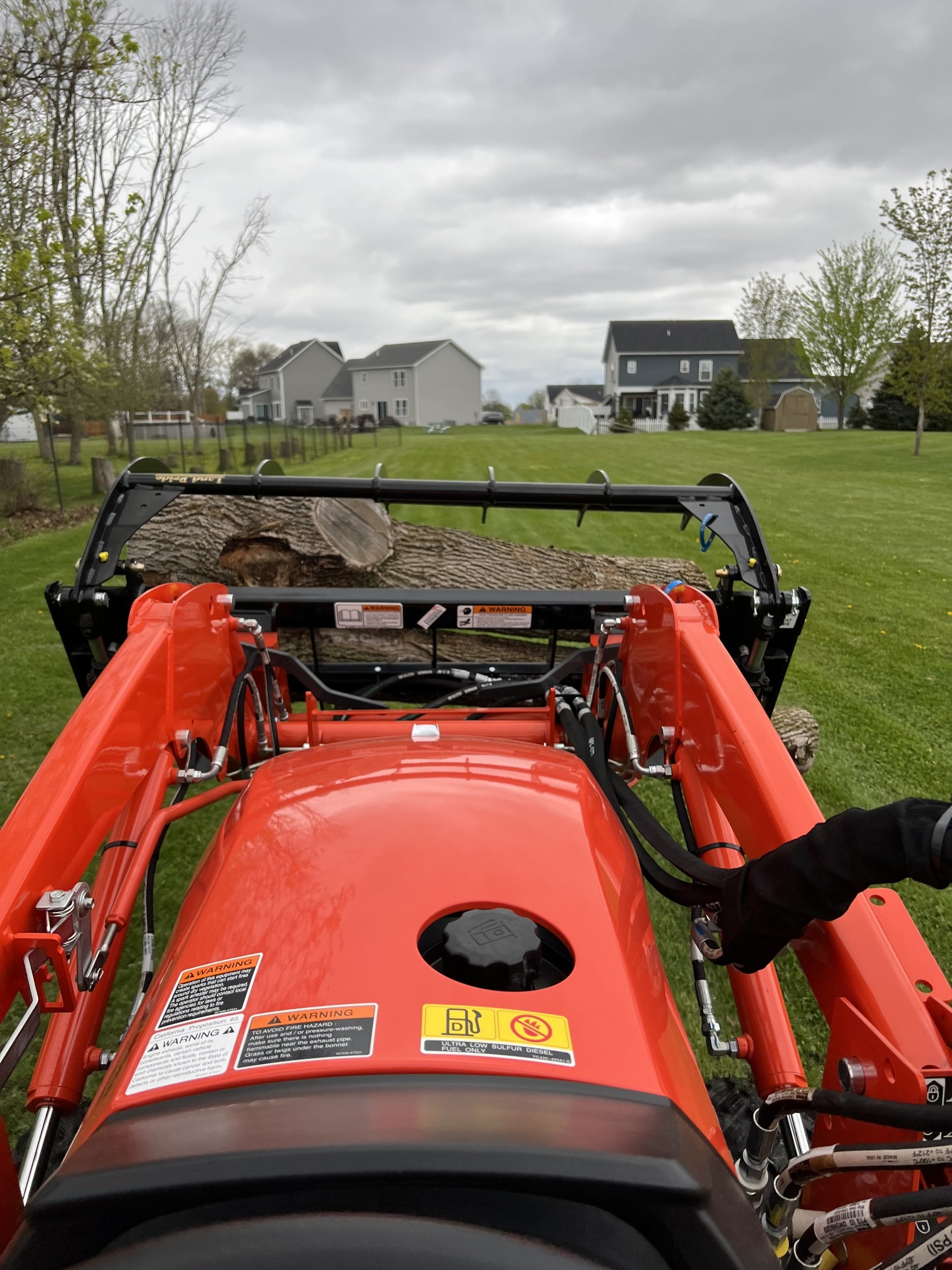

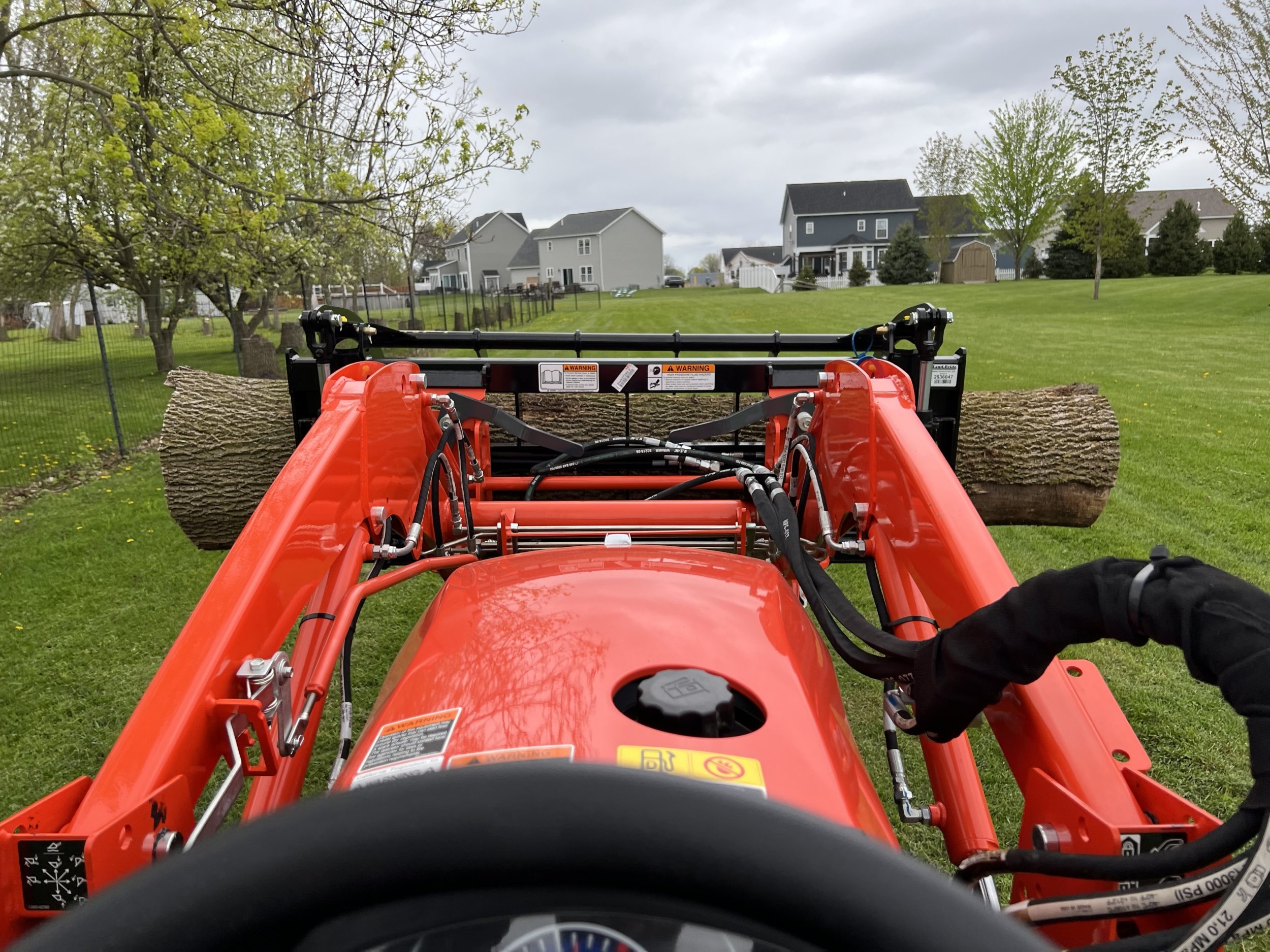

Seems in line with most lightweight grapples. I have found a couple in the 200lb range, but there are lots of good options that weigh in right at 250lb or so. My landpride grapple weighs 250 and I can still lift a decent amount. Not sure how heavy some of these logs are, but they were noticably heavy, and I can't move them on my own without leverage and even then I'm not lifting them.
