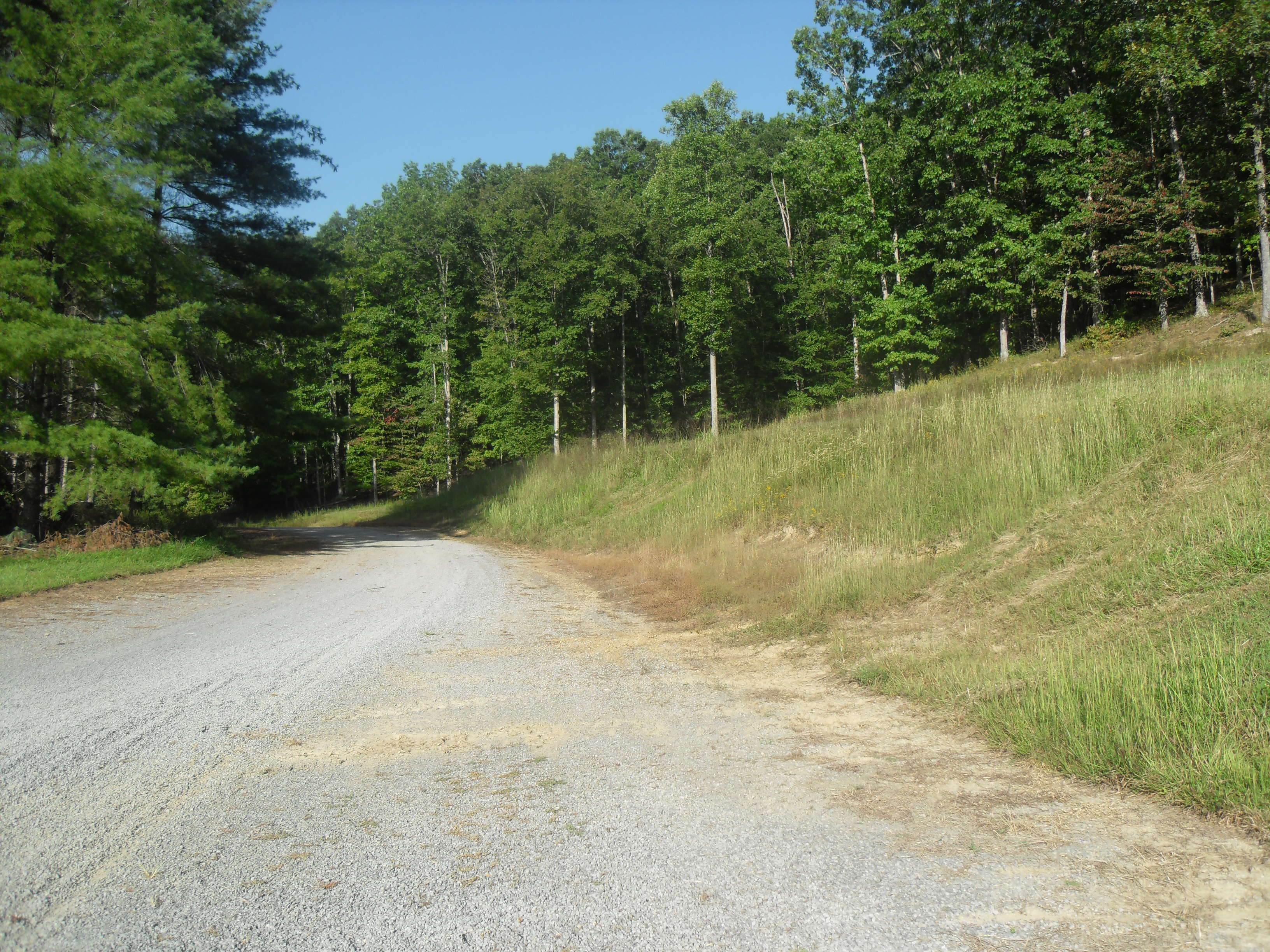

to CADplans- If I could alter the side of the drive as you did I would do that. I believe my drop is just too much. If you can see from the attached picture I can make two passes with the bushhog at the treeline, that part is doable. But any closer to the driveway is really unsafe. One year a neighbor cut from where I had bushhoged down towards the drive. I doubt he felt very safe doing that and he has since moved. I would be happy getting a neighbor to make just one pass "up" from the drive, we could weedeat the rest. My hayman says his mower will not cut "up" at that angle, though he can cut downward. His mower is a Kuhn, which he really likes but he says it shuts off if the up angle is too much.
to Richard- flexwing mower. I will check into that. I had offered to my hayman to purchase a cutter just used along my driveway and possibly along the creek, and leave the mower here, he could mow once or twice a year. He has not given me any feedback one way or the other. I suppose he really does not need more work. SDC10844.JPGSDC10844.JPG

It looks like there’s another road above the driveway. But if there’s enough room between them cutting the hill to make it less steep wouldn’t be very hard.

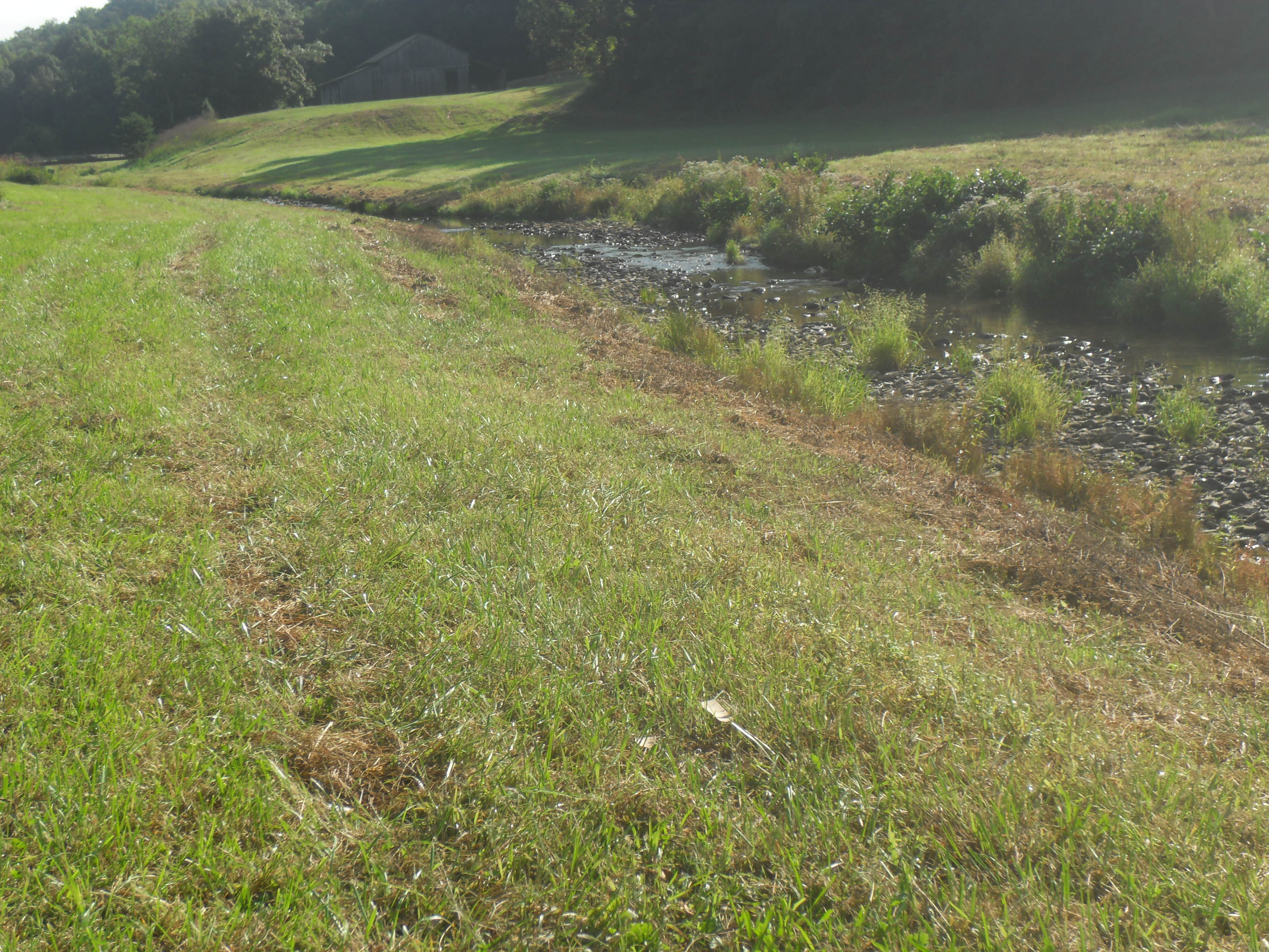

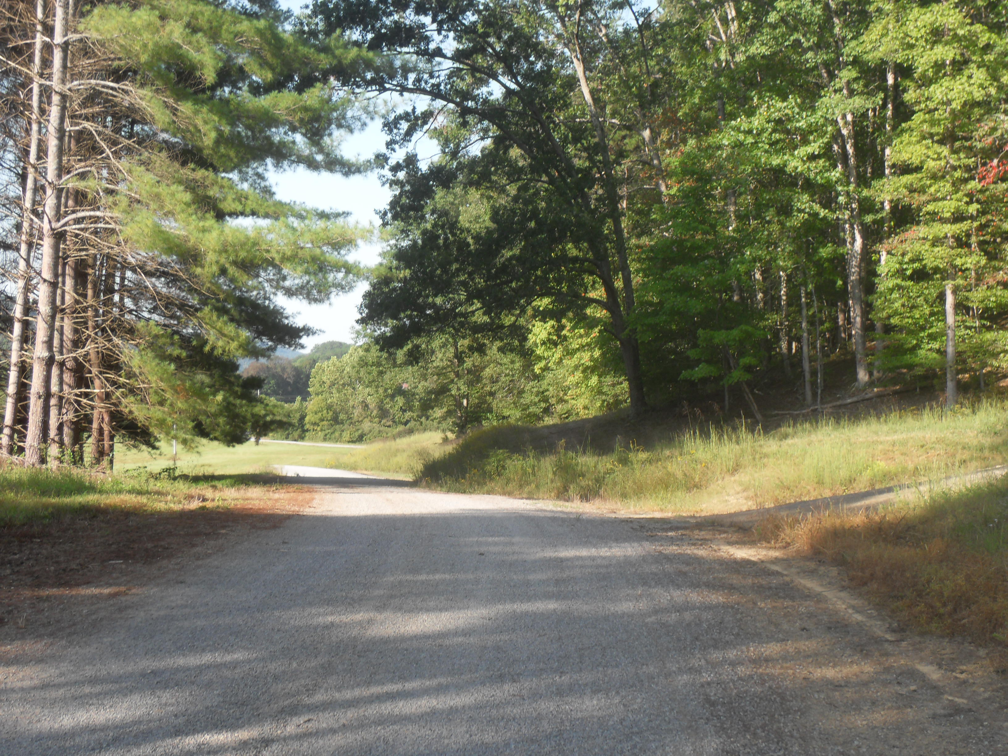

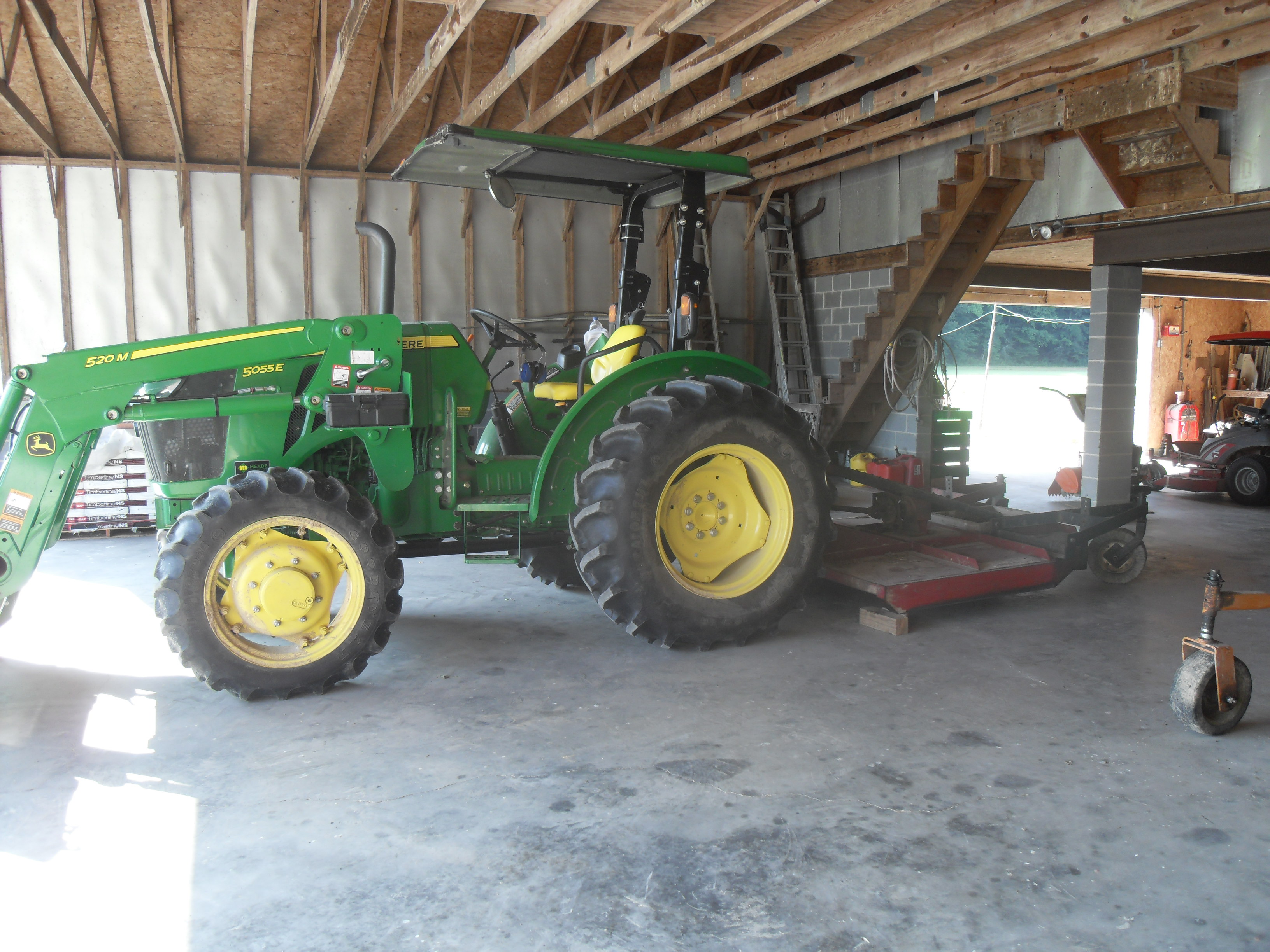

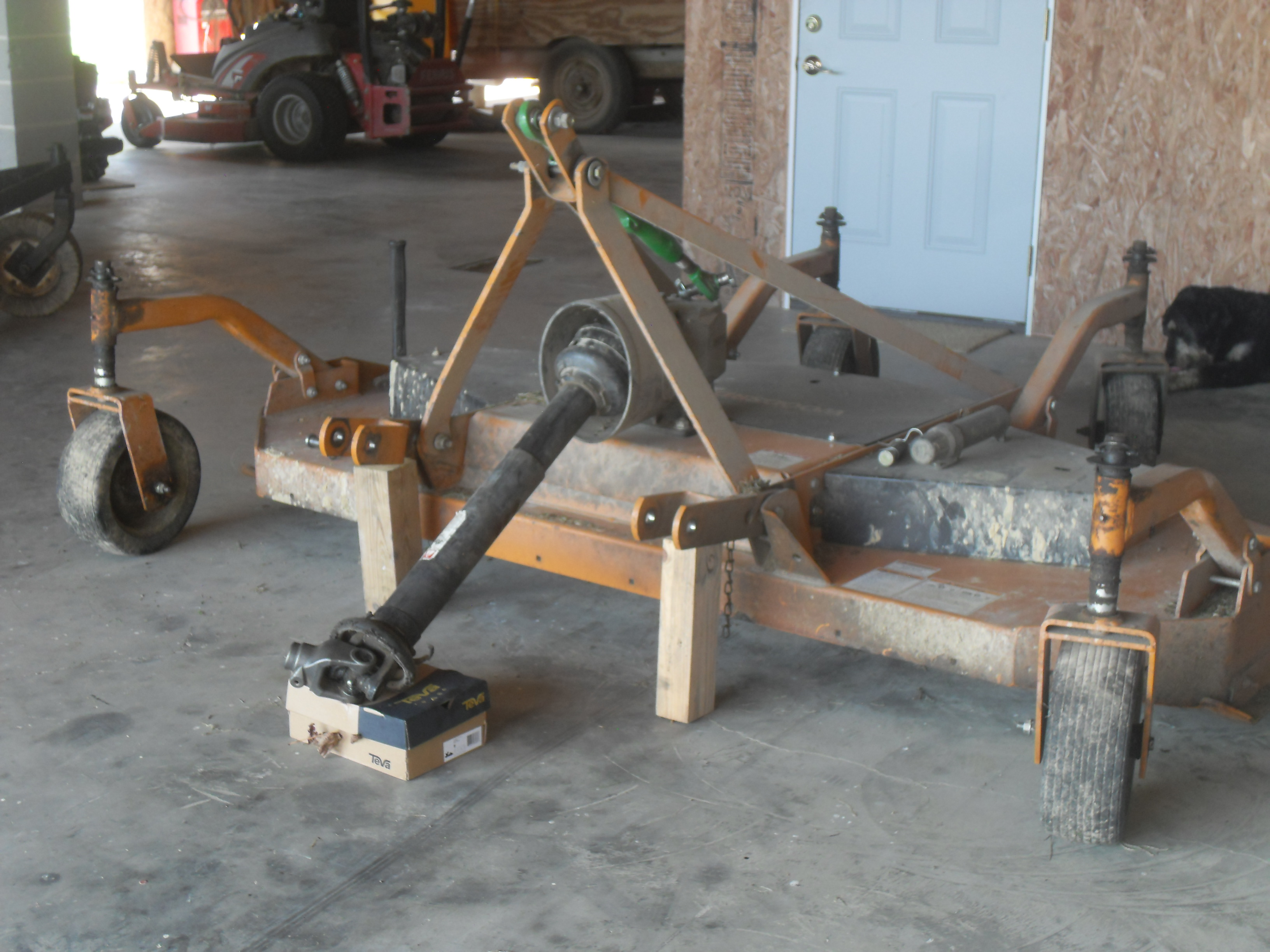

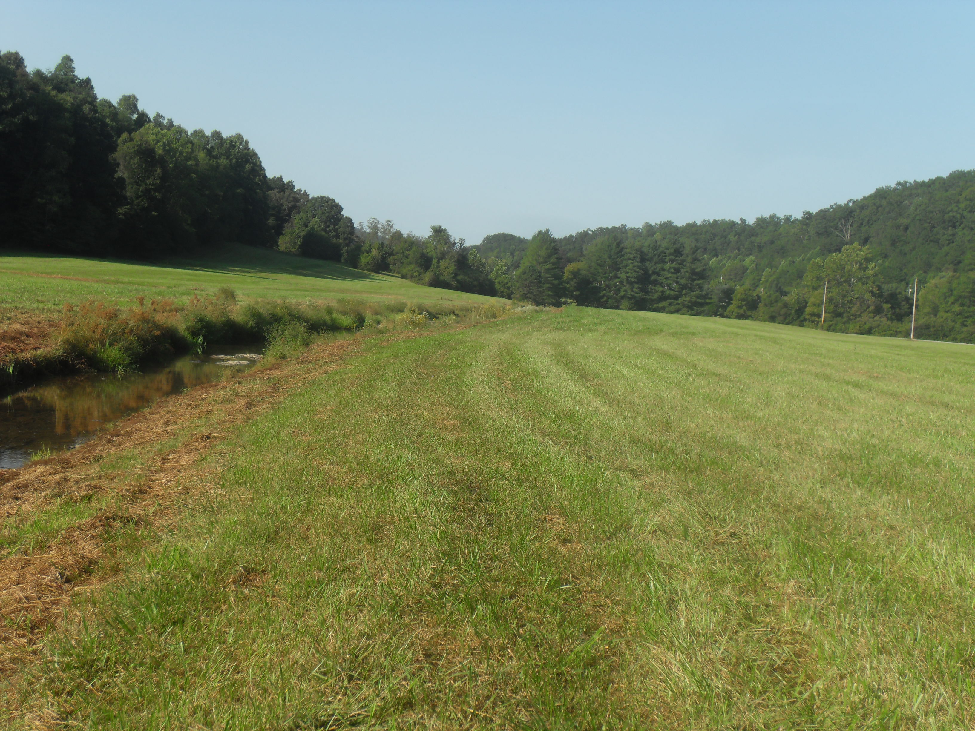

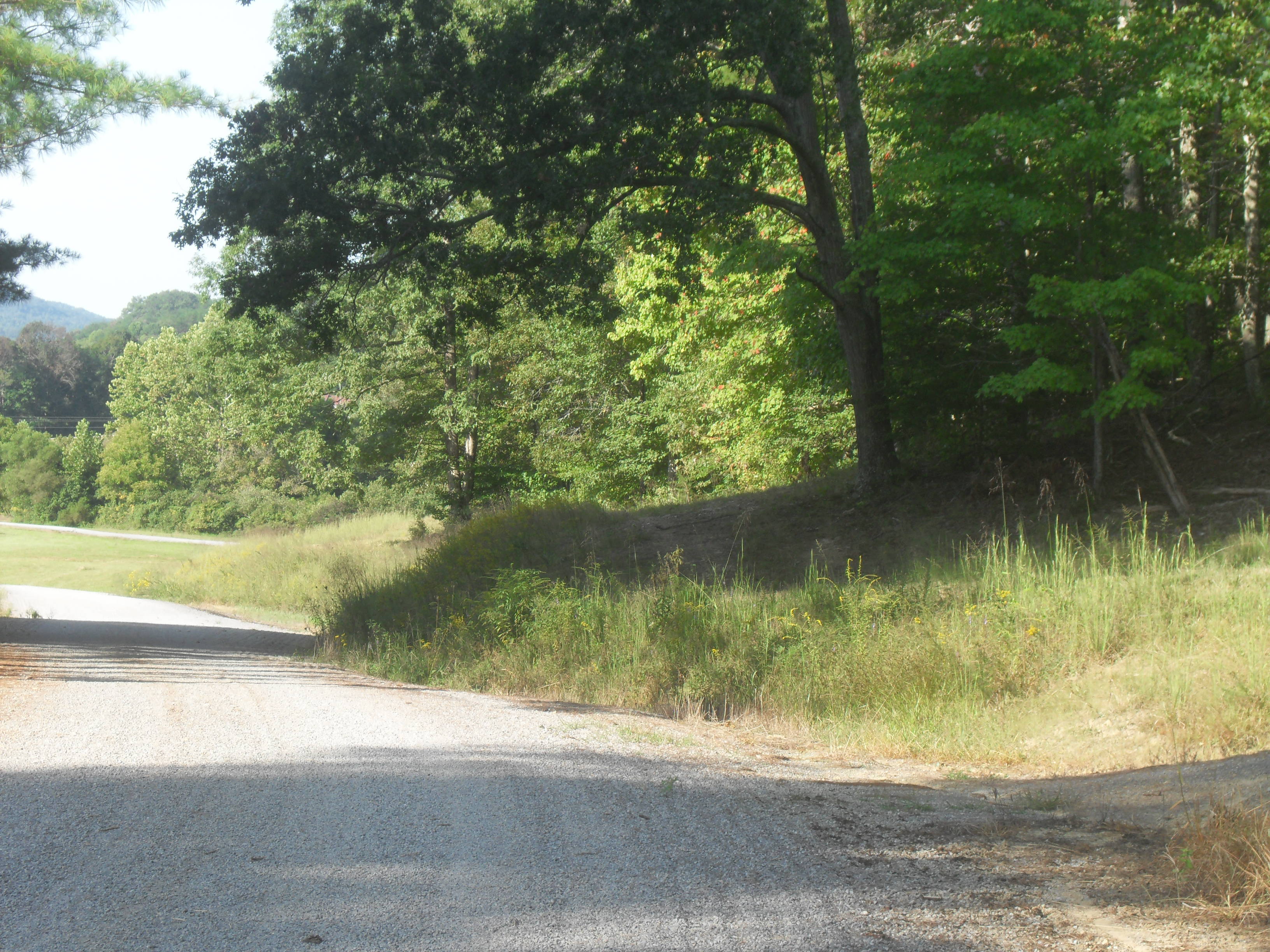

I'll preface this by saying I am a woman who will be attaching this usually by herself.
Husband passed away a few years ago, he had a 83hp Deere and a 15 ft batwing that he attached once a year, as the pto connection was very heavy and a two person hookup. I used this for two years to mow along our stream when it was dry in late summer, and could mow somewhat along the driveway, although he had told me the wings are not really designed to mow "up". I sold the tractor and batwing last year and now just have a Deere 5055e tractor and a heavy duty old bushhog and a finishing mower for flatland. I have been asking around as to what implement I could get to make a pass going out the driveway and mowing up and possibly along the stream(attached pictures, the slope to the stream is steeper than it appears in the pictures). A quick attach was suggested for starters, as I was complaining that sometimes the bushhog can be a real bear to line up and connect. Then a ditch bank mower was suggested, when questioned on ease of connection he said he would not recommend I do it alone.
The quick connect sounds interesting, tho it has been mentioned bushings may be needed for compatibility. The finishing mower already has the bushings. This attachment would not be used much, possibly once or twice a year along the driveway and once a year along some parts of the stream. Right now we have been weedeating and clipping where I have not been able to safely bushhog, which is very time consuming. Any suggestions will be appreciated.View attachment 669412View attachment 669413View attachment 669414View attachment 669415View attachment 669406View attachment 669407View attachment 669409
Pictures are out of order, could not re-arrange.
Looking at your pictures your ground doesn't look bad to work,
just using your existing brush hog most of it could be done.
You do not have to just mow forward with a brush hog.
It does take time but just mowing the width of the mower while backing up or down the grade is quite feasible,
it does take time as you are only getting a few feet width of mowing done each pass.
Also an offset or ditch bank mower would gain you a few feet and provide a stability feeling with the mower on the uphill side.
As far as the quick hitch I am not a big fan of them, does your Deere have the adjustable links on the lifting arms?
If so I prefer those over a quick hitch especially with 3 point implements that use a remove pin in a saddle to connect with the tractor,
rather then the fixed pin type.

Consider a Pat’s easy change system if you do not like the traditional QH style. Which in my experience do not work well with a floating style finish mower.
Ad for mowing your slopes, backing down may be the best option at least on your road, less so on the pond bank as the possibility of the tractor in water or stuck constantly soft soil.
While I realize there can be some variance with the answer to this question, how much distance is there from the top of the slopes to the bottom?
If it requires more than 1 pass to mow, your tip factor may make many options less desirable. I always figure that slope angles are at least 50% greater than they appear in photos when there is nothing to gauge by, thus from my looking at your photos, I would not want to mow with a directly behind me mower mowing beside/along the road.
