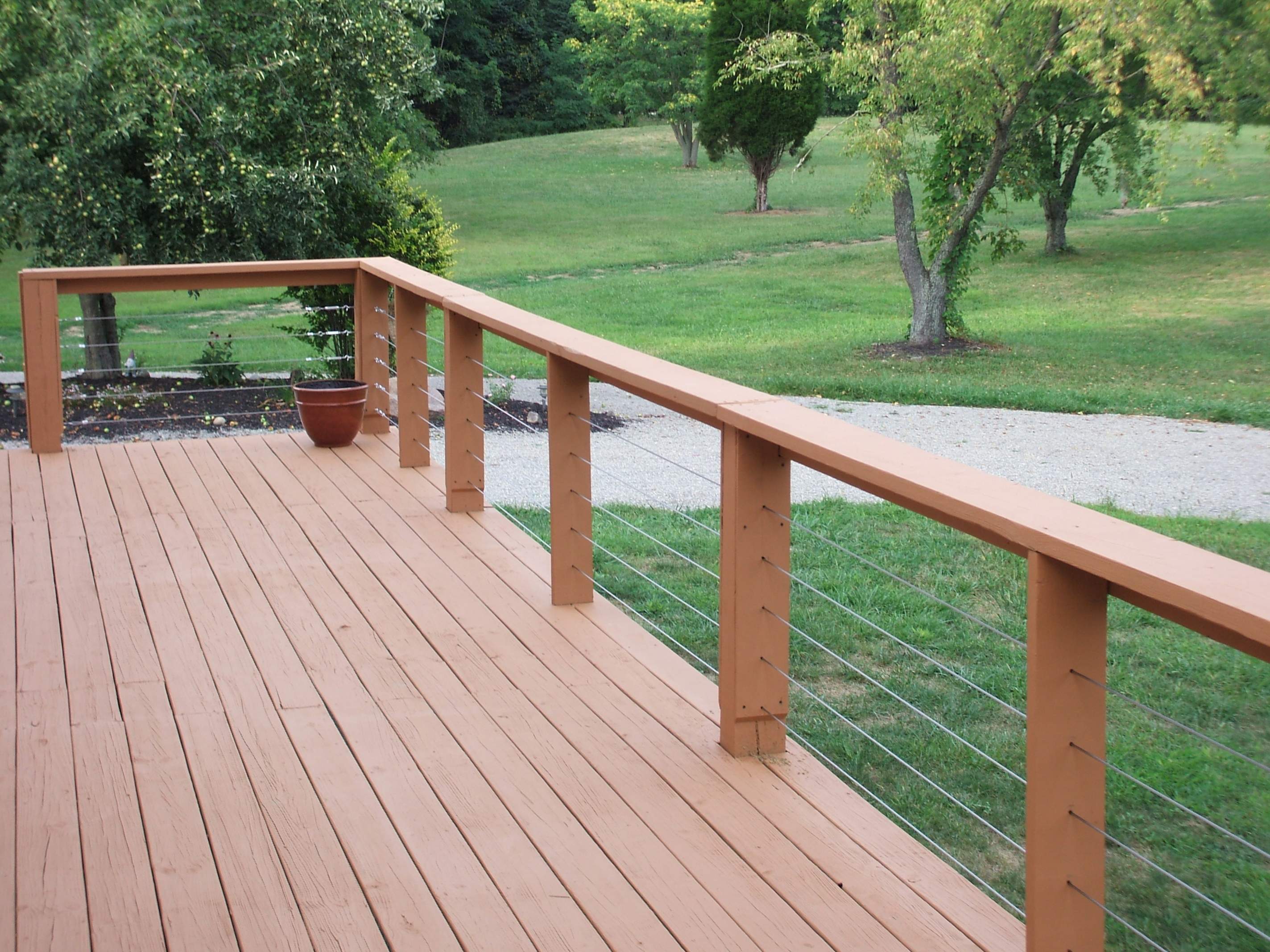

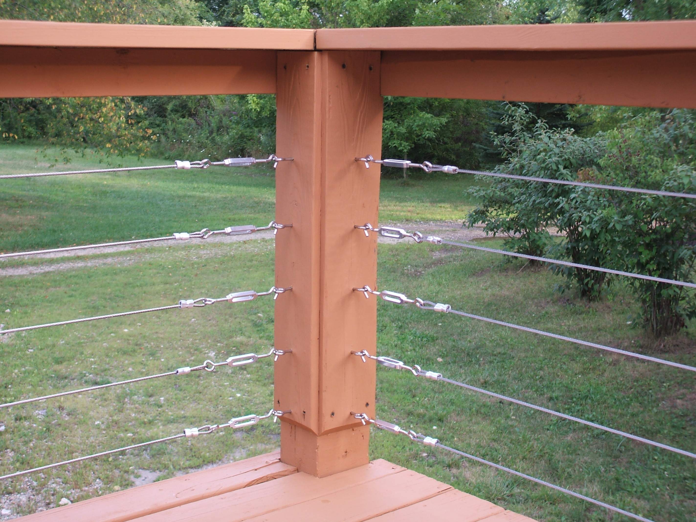

As Eddie mentioned, stainless steel cables are a interesting way to go. I had the same situation as you last summer (replacing wooden deck boards and updating railing) and went with the cables. They sell systems for it, I was quoted about $3k for material, but I just used cable and turnbuckles from the Depot and did it for about $1200.
We wanted something that was safe because the deck is about 12' off the ground on one side but we also wanted an unobstructed view. We like it. Here's a couple of pictures...
I **love** that look with the cables, but as the Reverend said earlier, that one wouldn't survive the Building Inspector here, as it would be too easy for kids (or anyone, for that matter) to get a foothold and climb it and fall over.
