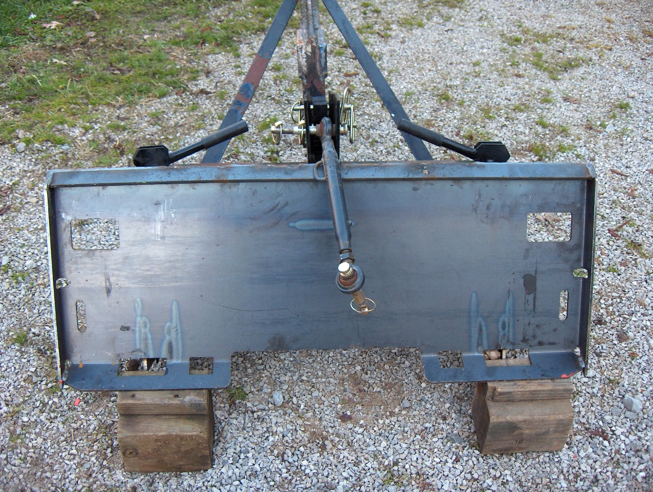

Earlier post had asked for close up pics of the adapter. So here ya go I adapted the Pig pole to it the other day.

Jim...you and I think the same way, I also would like the ability to see thru. Also, some receivers with the ball may have to be cut off or the hole redrilled because of the back plate.
I emailed the folks that Big Bri found on Ebay with a few questions. It weighs about 50 pounds less, (less metal), than the WildKat, but has the cat 2 feature. I think I will still go with the WildKat.
Hi Dave,
It weights about 150lbs. The lower links slide and the holes are cat 2 so you can use cat 1 or cat 2 attachments. The links are 3/4" thick. The slide is 1/4 square with 5/16 plate on top and bottom
Thanks,
Bill
www.skidsteerexpress.com
