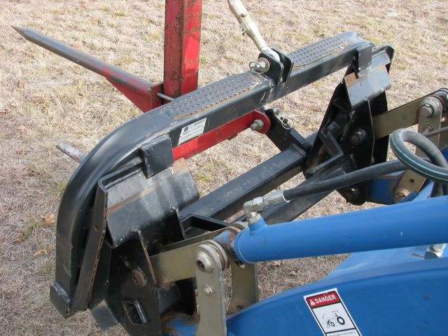

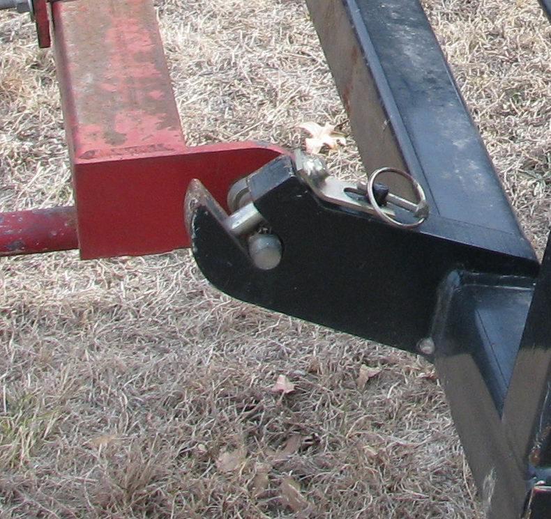

Here is a closeup picture for Redbug.
   / Sub soiler on a FEL #24
Thanks Jim! That's pretty nifty the way they designed the pin to stay in. Thanks for the measurements! I am checking with the NH dealer in Columbia to see if they can still get them.

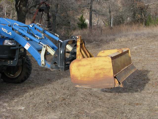

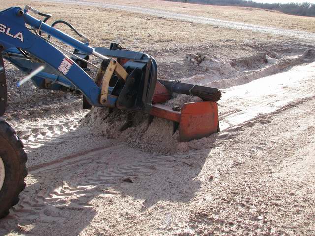

I've included a few pictures of my various implements in non-traditional use.
Very nice, Jim. I know you have posted about 3-pt implements on the
front loader, but that might be the first photo of a BB on the front. I have
not tried that yet with my new 3-pt on the FEL, but I plan to. My rock
rake and boom pole work great up front. If I never have to take my
backhoe off, that would be great.
Thanks Dave. As you can see, the boxblade is like a mini-dozer blade and the ability to scarify and backdrag with downpressure from the loader gives you some real digging power. Unfortunately, you lose the ability to tilt the boxblade. If you had that, you'd have everything going for you.

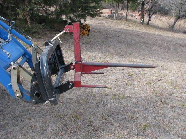

   / Sub soiler on a FEL #33
Hey Big Bri, that one looks like it's a better deal! These things are coming out of the woodwork! I didn't order yet...Yours looks better for the money and it's almost the same thing as what I was looking at with WildKat.
Indeed! There are many very good designs. I like the eBay one with only a couple of minor points. I wish they had shown a rear view so you could see how well the Bobcat quick-tach bracket is made and welded. I think I might want to drill through the toplink square tubing support and add some grade 8 bolts just in case the toplink stress or shock loads might cause twisting and breaking of that weld (probably I'm just paranoid). Finally, both the NH and the Wildkat models have a clear view through the adapter. With the WildKat, you will easily be able to see your trailer ball at any angle. You won't have to do a blind approach to your trailer's hitch.
These are just little things and considerations that may not be that great. I'd bet you could easily cut a viewing port into the eBay adapter and negate the clear view issue. You just have to "take the leap" and get the one you think is best.
#34
dex3361
What is the lifting force of your 3pt? What is the force of the curl cylinder. I believe the curl force is pretty good, and may even be better than the 3pt.
Hey JJ The L4400 HST 3PH at the lift points has a lift capacity of 2870# and the FEL has a lift capacity of 1543# at the bucket center. It has a breakout force of 2530#. I have a question for you. What do you use for pin bushings
on the hydraulic equipment that you have built? I am getting ready to start a grapple and I have thought about schedule 8 black pipe but I would think it would be to soft of material.
#35
I noticed on field testing that this is an issue on the one that i built and I may cut out a center section for ability to see. The wildcat is a plus for being able to see. I wonder how strong it is?
   / Sub soiler on a FEL #36

Earlier post had asked for close up pics of the adapter. So here ya go I adapted the Pig pole to it the other day.

Jim...you and I think the same way, I also would like the ability to see thru. Also, some receivers with the ball may have to be cut off or the hole redrilled because of the back plate.
I emailed the folks that Big Bri found on Ebay with a few questions. It weighs about 50 pounds less, (less metal), than the WildKat, but has the cat 2 feature. I think I will still go with the WildKat.
Hi Dave,
It weights about 150lbs. The lower links slide and the holes are cat 2 so you can use cat 1 or cat 2 attachments. The links are 3/4" thick. The slide is 1/4 square with 5/16 plate on top and bottom
Thanks,
Bill
www.skidsteerexpress.com
