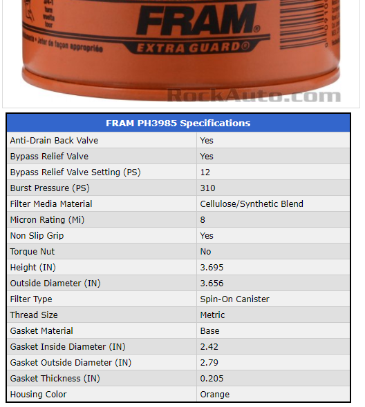

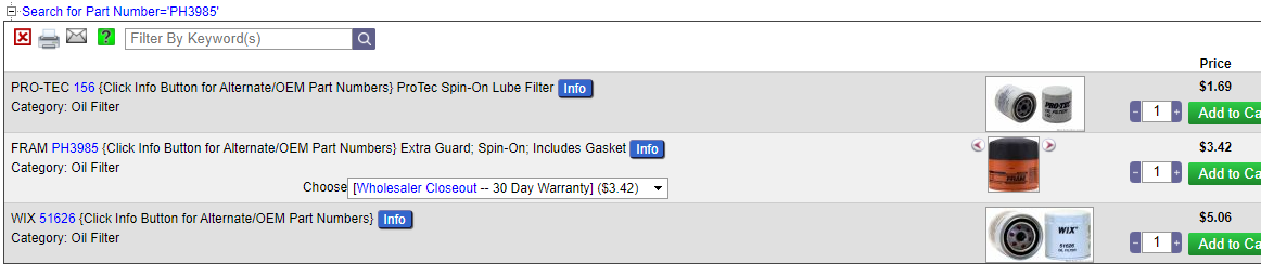

So, going to Rockauto.com let's look at that PH3985 and see how well of a cross reference we get for your
E6201-32443.

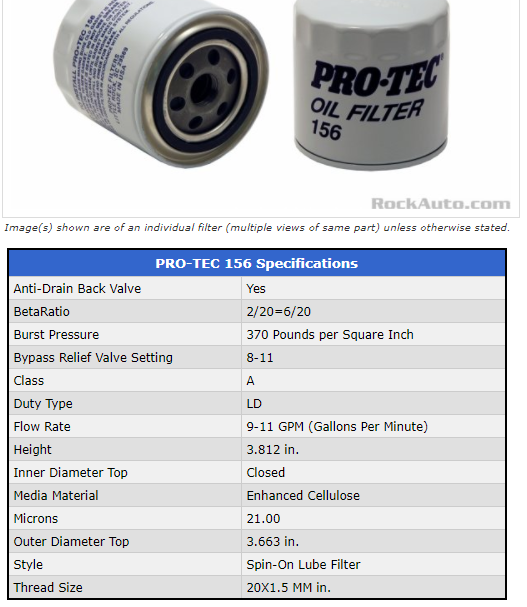

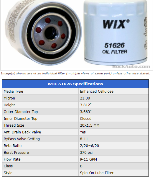

Pro-Tec is owned by WIX. We can look at all of them. Just click on the blue [INFO] icon.
And the WIX
And the WIX rebranded Pro-Tech
With all the details above, the FRAM is a no-no because the micron rating is too fine and the flow will be much slower in the engine. The engine will starve for oil circulation.
The WIX is class-B (Better) and the Pro-Tech Class-A (Best). So, Pro-Tech is your best all around great replacement as the E6201-32443. :)
