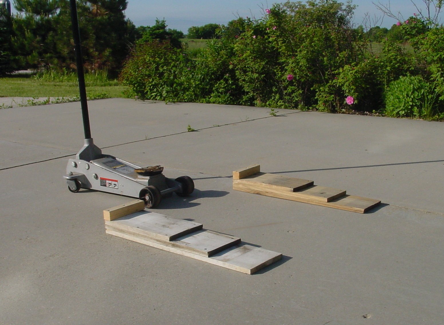

OK, this is pretty stupid but want to make sure I am thinking this through.
Bought myself an Acura TL. Nice car. But a bit low to the ground. Going to change the oil and realize there is no way I can the them up my normal auto ramps. At first I was stumped; jack the car up? Now I am wondering if it makes sense to build a ramp helper (or maybe just full ramps) out of like 2X8 cut and mounted stepped up. The wheels are set pretty far back (or the nose sticks out long) so the 2X is going to be long before the next step comes up. Or is there something else I am not thinking about. No, this car is in LA so no digging a pit.

I ended up having to get a low profile jack from HF for working on our cars, due to their "low-rye-da" body styles.
Once you have the front up a few inches you could position your ramps under the tires, drop the jack and drive up the rest of the way?
On second thought, why bother? Those extensions, that hutchman showed, look like a great solution for all your ramping needs.

I had the same problem with my small car - the floor jack does not fit under the front valance. I just used some scrap wood and built these. I slowly drive up to the third step, roll the floor jack under, lift and set back down on jackstands.
I did something similar, except I just used a concrete block. The front bumper hit the ramps, so I put the block in front of the ramp and it cleared it.

Same problem with my VW. Get some scrap boards, set the incline side of the ramps on one end of the board and have the boards so that the car tire drives onto the other end of board and raises the car up before the front spoiler hits the ramp. Boards only need to be about 3' long

My VW jetta is low. I drive it up on some 2x4's then jack with a HF jack and rest it on jackstands.
