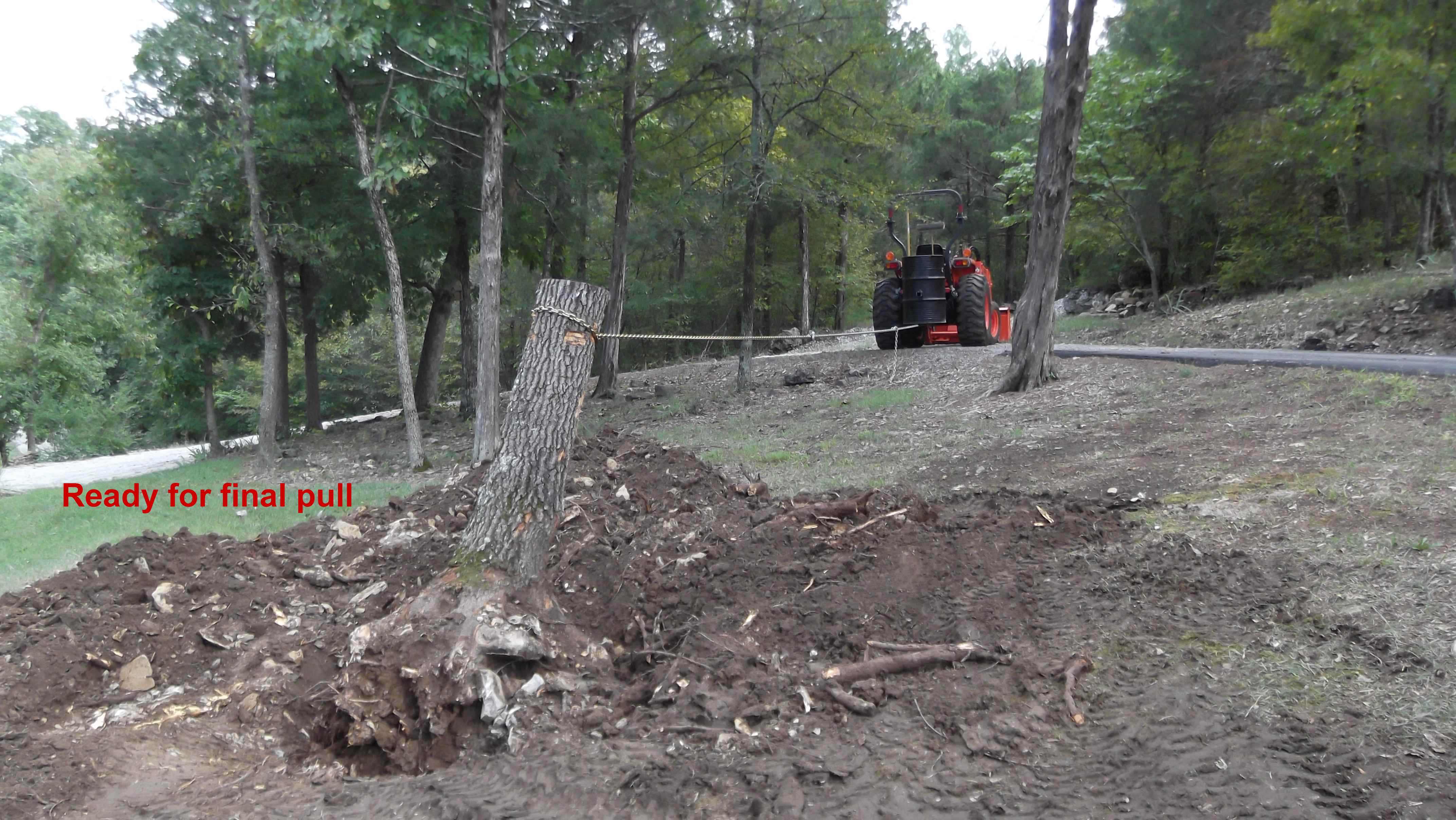

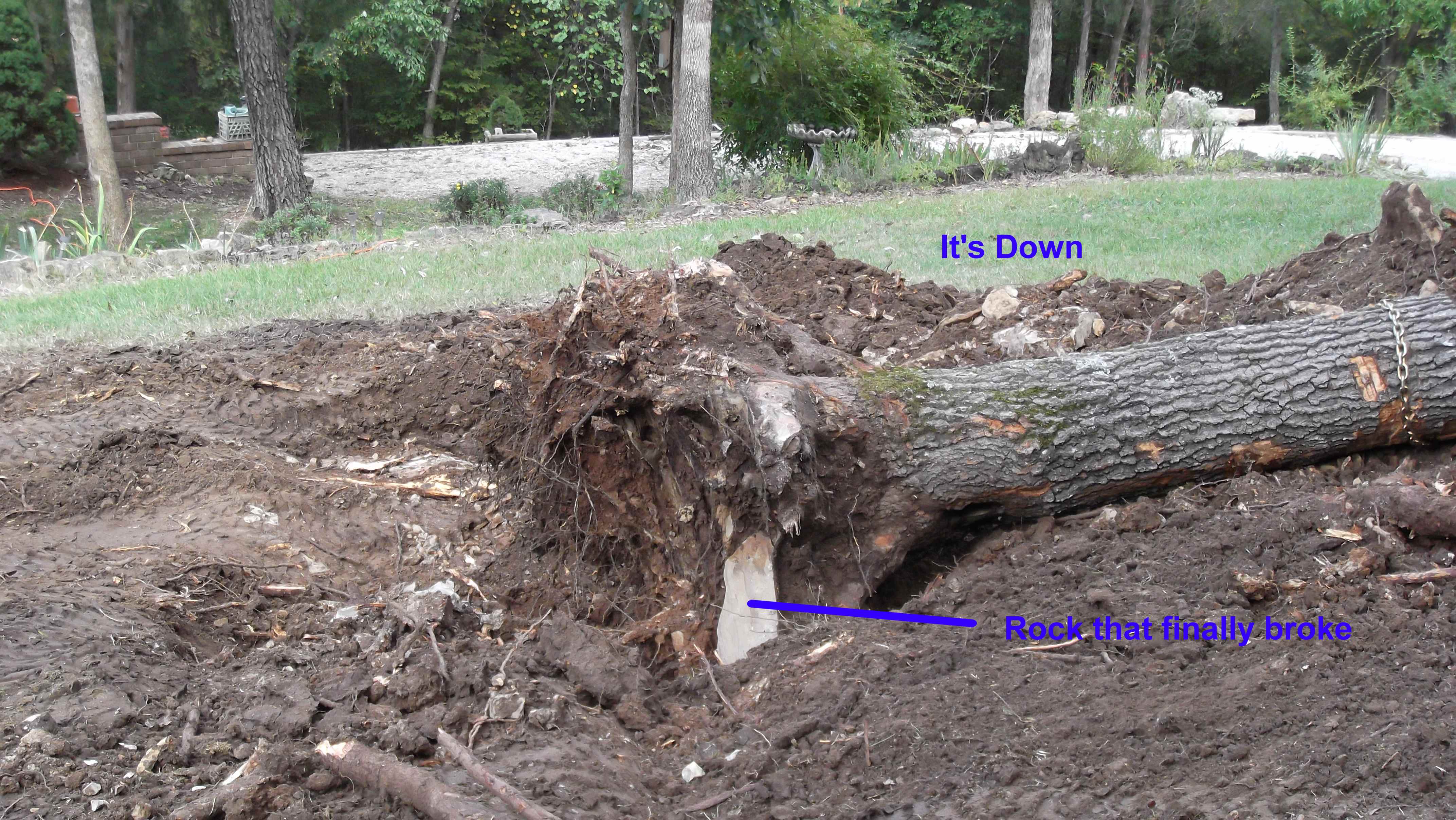

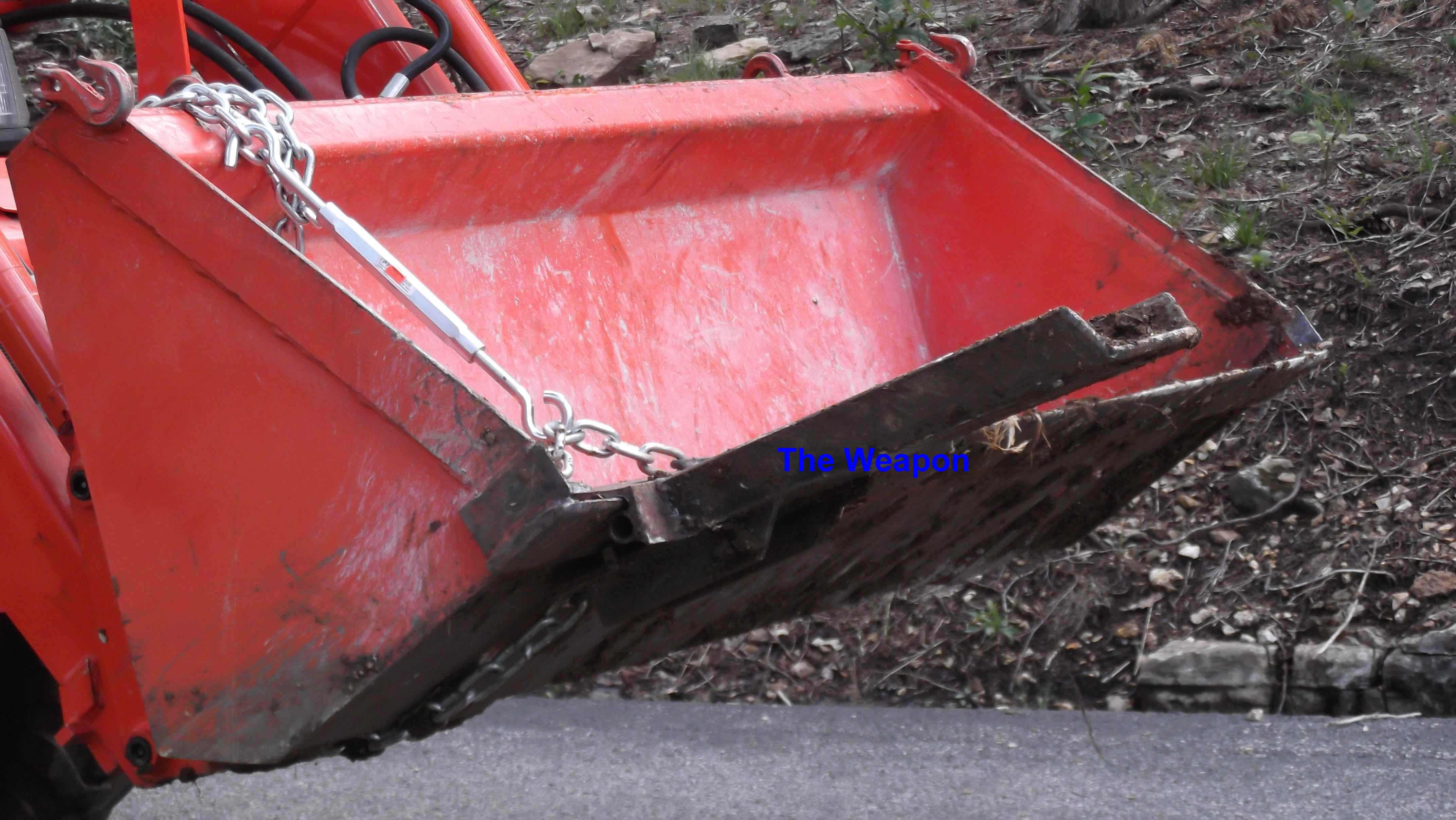

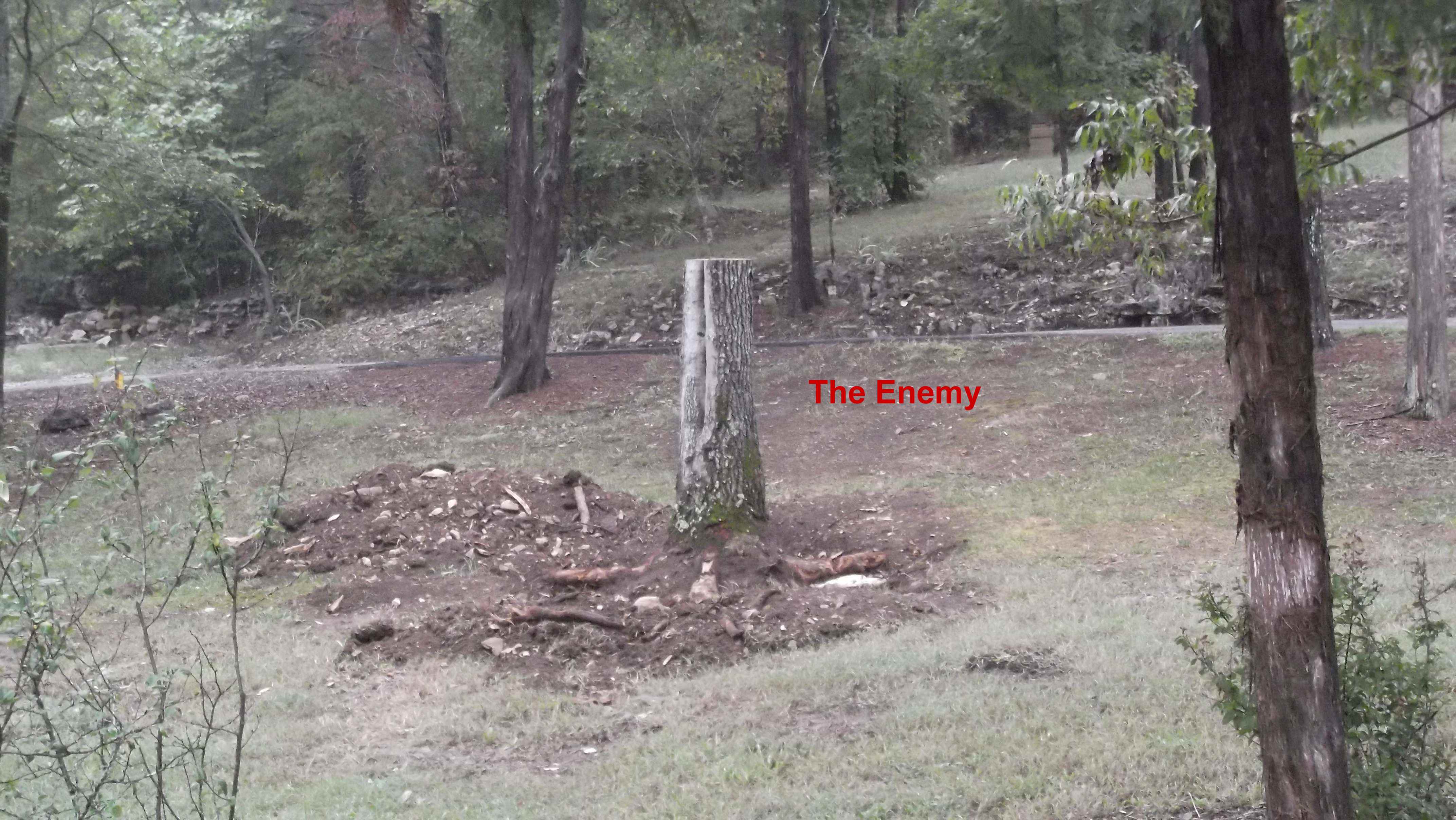

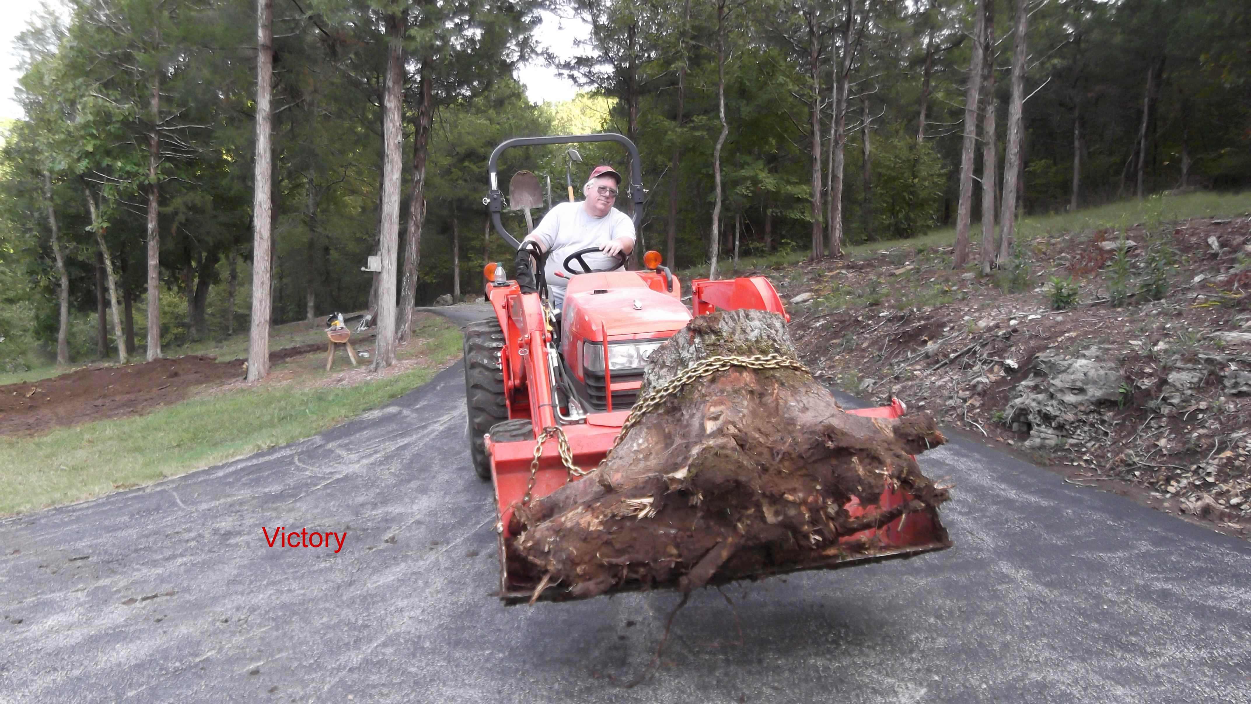

Ok, results were a little different today, I did try jinmans idea of the Carbide drill bit, and I did sever all of the visible roots. (but there were plenty more that were not visible.) I tried to pull again after all the visible roots were cut, and it never budged. So put the home-made bucket shovel back on, and had at it digging for a least 2 or 3 hours non-stop. I kept on digging and popping out roots and rocks so deep the shovel was buried, and the Regular FEL bucket was digging up dirt several inches deep too as I run out of reach on the 18 inch shovel. (bet a shovel for forks would be better as you would not have that problem). Anyway after digging to China, I tried the pull going East again, it never budged. So I move the tractor and went South, This time the huge rock on the West side popped and actually split the rock, The stump started to lean, So I grabbed the camera and the Wife, and the rest is history. I could not have done without my little bucket shovel, It would have defeated me again, but it is just a memory now:thumbsup:
James K0UA

Yeah I didn't want to get "skunked" again, so I stayed at it. By the way the little shovel was invaluable for cleaning off the the embedded rocks in the root-ball, it made short work of that chore. I am going to have to invest in a bigger/better chainsaw than my little 14 inch Mac. I had to cut half way through on one side and then cut from the other side. Of course the little saw is just a "limbing" saw.

WELL DONE James!
Make the Victory picture your avatar for a while is my idea!
