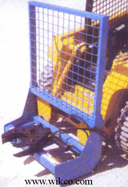

How about a skinny , long tooth grapple. Some thing with 3 or four fingers on the bottom and a few less on top, that way you could pull it out like a dentist pulls a tooth and most of the dirt would stay in the hole after you shake it some

philbuilt said:
How about using some leverage. Think of the claw ona hammer. If you could fab somthing that has a simular shape. Drive into the stump and then lift and drive forward while rolling the stump out. I'll try and draw a picture.
Phil
I hope this helps Perhaps it should be approximatly 30" long and about 12" wide at the end and as wide as you can make it towards the tractor.
I tend to agree with this approach!
Curved, sharpened and tapered (to dig in) probably 24" long or so combined with a clamp or 'overhead thumb' to grip the root mass or 'ball'.
This could be fabricated from a set of forks that would be modified.
Once planted under the root mass the weight of the machine when the forks are 'curled' should cause tear out or extraction.
I base this on the fact that my FEL now has teeth on my bucket and I extract roots easily by simply curling my bucket.
But obviously if I were curved extraction would be even easier (my bucket is flat bottomed)
Whenb I curl my bucket all the roots caught up in my bucket teeth simply 'pop out'.
It is the weight of the tractor mass that does the work!
In my case the bucket is 48" wide so that would be too messy for your purposes but it proves the methodology of operation.
(ps: I will be adding bucket clamping to contain the root mess I do extract)
Good luck!

Perhaps something like this.
