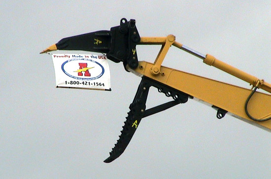

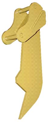

Ironhorse, that was what I was getting at. Not small teeth, but large ones. the front edge of your ripper reminds me of the profile of a hand crosscut woodsaw with two large triangular teeth.
/ Stump puller #42
It took me a while to find Iron Horse's photos as well.
Interesting design for the ripper tooth. I think I would have put an edge on one side of the tooth sticking out. That way as you hook the root and start to pull on it, it would be sliced as it gets pulled into the hook.
I have tooth at the end of mine also, in case I need to pick at the larger roots first. I pick mine up Friday.. Common Friday.

You might also be limited by depth you can get the sub soiler blade down to around a big stump. The ripper on a backhoe allows you to get deep enough to do some serious root damage and only perhaps have to re-position the tractor once to get to all the roots around a big stump. I spent a lot of time on ways to do this without a backhoe over the past 2 years, and for larger stumps, it is pretty much the best tool.
I just bought some steel yesterday to start fabbing a ripper blade for my backhoe. I will post some pics when I get it assembled.

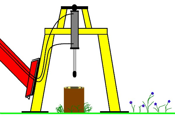

philbuilt said:
How about using some leverage. Think of the claw ona hammer. If you could fab somthing that has a simular shape. Drive into the stump and then lift and drive forward while rolling the stump out. I'll try and draw a picture.
Phil
I like this idea. Except I would suggest you need the "handle" as well as the claw which would let you use leverage to pry the stumps out. Envision a skid steer sized claw hammer stood up on end in front of the machine. Attach a vertical tube (3 x3 or 4x4) the same length as the claw handle (say 4 or 5 ft) to a quick attach plate. Attach the top of this tube and the top of the claw handle together at the top to form a pivot. Push the claw into ground under the stump and then apply bucket dump as you drive the machine backward. Stump will pop like pulling a nail.

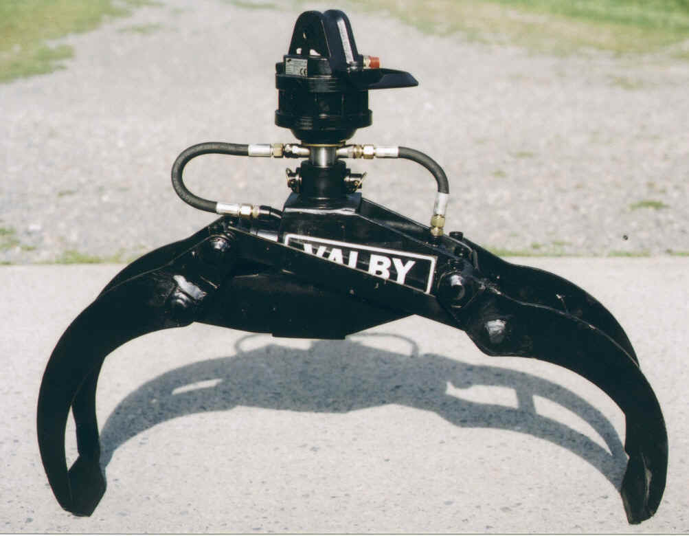

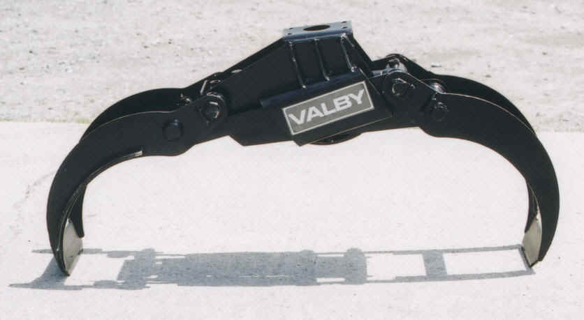

To remove the stump, run the cutter down to about 24" depth, and all the lateral roots will be cut. A tap root going straight down is easily defeated, so you're left with a stump that should be easy to pull out with an ice tong type grapple.
