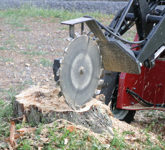

Scotty370,
This is what I have , and it is driven by 12 GPM PTO pump/

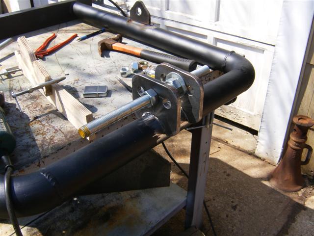

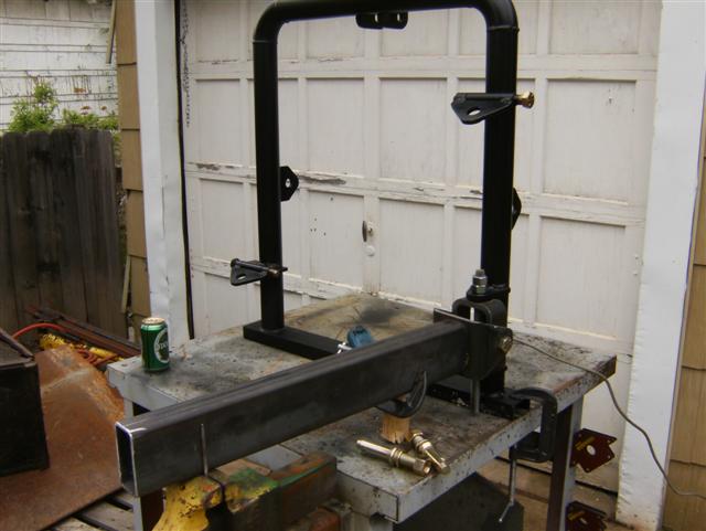

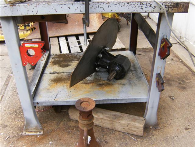

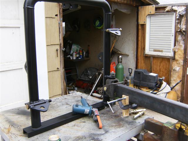

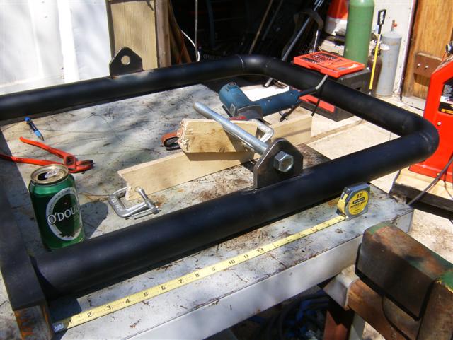

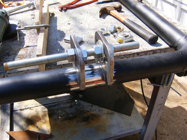

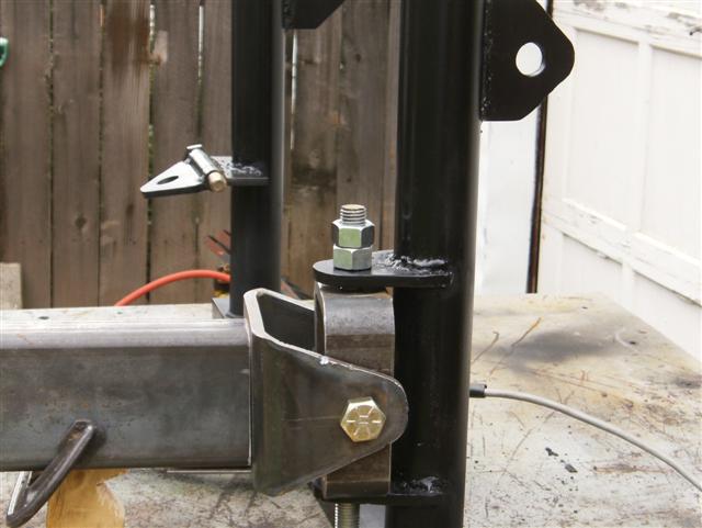

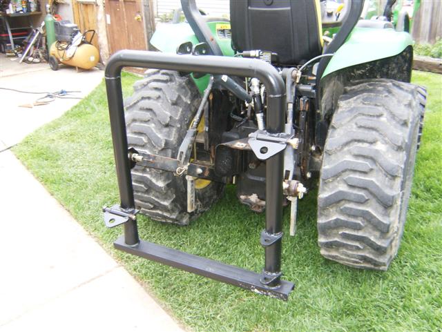

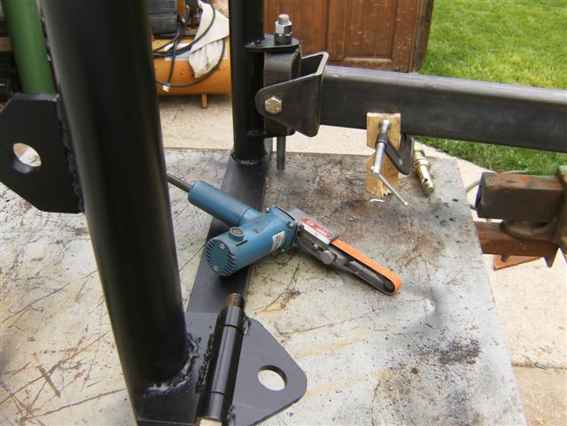

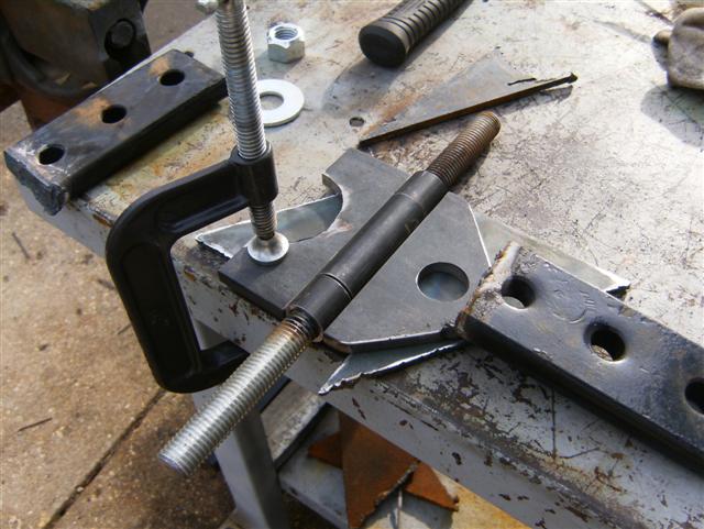

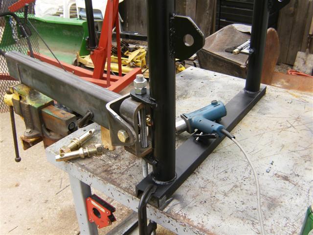

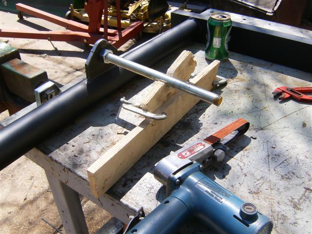

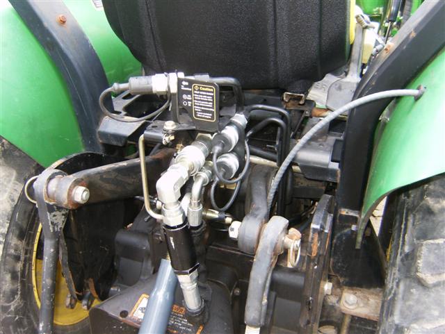

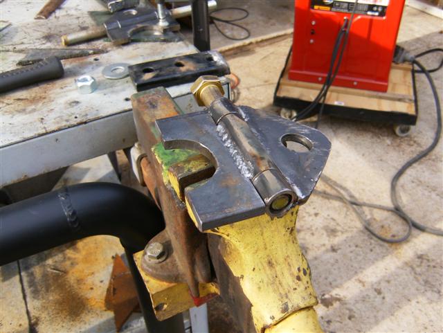

OK- Let's see if I can do this! The frame is finished! Just have to start moving to the rear! Next will be the swing arm and gearbox mounting plate. Ordered rams last night. need them for measurements on this design/build! Picts from top left: 3rd SCV ports installed, which will be my hydro-power. Next 3 are the lift plates and Top link bracket alignment. Next two: Are the hinge fabs for the lift/swing cylinders. The rest are self explainatory. You can see my gearbox, and side plate waiting patiently under the bench for it's day in the sun!! :D. ~"Scotty"

   / Stump Grinder Questions! #63
Scotty370,
Looking Good.
Did you test your gear box to see if it was turning in the right direction. We have been talking about some of the gear box's in another thread, in ref to reverse tine tillers. What rpm will it be turning at 540 PTO speed? The input to your gearbox is going to be counterclockwise, correct.
#64
J-J-Rotation is a funny thing to describe! Looking at my PTO from the back, it rotates clockwise. So, if I were backing up (on the seat!) to the attachment, it would indeed turn the gearbox counterclockwise. This would in turn have the lower wheel cutters, casting the chips to the rear! My 540 PTO, gets stepped up by a 1.47 ratio in the GB, so it'll be about 800 RPM's at the cutter wheel axel. With a 22", (call it 23" wheel w/ cutters), the 'tip' speed comes in at about 4814' per min, or 80' per second! The frame, at least, fits on the Tractor! :D

   / Stump Grinder Questions! #65
Scotty, Is that the direction you want it to turn?
#66
I was have different thoughts on the rotation, but in the final analysis, yeah. I think I want that "stuff" flying rearward! Now I'm rethinking my wheel width! Was going to go with 1/2" plate that I had, but now that I'm buying a piece, I'm toying with going thicker. 3/4" to 1", Purely for the 'inertia', that a heavier wheel would bring to the mix. Thoughts anyone? ~S
   / Stump Grinder Questions! #67
Scotty,
Whatever you have chosen for the teeth, check and see if the bolts are long enough to go through the wheel. You could also flip the gearbox over and it will turn the other way. Two 1/2 in plates could be bolted together for a 1 in wheel. Have you seen those teeth that look like a shallow cup. You can rotate them 4 times for a new cutting surface.
   / Stump Grinder Questions! #68
Scotty,
I tend to agree with you on the thicker wheel. Like you said, there would be more 'inertia'. The extra spinning weight would would be more resistant to bogging down. My thinking is that this would take some of the shock out of the driveline also. If you had a light wheel spinning, it would be easy to stop, so it would tend to cause more shock on the driveline. But when you get a heavier wheel spinning, it will take more effort to stop. This would be a slower, smoother stop.......make sense?
Or am I way out in left field?
Mike
#69
J_J- I think I'm going with Greenteeth: Green Manufacturing Greenteeth Shopping
They can be rotated. Looking at Machine kit for Rayco 1625 Super Jr, or RG1631. I've got some time! Just need 18 or twenty friends to send in for the free sample :D. They also have "Dollar-Day" specials, that maybe would work. Gotta absorb my ram purchase $ out-flow for a couple weeks, then settle on the wheel purchase first! ~Scotty
