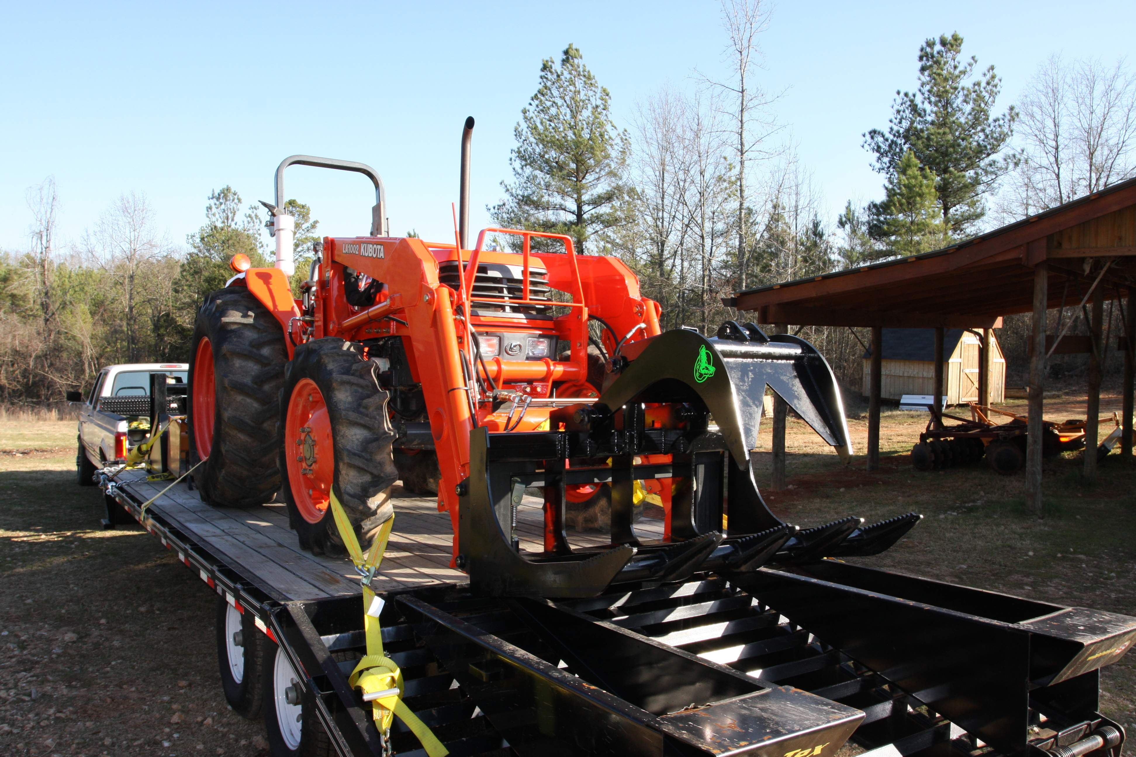

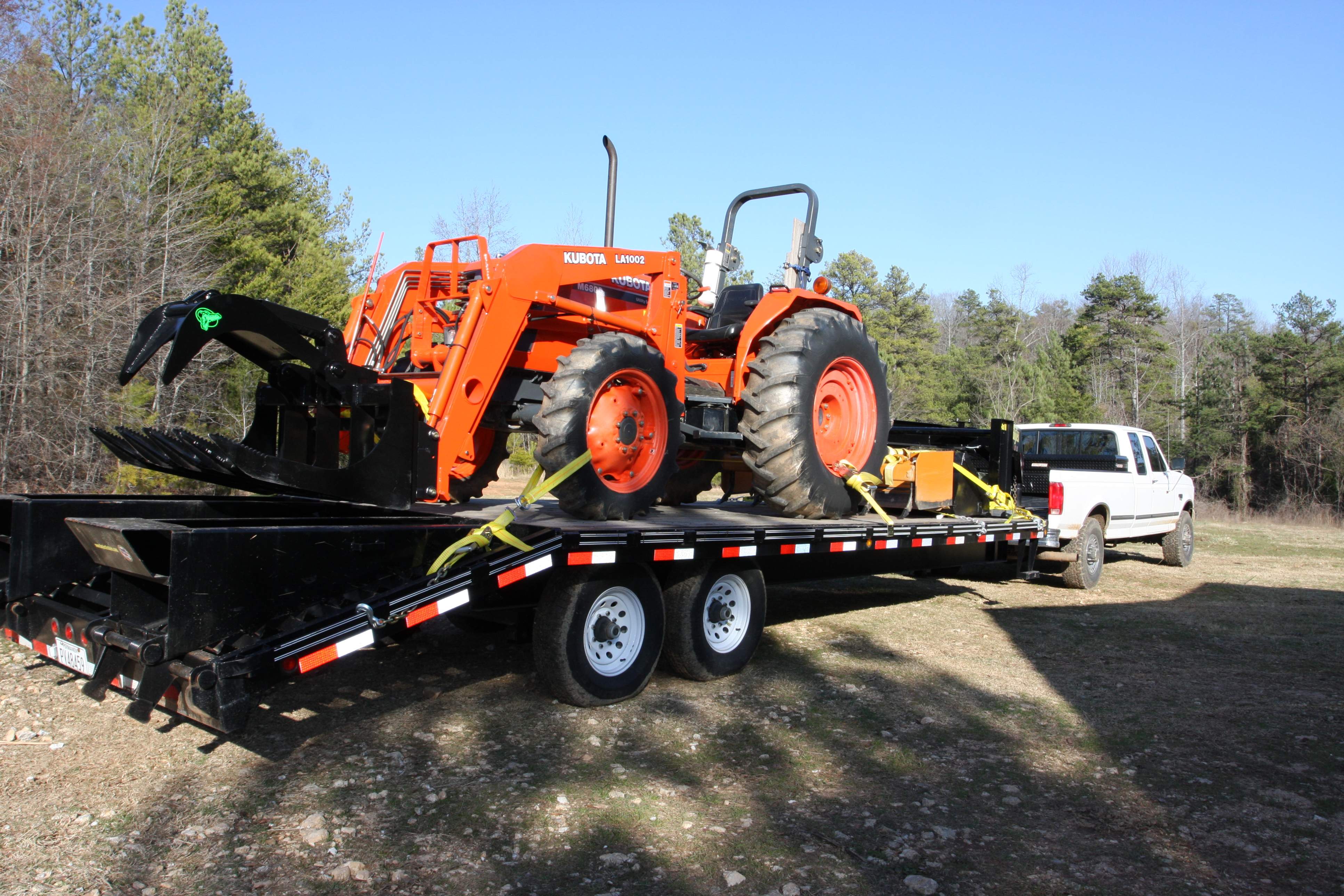

I do lots of what you describe, making new trails, clearing areas, widening roads, digging and uprooting small trees and undergrowth, and then carrying all this debris making piles--lots of them! Have a heavy M 6800 Kubota 70 horse. I have never used a 4 in 1 bucket, but for digging and clearing, I think it would be very poor. Moving debris would be ok. Uprooting trees and clearing land requires the focused pressure of a small width grapple with digging tines. I can push down a 6" tree and pluck the root ball out with my grapple, then pick it up and carry it away. No way could I do that with a wide bladed bucket, even with teeth. Your tractor simply doesn't have the weight or power to use a bucket like it is a dozer, hence the extraction of the root ball has to be more surgical, using a narrow width tines to dig. THis grapple also excells at picking up large rocks, brush, chain saw debris, rail road ties, etc. My favorite implement. Lots of info here on grapple use, made by Markham Welding in N. C. (not sure if they have changed ownership) recently. Mine is a custom heavy duty 1/2 steel version, 48" wide, and cost a little over a grand. Works absolutely great!

By the way, I use mine mostly with a box blade on the rear. As I am clearing and creating holes, I use the box to pull an push dirt into the hole and level things up. It also helps to clean up the mess of small limbs than the grapple may miss. You could use your rear blade the same way. I would like to have a blade as I think it would give me more control of pitch and give me a more finished grade. But for now my box blade is adequate. I maintain miles of trails and dirt roads with this grapple/box blade combination (also create new food plots with it) I have a toothed bucket and it is worthless for work like this. I never use it. My grapple stays on my tractor.

What is the model number of the unit you have I like the looks of it and could you snap some closer pics of it and post so I can see what the tines look like and the hydralics for the clamp? If I dont buy one I will build one
   / Stump Grapple or Grapple Bucket or 4-in-1 ??? #6
Mine was made by Markham Welding and was a custom, but just like their light duty grapple but using heavier 1/2" steel and extra spacers in between the main tines. They would make it any way you wanted it. Does anyone know if Markham is still in business? I know Gatorattachments.com has very similar products. Their website shows what they make. If you do a search here on Markham, you will see lots of info. I can take some more pix this weekend if you wish. For the cost, it was a great bargain. Also look as "Island Tractor" posts. He gave me great advice.
