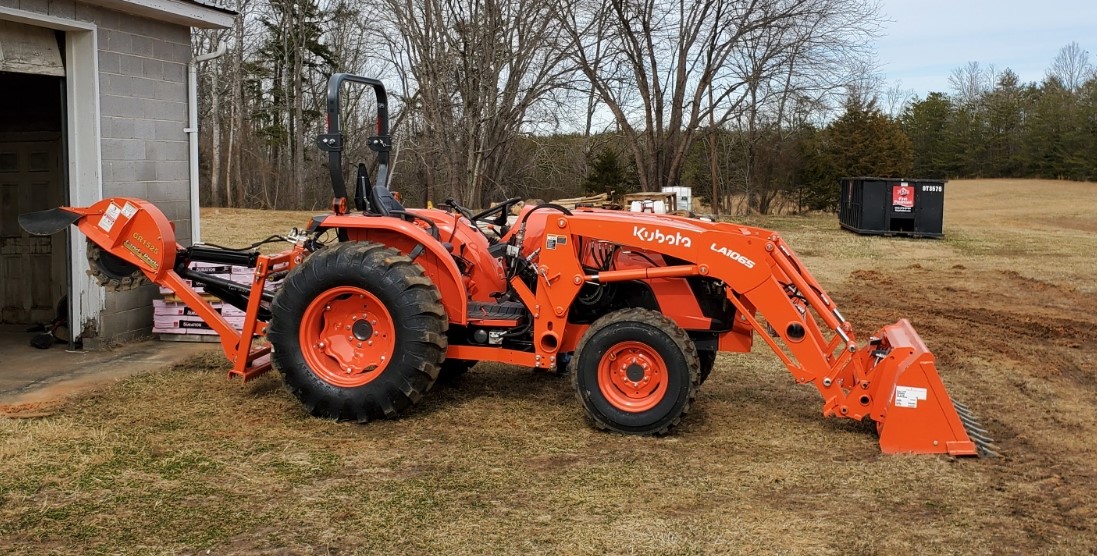

Mr. Steppenwolf, is that a tooth bar on the MX, or a bucket with welded on teeth?
Any chance for a picture of that?
Also, would you be willing to share a rough cost on the LP stump grinder?
I just received a quote for grinding ~20 stumps at $1800.
At ground level, they are from 3 to 6 feet across.
Surely we can turn it into a DIY project!!!
/ Stump Chipper #66
It's a tooth bar... I believe a Titan, 380 bucks installed. ( 72" Bucket 23TF Tooth Bar) . The stump grinder was 5k... and was a year old model, the new are supposed to be 6K. :confused2: I have about 120 acres of woods and wanted it for obvious reasons. It sure does work good.

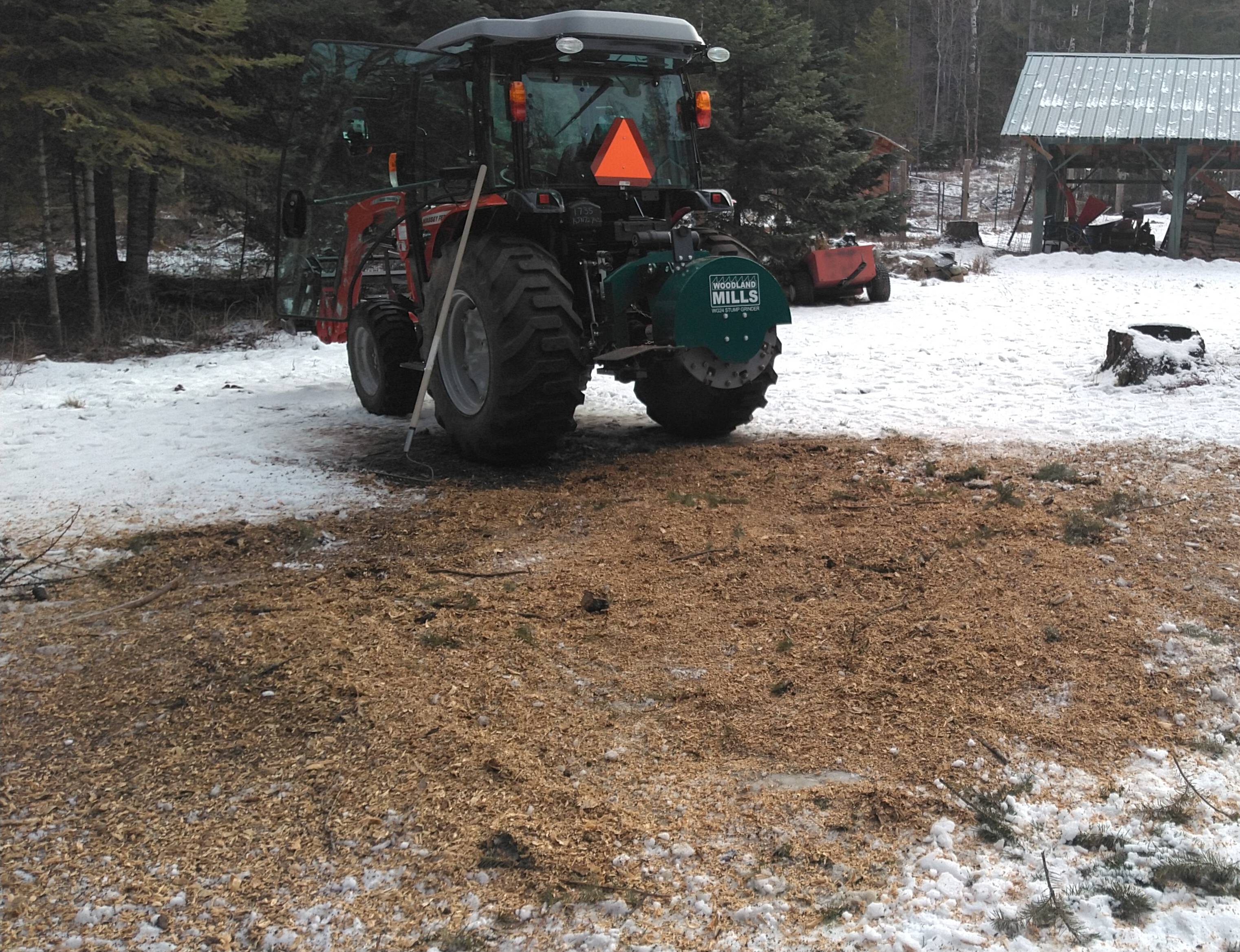

wound up buying the woodland mills WG24, it was delivered Monday, a week from order to delivery.
Been eating up stumps for 3 days now, it works well. Figured I'd lube it up this morning, and damn zerk broke clean off when I removed the grease gun on the bearing closest to the PTO. That was a 4 hour delay to get the old one out, and a trip to town to get a replacement from TSC. Be careful with that one. It's an M6x1.0 zerk.
