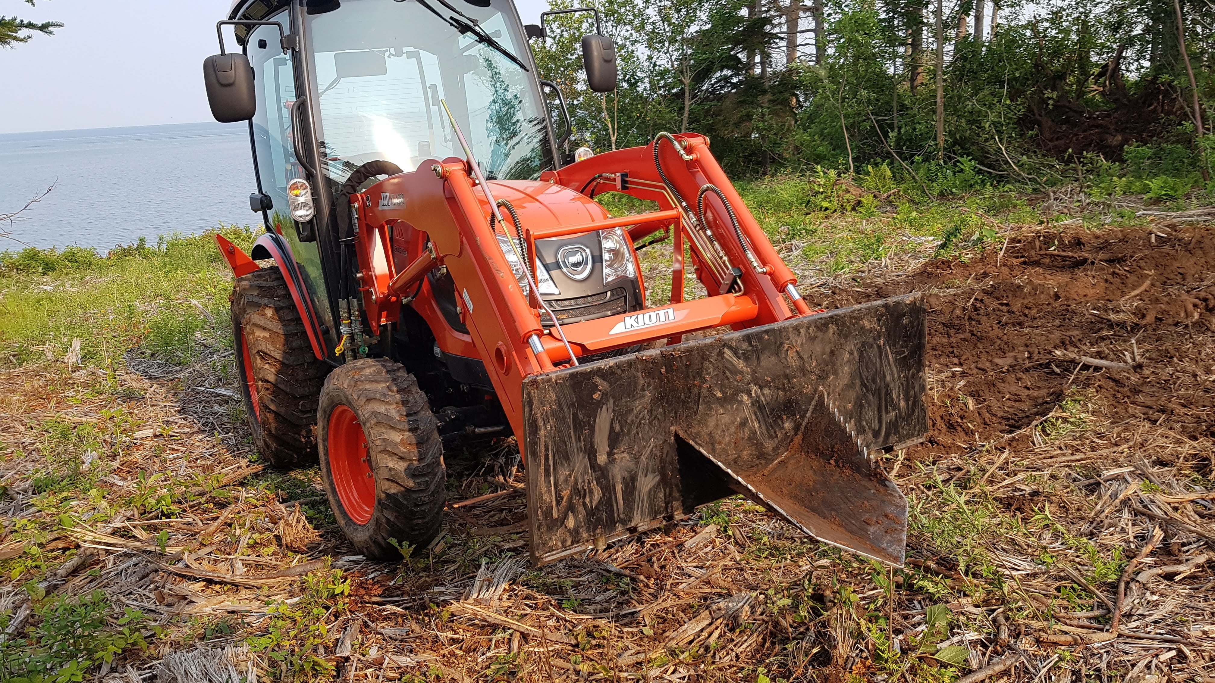

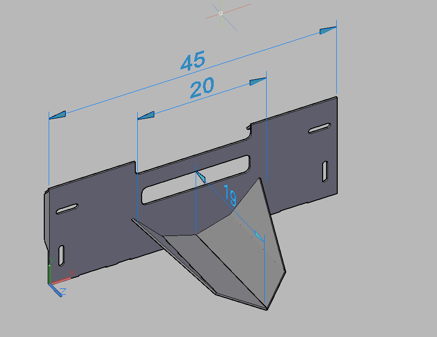

Keep in mind a stump bucket on a compact tractor is useful for stumps under about 8" I had a CK 4010 and I designed this bucket and find it very useful, but I kept it shorter than most so I could keep maximum force close to the pivot pins (the further out you go the less effective force you can exert) Mind you I did get this big stump out with it very easy but it was cut a year before I tried it. This one works great,Hope this helps.

The idea of the long stump bucket is that you can "lever" out the stump by pivoting on the far (pointy) end. I think you have the right idea with the pointy front end. My (almost useless) Titan bucket has a wide, flat front (but with teeth) and I can barely penetrate the earth with it.

I just came across your bucket design. It looks like something I would like to build. Can you give me some specifics about your bucket?
Size of plates? Length and thickness, kind of steel used.
Thank you,
Jim
Jim,
Here are the dimensions, the plate is a quick attach 1/4" I think, all the steel is roughly 1/4". It was cut out on a CNC Plasma machine and the sections were welded together, the teeth are pointing backwards to cut roots as you stab and pull back on the root. It really works great however I recently bought a 40hp heavier lift tractor and did bend it a bit, not too bad but I had to add some bracing at about 5 and 7 o'clockif you in front looking back on the tractor.Hope this helps

Your bucket looks good. Thank you for the information. I am going to build one. I have a little different idea.
