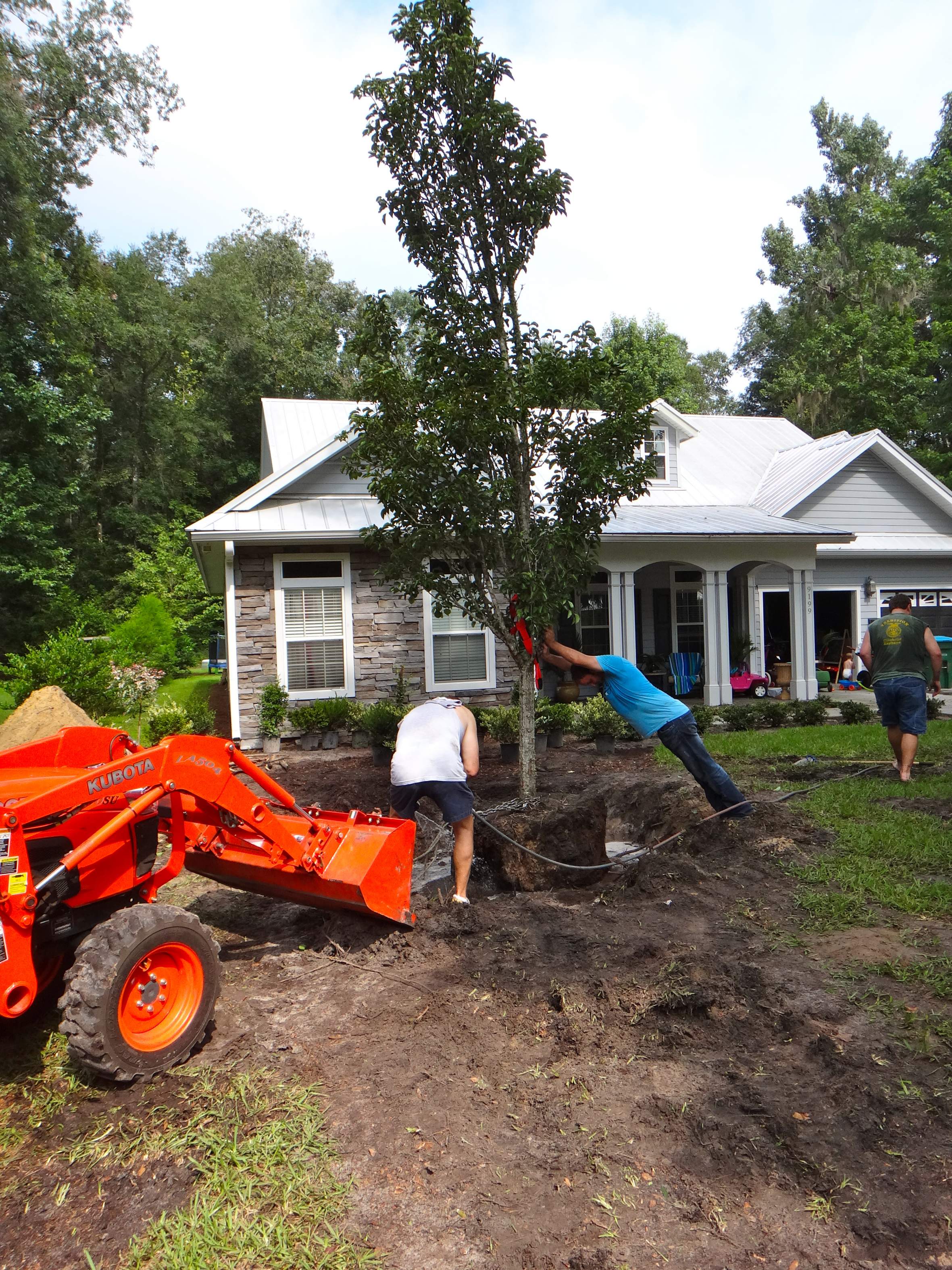

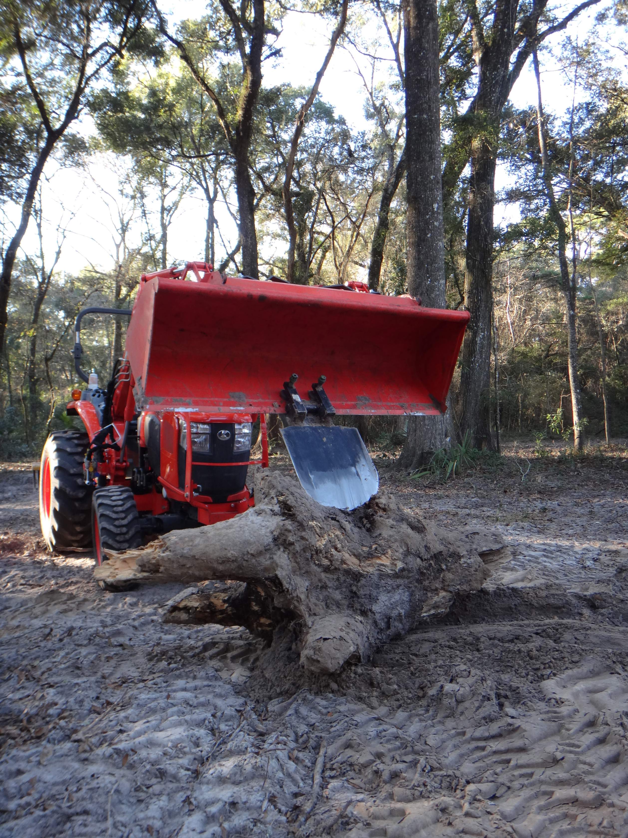

Two issues: A heavy Bucket Spade will penetrate tough soil and softwood tree roots better than a light Bucket Spade. Tractor motive power can then thrust a weight-set Bucket Spade deeper, but Bucket Spade weight is key. I do not know the weight of a Paumco, but a Bucket Solutions Bucket Spade weight 110 pounds. In years of use I have never deformed it and it seems as sharp as the day it arrived, used in rock-free, Florida sandy-loam.
A Bucket Spade must be used prudently on a light bucket. I first mounted mine on the bucket of my Kubota 'B' 3300SU and used it PRUDENTLY for two years without more bucket damage than scuffed paint. Now it is mounted on Kubota's optional L2296 Heavy-Duty, Round-Back bucket, on my heavy L3560, which makes an rigid unit requiring less prudence. The BS/BS has clamps to attach it to either an FEL bucket or pallet forks.
Be aware that tractors are primarily designed to PULL. Skid Steers are primarily designed to PUSH. So a skid steer mounted Bucket Spade is going to work more effectively than the same unit mounted on a tractor.
