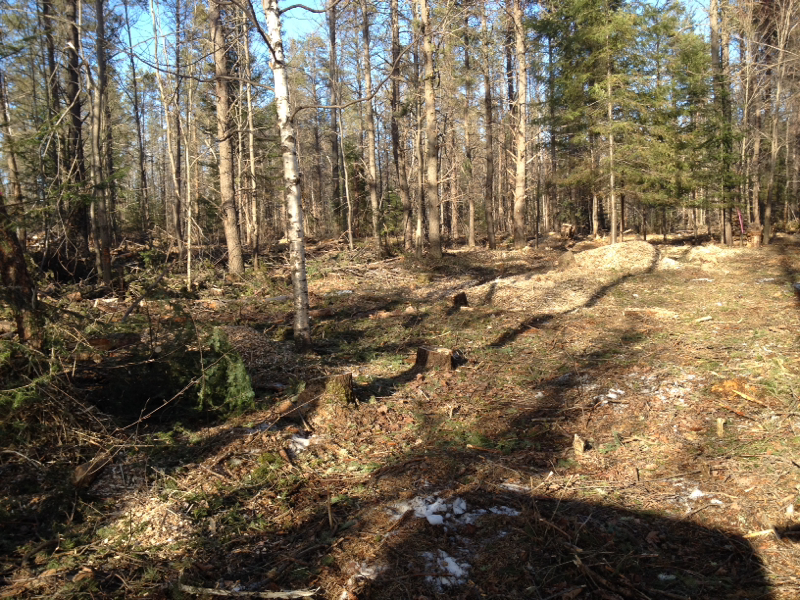

Need some opinions/experience with stump and sapling removal. I have a JD 4610 with a 460 FEL. I recently had a 10 acre pine plantation thinned. It was the second thinning. The trees are about 22 years old. Sizes vary from 10" to 24" stumps. There are also a lot of saplings that were bent or broken during the cut by the loggers. My goal is to creat a "park affect" where the remaing timber can grow and we can still have an aesthetic appeal to the land. In order to do that I need to remove stumps so I can bushog between the trees (As soon as the light reaches the ground the brush is going to take over). Also the damaged saplings are not going to recover, many of them are laying flat with the root ball still intact.

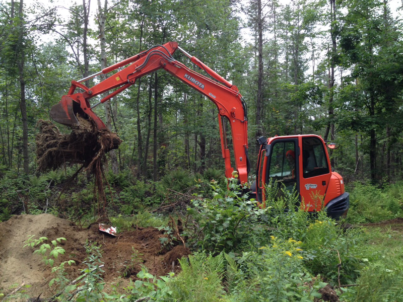

For stumps that size and the area I would rent a mini excavator to dig them all up, or have a small dozer come in to push them all out. Then take a root grapple to gather them and Haul to a burn pit or pile. One thing about a stump bucket on a loader is it's hard to see what your doing.

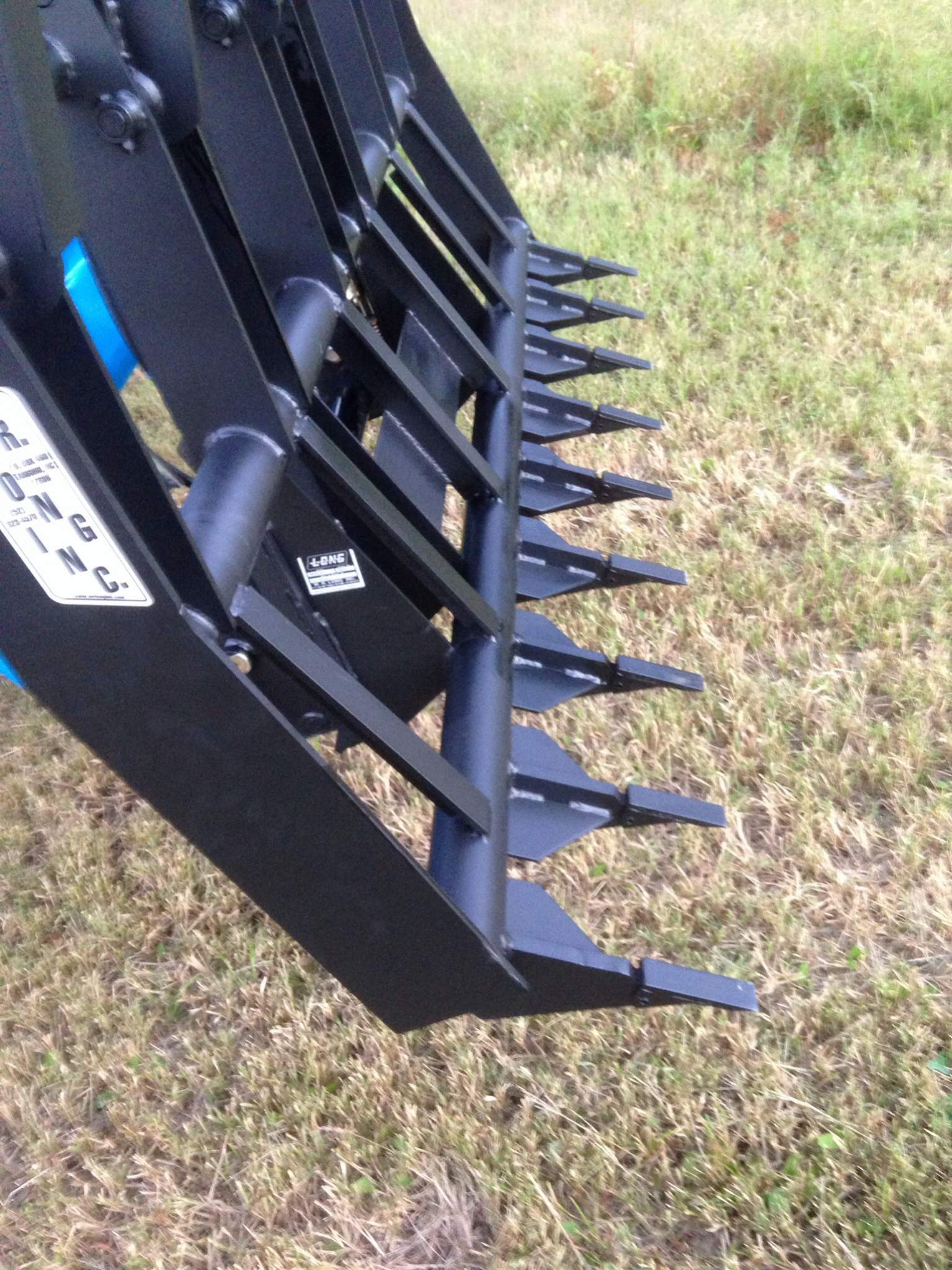

Oh, and a Piranha Tooth Bar will work great on saplings. I was using mine today and was really giving some cedar saplings the blues.

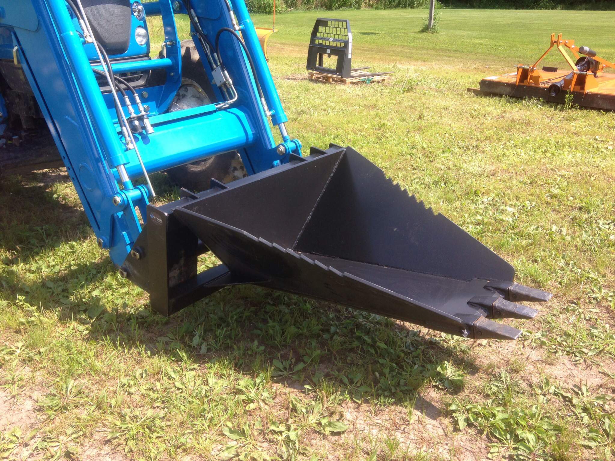

1) I have the Titan stump bucket and if you search on here I posted a video of digging up a 12" pine stump and I like it a lot. And yes I just installed a front camera because without it I couldn't see anything. It's proved real handy for digging out all sorts of things, even holes for new trees!
That said I think it would be a little much for your tractor/loader combo for what you described. I have a 88 hp, 10,000 lb tractor with a 3500 lb lift and could dig out a 24" stump but wouldn't want to do a lot of them. IMHO on your size tractor you would be much further ahead renting the backhoe for those larger trees. (If you see a good deal on one you might grab it up, they are good thing to have. Remember this is advice from a guy who wants to own one of every attachment before he dies!)

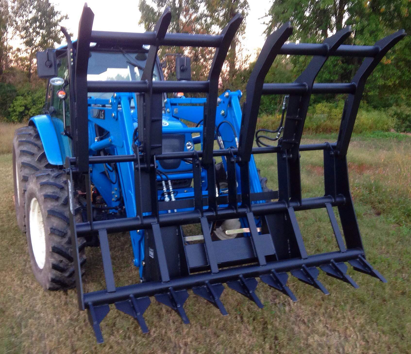

2) For uprooting saplings, brush, briars etc I don't think you can beat the root grapple with spade type lowers with replaceable teeth. They have the widest cutting/shearing/digging area and you can replace/change tooth design. I have the WR Long but there are LOTS of people who like their grapple the best.

I have a loflin stunp bucket. It is a true stump bucket. 60+ inches long and curved like a curve hammer claw to leverage out stumps. It is an awesome tool however is rough on equipment. I use it on a s250 skidsteer. It would put an extreme amount of pressure on the front of the tractor. I had to learn how to use it smoothly. As you leverage up, the back of the machine comes off the ground. I had to learn not to let it get but a couple inches up because when the roots break, it goes down hard. But this is the design. So once the weight of the machine has been leveraged, no need in going any further. It is hard work even then. Not something I would let anyone use my machine for. But way better than a small backhoe. I have dug out 36 inch oak stumps. Some of the harder ones have not been as large but rather have lots of side roots.

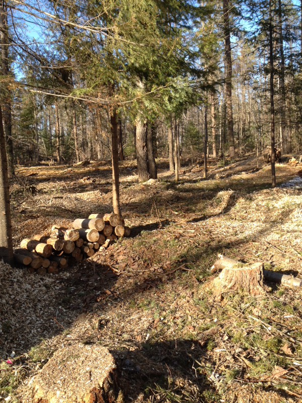

I am working on a similar project and ripping out stumps with a excavator might seem all nice but it's not you end up with a bunch of stumps and the worst part is you are doing root damage...,more dead trees I just cut them flush with the chain saw and chipper/burn the branches
The excavator does to much damage the best way is hand labour or a forestry mulcher

Northern quebec near mont laurier all I can say is digging is not a good method

A couple years ago I purchased a stump bucket(one of my worst purchases),impossible to see what you are doing.Sold to a fellow with a skid-steer.
It's one of those things that looks like a good idea but really isn't.Rent a back hoe or mini-ex.

get a dozer to push them out. One or 2 pushes per stump and it is over. Do it all in a couple days.
Or spend weeks digging them out with an excavator.
