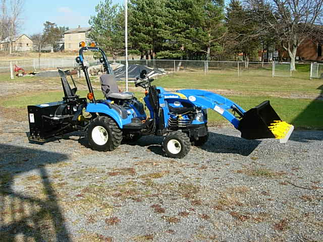

I've been through several blizzards so far with the 4 wd machine and no need for extra traction. Loaded rear R4s and 8 ply R4 fronts.
The new chains I bought for the tractor have been in the box for years now.
