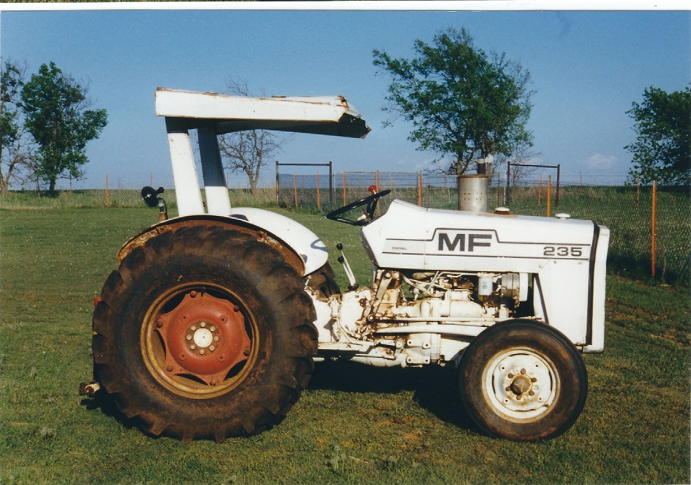

Why are you concerned with tire diameter on a 2WD tractor?
I had one that I put larger diameter rear tires on:
