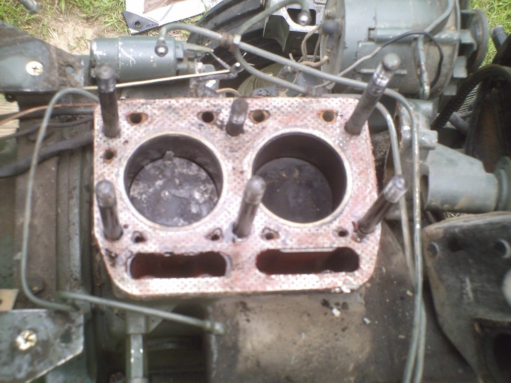

Thanks for your help. I f I understand you correctly with your first suggestion is to use a 1" think piece of stock at the top to sit on top of the head bolts and cut a corresponding piece for the bottom of the cylinder with a groove to allow it to slip slightly up into the cylinder. I suppose that I could use my angle grinder or Dremel tool to make the groove. I guess I am a little concerned about potentially bending the head bolts. The last contraption that I built i just used a stack of 4 1/4# peices of stock set them on top of the block next to the head bolts. I then placed the cross piece on top of those stacks and started tightening it. I guess I was hoping that once the liners break loose I would be able to grab them and pull them out.
The square piece at the top will not work on this tractor because it is a 2 cylinder and the middle head bolt on the port side is shorter than the others. (see pic)
I guess I will have to look for some 1" stock now that would be the cheapest option
OR
I found a 90 amp flux wire welder on sale at Harbor Freight for $118 (reg 199). I wonder if it would be sufficient to remove the liners.(I used to have a Lincoln AC/DC buzz box years ago when I owned a steel hull boat something always needed welding on that beast) and I think I could still run a few beads up the liner.

I used a 1/2" thick piece of plate steel on top of the head bolts, with a 5/8 inch hole to allow althread to go thru plate down to the piece I used to pull liners.
In your situation since you have one short head bolt I would get a plate that is approx the same dimensions at your head and bore 2 holes. Because of the longer span of plate I would use 1 inch there too.
Just so you know I was supprised at how easy the 1/2 inch stock bent. Once I got the "T" in place it did not bend and I was supprised at how EASY the liners came out.
Be advised I had to drill 2ea 5/8" holes in the lower piece, and router out the metal between two to make an oblong hole. This was so I could angle steel on althread bolt as I lowered it thru cylinder and once at bottem I just leveled out the steel and it hooked to bottom of liner.
