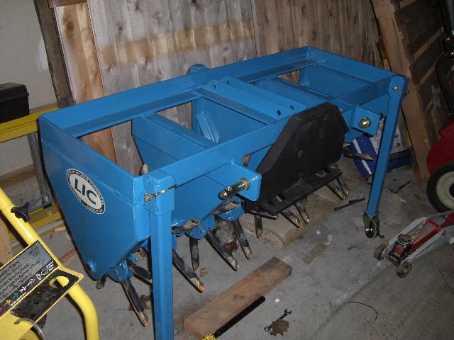

I don't have the PT version (the $1600 for the attachment plus shipping was $660 for shipping was a big turn-off), but do have a 3 pt land pride aerator that I put a quick attach plate on, and it works great. The PT version looks like it would work just as well.
This was much cheaper ($500 IIRC):

That looks like a pretty heavy unit and a good idea to attach the QA plate to it. Are you able to apply down pressure with the PT for deeper plugs if need be?
/ Strongly considering getting a PT425 #6
Sure you can add down weight, but you should be careful how deep you want the spikes to go.
Don't go beyond the eject plug slot.
