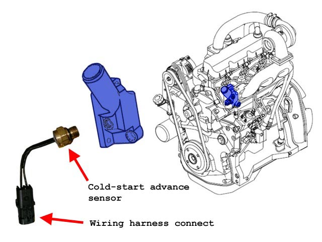

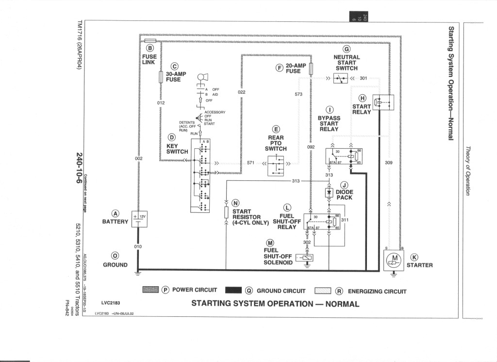

Not saying this is the problem, but I would try and disconnect the cold start advance temp sensor.
Also do your test with a test light. I worked on a 4230 awhile back and the circuit showed 12volts with a meter, but when I put a test light on it, I got nothing. The problem turned out to be a bad connection.
Do not if the 5400 and the 5210 have the same starting system, but I have included a diagram.

WHAT inj. pump is on this machine?? is it the 5400 we're diagnosing?? That has a Delphi fuel system on it & that has a 1 wire solenoid..
If your talking about a Stanadyne inj. pump, that has a 2 wire solenoid & they have a MAJOR PROBLEM w/ the temp sensor shorting out, blowing the start circuit FUSE..
UNPLUG the cold start devise/sensor at the thermo neck & replace the fuse to get started.. then replace the sensor..
Thank you very much for the advice. I did have a problem with this in the past and disconnecting it did fix it. Right now, I'm pretty sure I must have a poor connection somewhere and I've been tracking them down and cleaning them up but haven't found it yet.
